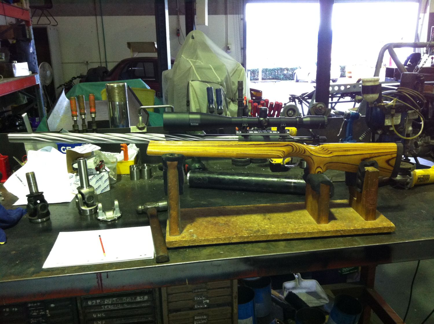

    G'day Robin,
    Pine can look really nice, here is a pic of a scratch built gun with a pine stock, the barrel looks rather smick too.
    The guy who made it lives in Brissie and was involved with Metal Storm making the early prototypes

    Dave that stock is awesome!

    @Dave.K
    That sure is a nice piece of pine in that rifle. Not into guns myself, but that is an awesome looking weapon.

    Gday Robin,
    I'm not into guns either but seen in the flesh that is a work of art and incredibly heavy it is.22 calibre so the barrel wall is around 8mm, the stock is made from one of the thick support beams in a pallet which was ply

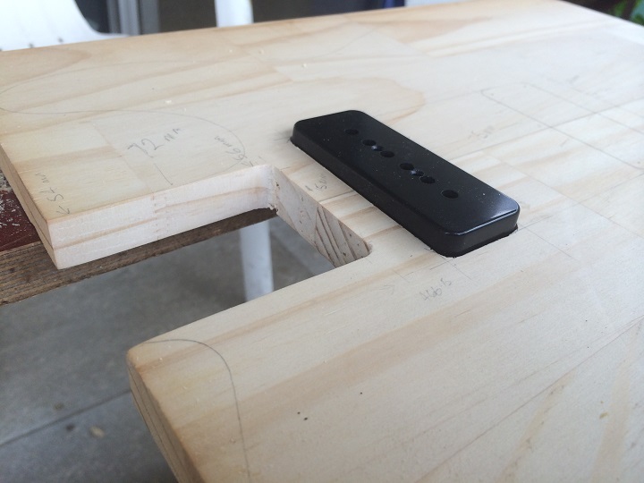

    Pup cavities finished.
    Now to cut out the body shape on all three “layers”. I was not too sure whether to rough cut the shape with a Tenon saw and then trim it up with a rasp or use a coping saw. I decided to go with the first option. That didn’t work out too well as cutting lots of straight line left a mountain of rasping, which was a lot harder than I expected. So the remaining pine and plywood layers were cut with a coping saw. It took 2 hours with the coping saw and by the time I had finished I could hardly hold the saw properly. But at least it was a bit more accurate than the tenon saw.

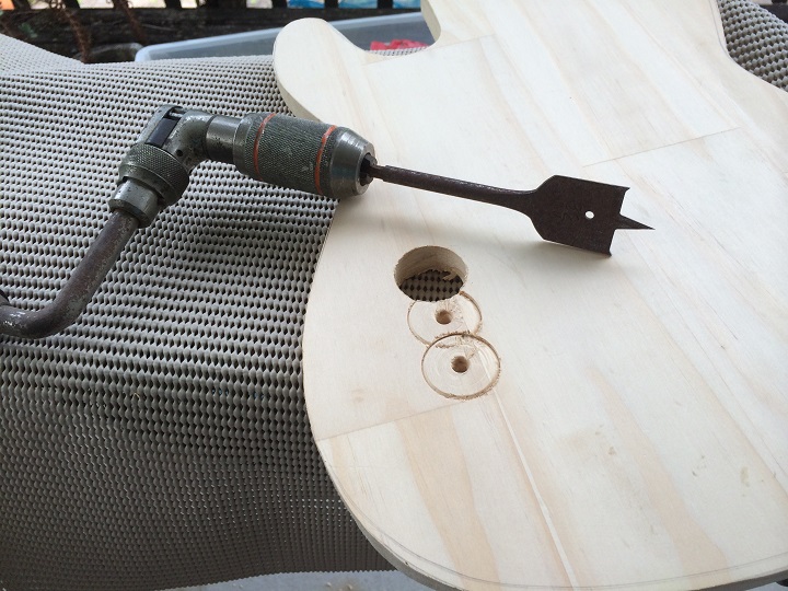

    Once the sheets were rough cut I clamped them together and then drilled three small pilot holes where the volume knob and 3-way switch were going. The more observant among you may ask why three holes for two knobs…? I have no idea! I think fatigue was starting to set in. A dab of timbermate and she’ll be as good as new. Lol.
    I then used the outer pilot holes as guides for the spade bit and drilled through the back and middle layers. This gave me the dimensions for the control cavity.
    On the front, again using the pilot holes to guide the spade bit, I drilled in from the back being careful not drill all the way through as I won’t be using a front control plate.

    1. First of the 2 pup cavities complete. I hope I’ve left enough of a gap for the copper foil.

    3. Now to start the control cavity.
