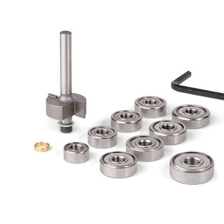

    Would love to guide you with those tools but unfortunately have never used them. I would consider if you plan on building more than one guitar with binding. If so then consider this set from StewMac. Currently $135 plus postage. You can also get your binding from them at the same time. Don't buy wooden binding unless you can bend the wood. Stick to the plastic variety. The basic routing set will give you the variety of 'bearings' you need to complete most jobs. Just remember to read the instructions carefully before routing your binding.
    Some worthwhile points to consider.
    Always test your routing set up on scrap wood before attempting to route the guitar. Harder to fix when you have already gone to deep.
    The width of the router bit minus (2 times the thickness of the binding) will point to the size of the bearing you should be using to get the correct depth. Rather use a slightly LARGER bearing if you don't have the exact size. Best to be slightly proud with the binding than to have cut too deep.
    When routing, always follow the grain of the wood. Routers tend to take chunks if you go anti the grain.
    When working on an archt. as opposed to a flat body, angle the router to accommodate the curve so that the binding is cut parallel to the sides of the guitar.
    I'll try post some pics to show what I mean.

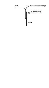

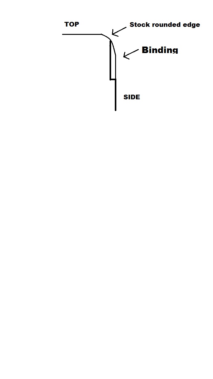

    I drew these quickly to demonstrate what I had in mind:
    This one being the final idea:

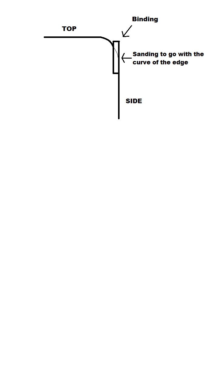

    And mounting the binding roughly like this. 6mm binding with about 1mm above the top curve so that I could sand it to follow the curvature of the edge. Final width of the binding would be about 5mm. Or I just mount the 6mm in and sand the final edge. Just thought that it would be wise to leave at least some extra on top:

    What I learned from you already is that I cant place the binding to be glued like I thought but have to place it so that the tape won't force it to bend/tilt. Meaning I will place the whole strip below the rounded part of the top edge.
