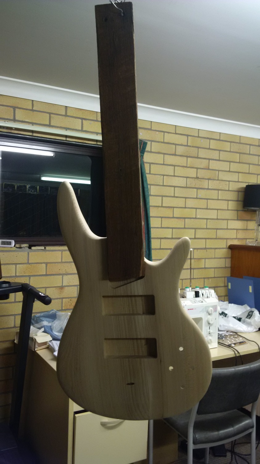

    As im aiming to get the first stain coat on tonight, I was wondering what advice people could give as to how to keep the thing after its stained. Can I just leave it hanging up like in the picture?? Will the stain run off or will it b ok?

    I've attached a bit of hardwood to make it easier when i'm trying to stain it. The hardwood is just screwed on through the holes in the body which the neck will bolt on thru.
