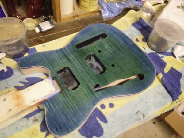

    It's still a bit cold down in my garage/workshop but I have managed to fix the problem binding, shape my headstock, mask the binding, sand, sand and sand...and yesterday started to dye the Flame Maple top, It coming along great.
    It's still early days, I'm not satisfied with the way the turquoise/aqua colour worked out, it's too green, but a bit of blending will get it right.
    I have decided to use Feast and Watson's Scandinavian Oil (Danish Oil) as a top coat. A few coats of the oil and then I will add some polyurethane to it for the final coats just to toughen it up.

    looking good Simon, the stains are dyes ?
    love the headstock shape looks cool
    Keda Wood Dyes - powdered aniline dyes
  8. #18
    2,079
    Looks great Dajavoodoo, your daughter will love the guitar. Have fun .

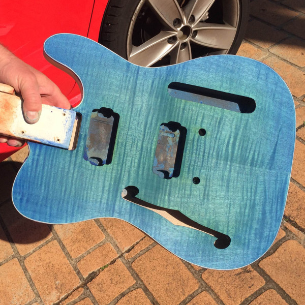

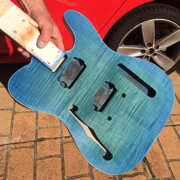

    I looked at those photos I posted last night and thought the quality of them was not up to standard. I was using my new phone, and the camera on it is not very good apparently.... after blending the colours and having more fun today this is what I have come up with.
    Hopefully these images will be better than the ones I posted last night.
    Simon

    Now it's blended looks even better great job
