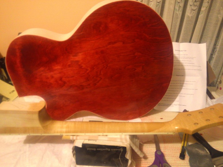

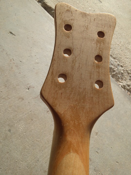

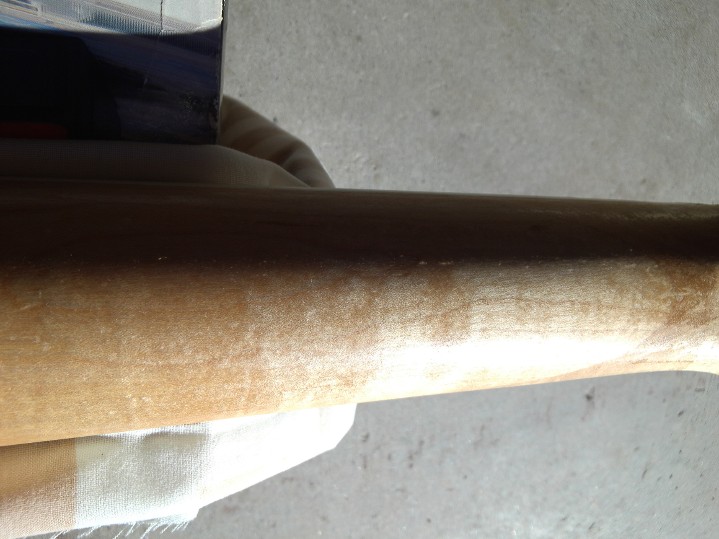

    run your hand over it, and feel for bumps , divots and rougher spots. If it feels smooooth then you are probably there
    Also check from all angles in daylight. Often small dents that can be easily sanded out only show up this way.

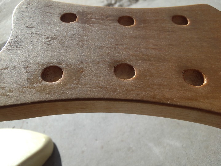

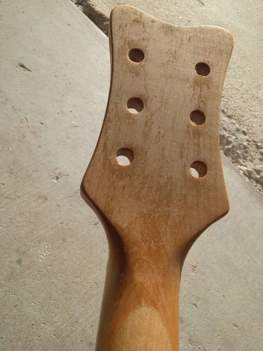

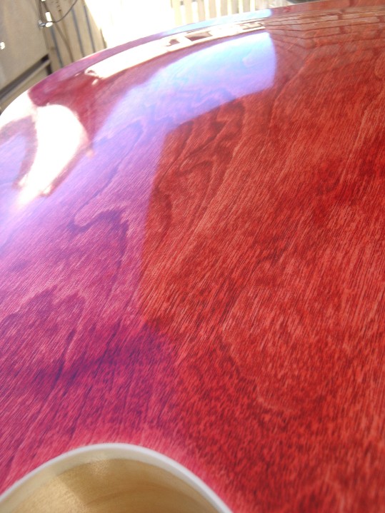

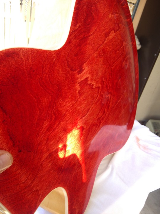

    Hi all, thanks for the feedback and just to keep everyone in the loop, coats done, next a bit disappointed when I ran the first final coat but I'll wait till is completely dry and use the steel wool supplied by Dingotone kit (Fantastic) so I'll try to upload some pics and any Ideas would be great.. So while I'll wait for the neck to dry (since Friday the 31st of last month) I've started with the electrical, and yep again stuck, worked out the tones and volumes pots, little I didn't realized there's a master volume pot, any diagrams that can help?
    I'm also waiting for the Intensifying coat to dry and is looking good as far as smooth feels and not many or close to none grain spots, happy about that, I will post some pics soon.
    So I hope I can upload those pics and get as much help as possible, both neck final coat and wiring.
    Thanks in advance.Click image for larger version.

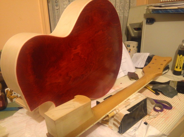

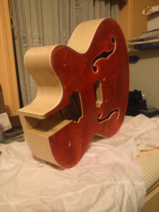

  10. #20

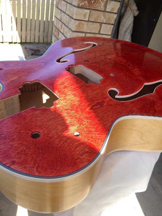

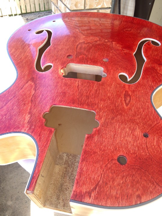

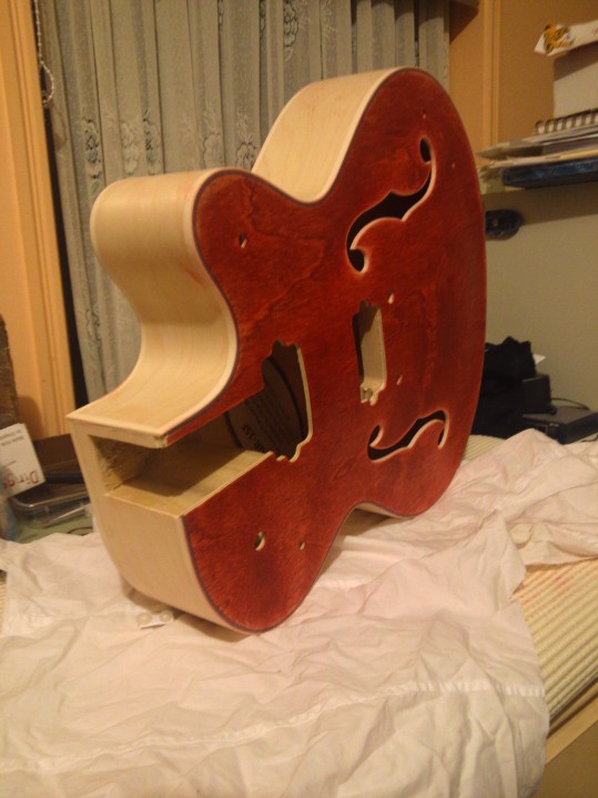

    Hi again, I meant to say that I've applied the Intensifying coat to the back of the guitar body and happy so far, I haven't applied any to the front of the body yet so the front will be next soon when the back is dry, so here I have some picks, if anyone spots something not right please let me know.
    Thanks in advance again everyone.Click image for larger version.
