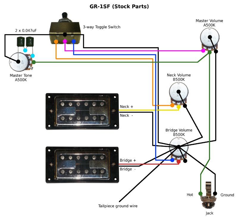

This diagram is using stock parts only and has a Master Volume, Master Tone, and individual volumes for each pickup:
The A pots are used on the Master controls, as I'd expect them to be used most, and the B pots are used as the individual pickup volume controls. Swap the A's and B's around if you think you'll be using the pickup volumes more than the master. The two 0.047uF caps are wired in series on the tone control, which gives you a nett 0.0235uF value. If you want the darker 047 tone just use a single cap. The tone is wired on the output of the master volume, as per the original schematics, but this can make them a little intertwined (volume affects tone, tone affects volume) so be warned.

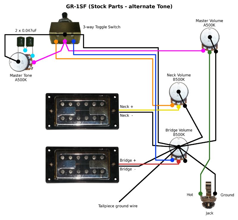

If the tone/volume interaction is something you want to avoid, then 'modern' solution is to wire the tone to the 'in' lug of the master volume. This diagram does that, again with all stock parts, but has the added benefit that you can just connect the tone to the output of the pickup selector switch, no long wire run required.

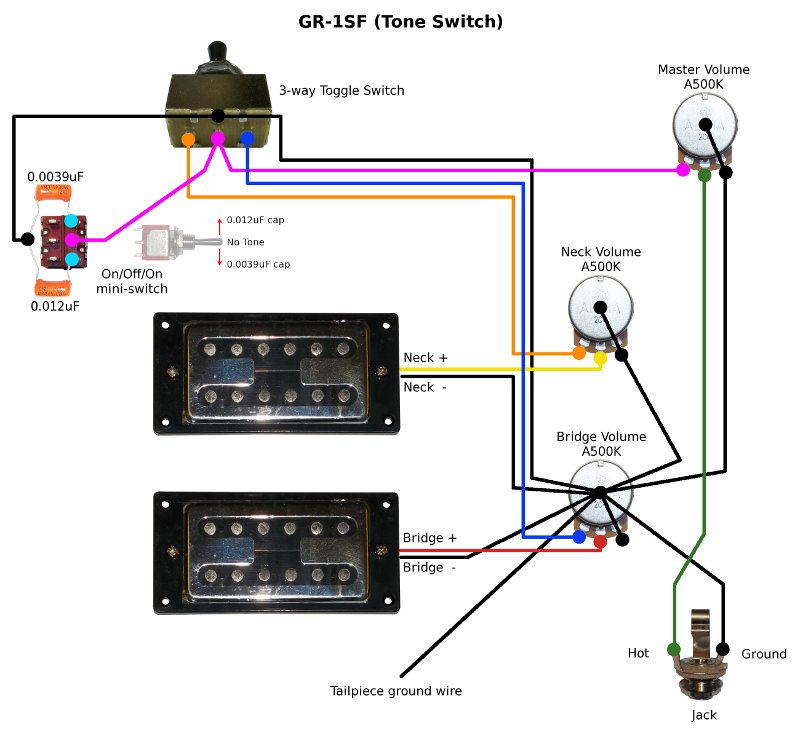

Another traditional layout uses a tone switch with 0.0039uF and 0.012uF caps instead of a tone control. So, if you've got a couple of caps and either a DPDT or SPDT On/Off/On mini-switch laying around you can add this without having to drill any extra/larger holes in your kit.
The 0.0039uF cap setting will just drop off the upper highs, while the 0.012uF setting will give you a slightly darker tone (but still less than a standard tone control).

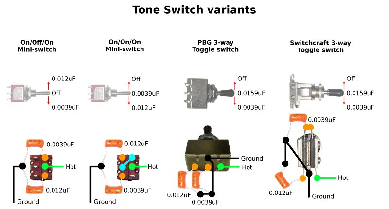

If you want to try a tone switch, you can actually do it will On/Off/On or On/On/On mini-switches, or even standard 3-way toggle switches:

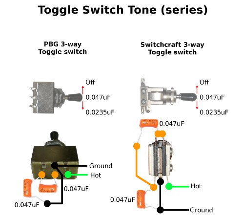

With the mini-switches you can use whatever individual cap values you want, but it's not so straight forward with the 3-way toggles. With them you can't have one cap or the other, instead you can only have one or both. This works fine if you have one medium/large value cap and a comparatively small value one, like above, as the two are summed in the 'both' position (0.012 + 0.0039 = 0.0159uF) so there is little impact. But, if you have two medium/large values you need to take a different approach.
If you wanted to use a 3-way toggle to switch between say a 0.022uF and 0.047uF cap, you actually need to use two 047's and wire them this way:
In the 'both'/middle position it shorts one cap so you just get a single 0.047uF cap, while in the other position it gives both caps in series which gives you a value of 0.0235uF. If you used two 0.022uF caps you'd get a series value of 0.011uF. Not that you're likely to ever be doing this… so I don't know why I bothered
