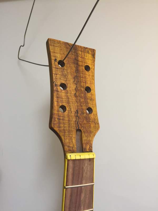

    Hey Luke, no worries best you shape the headstock before the staining/clear coats go any further. You will need to sand the top edge that you cut/shape then stain.

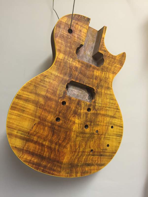

    nice Luke, you are on a winner

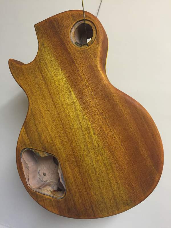

    I think you're right stan. Thanks wokka, I'll give that a go now as I've got some of the 0000 steel wool lying around somewhere, might even do the headstock shaping this afternoon too.
    Thanks so much for the advice! Makes it a lot easier knowing there's guys on here that know their stuff!

  6. #16

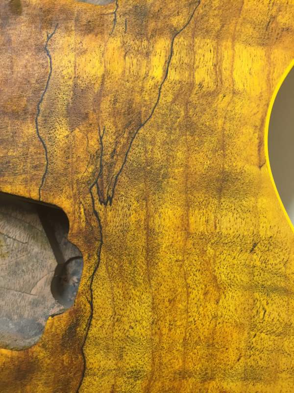

    Wow Luke, that spalted cap has come up beautifully. Was that ebony Timbermate you used? Looks fantastic. Once the clear goes on she's really going to pop!!

    Lookin real good there Luke!

    That finish is gorgeous mate

    Thanks guys! Yeah Gave, ebony timbermate! Stuff works wonders. So keen to get the intensifier on, should really make it. I'll be sure to post photos once it's on this weekend.

    Mate that's looking sweet, really digging it!
