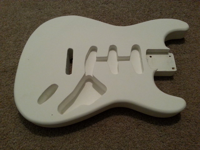

    Update time.
    Doesn't look like I have achieved much this week but filling, sanding, checking, sanding, priming, Not happy with the finish, more sanding, painting again, checking again, another bump, more sanding, painting, checking, rubbed through with the wet and dry, paint again, try and use lighter touch and go up to 1200 wet and dry, rubbed through on one spot, more paint, and finally happy. ( Not really but you gota stop somewhere. )
    I figure any irregularities will be covered by the art and top gloss. ( I hope ). The body is within a mill flat across all faces.
    Have ordered hardware from Putbull and will trial fit all before I hand it over to the artist for the African landscape on all surfaces. Should look amazing going by his paintings on his wall.
    While he is doing his thing I will be cutting the frets, attaching the fret wire, radiusing and levelling and shaping the neck.
    If that goes to plan, I will get started on my next build. Another strat and a pine Tele.
    I will be making my own truss rod. I am heading towards a 5mm threaded rod, flat nut on the head, lock-tighted and peaned over so it won't move and on the heel, washer and a treaded joiner with an allen head bolt lock-tighted into that.
    It will be placed int a concave ( from the fretboard ) route and fillet filled from the back with a skunk stripe of contrasting lighter coloured wood yet to be scrounged.
    That's it for now. Really enjoying the ride so far..
