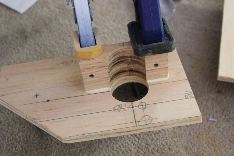

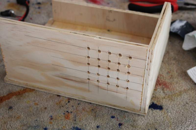

    hi guys,
    A little more progress today. I cut the top off the box (looks much better now) and finished off my electric motor mount. A big thanks to Gav for showing how to do this as I wouldn't have had a clue. I got the mount cut down to size, installed the screws for securing the motor, and glued the bottom of the mount to the inside wall of the enclosure. I also drilled a few holes in the back for heat escape as I was too cheap to buy a prewired power supply.
    Over the weekend I should be able to get the components wired up and test that I understand the connections between them. Then it's just a simple matter of getting the enclosure finished ready to accept them.
