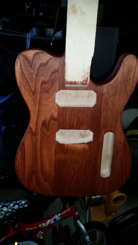

    I am doing a non PBG Tele with Schaller HBs and Wilkinson bridge, I also had to recut the pup cavities to suit. The pic below is from a few months ago
    Used a small blade in a multitool and a fine fine chisel ( no router here either )
    Today I rubbed the stain back and put the first coat of clear on it and it's coming up a treat

    nice looking tele Dave (sorry to hijack your thread Rob !) is that ash ? the neck pup route looks big, will this have a pickguard or a pup surround over it ?

    Both pups are vintage Schaller humbuckers and there will be no scratch plate, the body is 3 piece alder.
    @ Rob, the body got 4 or 5 coats of FW Jarrah, I wet rubbed the front & back yesterday with 1000 grit and put the first clear coat on and it did come up much better than I expected. ( another couple of clear coats to go )
    Enough of the hijack, here is a link to my much earlier post introducing the build http://www.buildyourownguitar.com.au...ll=1#post60046

    Wow Dave, that's some nice figure for Alder. I have built an Alder TL and it was nowhere near as nice. I thought you could only get that sort of grain with Ash. I love that each piece of wood we work on is unique, and it is up to us to make the most of it.
