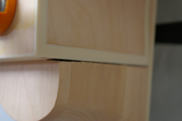

    Neck/body fit is nice and snug and the scale length looks ok.
    However one side of the neck heel isn't quite straight leaving a slight gap (see pic). I'm assuming that filling the gap somehow would be preferable to trying to level the heel, any help as to how i go about that when the time comes would be most appreciated.
    Cheers
    hey Dan, I wouldn't recommend trying to level the heel, will be a hard task to get all the faces seated nicely, plus you could change the scale length by 1-2mm. What I would do is try and find some matching timbermate putty and as you have it in the photo try and fill as much timebermate into the gaps, let it dry and sand off the excess.
    When you glue the neck that will take up any small gaps that there may be.
    Thanks wokka, that was my gut feeling about any levelling attempt.
    I guess I'll have to hold off my decision as to whether to finish the neck in clear until I see how good a match I get.
