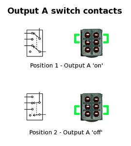

    As promised, some diagrams...
    The upper switch shown on the schematic allows output A to be turned on/off, using a DPDT switch. It's drawn in the 'on' position which connects the input to output A and turns on the red LED. Here's the schematic's switch representation in both the on and off positions side by side with a DPDT foot-switch showing which contacts are active (the green lines). You should be able to relate this contact sequence to some of the later diagrams to follow the circuit path. The centre lugs on the foot-switch are the 'commons' that are always in the circuit, one for each pole, and are shown on the schematic as the starting/fixed point of the arrows.
Name:	Switch contact sequence.jpg
    I didn't actually have a DPDT foot-switch spare so the above is a 3PDT photoshop'd to remove one pole (one vertical set of three lugs). The later diagrams are drawn with 3PDT switches but will just not use the middle pole (the middle vertical set of three lugs).

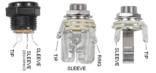

    Jacks...
    For a stomp box you usually want a way to run it from either a battery or external DC power, and ensure the battery doesn't get drained when you're not using it. A switched DC jack takes care of the former and a stereo input jack the latter. Basically, the DC jack is a standard centre negative (tip) connection that disconnects the battery when a plug is inserted, and the input jack is stereo and uses the ring and sleeve contacts to only complete the circuit's ground when a mono guitar plug is inserted. Pretty standard for a pedal, and that's the only change I've made.
    Basic jack layouts: switched DC jack, stereo jack, mono jack (respectively).
    (I've just noticed the Switchcraft mono jacks I have used in the wiring diagrams below have the tip and sleeve on the opposite sides to the one shown above. But, you can still see which is which)

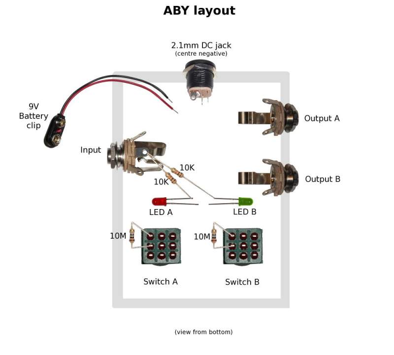

    It can get a bit confusing with everything jammed in, so here is just the labelled components without the wiring (viewed from the underside of the stomp box). Like I said, I've used 3PDT switches but I'm only using 2 poles and treating them like they're DPDT's. I placed and spaced the components to show how they connect, but you can vary the position as you want (and to suit your enclosure).
    (I suspect the 10K resistors will make the LEDs way too dim, so you may need to go to smaller values. Need to test)

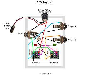

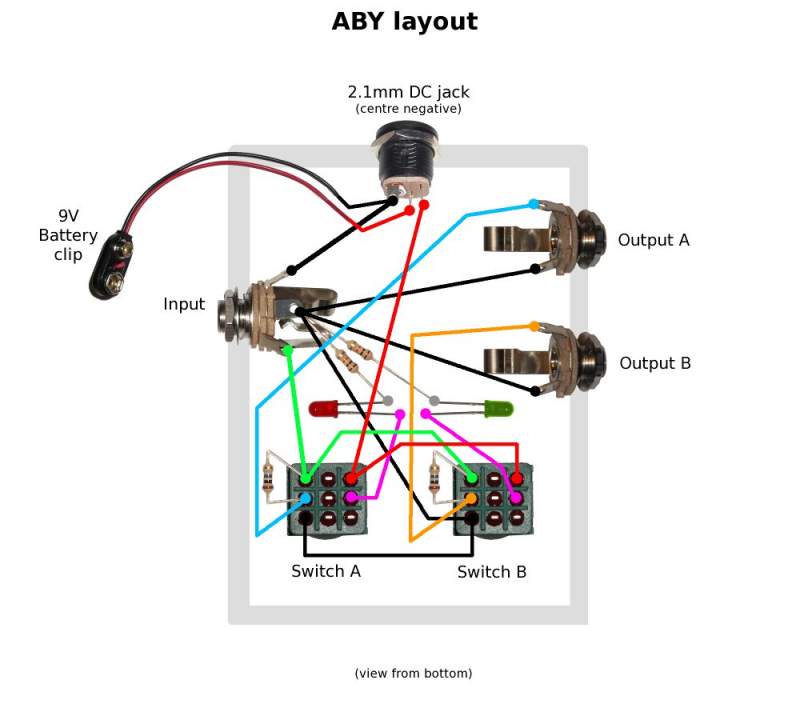

    And, here's the layout with the wiring and solder points in place. I've tried to keep it as clear as possible with the different colours and wire paths. Hopefully it's at least partially comprehensible.

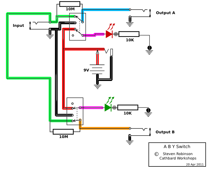

    To make it a little easier to relate the above layout back to the schematic, I've drawn the wiring colours onto the schematic as an overlay so you can see which wires are forming which links. The ground icons on the schematic (dashed arrowheads) are the connections to the 'sleeve' lug on the stereo input jack, except for the 9V ground which goes to the jack's 'ring' lug instead. Make sense?
    I think it's correct, but if anyone spots any mistakes please feel free to point out my incompetence. Nick, hopefully this will set you on the right path, let me know if you have any questions or need anything more.

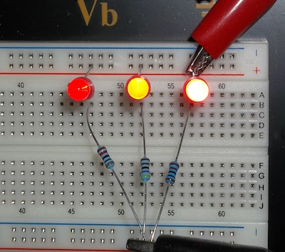

    Also, I just did a quick resistor test with some red LEDs and the 10K was actually much brighter than I expected, should easily be bright enough for most pedals. The camera has distorted the actual colours a bit in this image, but it gives a good indication of the relative brightness/intensity. Left to right the resistor values are: 10K, 4.7K and 1K (on a 9V supply). There's room to go even brighter with these LEDs, but this was enough for the demo. So, I was wrong, your schematic's 10K values should work nicely for low intensity indicators.
