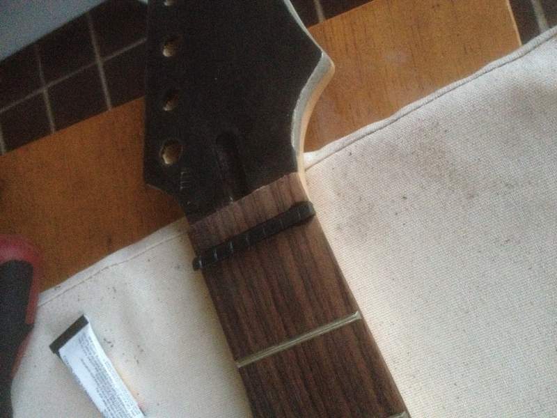

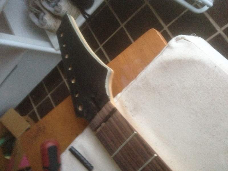

    Bit the bullet and cut it in. In retrospect, I really should've paid someone to do it because it wasn't worth the effort and time and swearing. Here's a pic of the slot and one of the nut sitting in nice and tight.

    look at it this wat mate, you did it yourself and you did a nice job
    doesn't look too bad Ultpanzi, hope you worked out the scale length and the correct measurement from the first fret.
    I wouldn't glue it in place till you have strings on and check the string height

    There was a fret slot where the nut slot should've been (I checked by mesuring that it was the right spot) so I worked off that. I measured the action and set it how I'd want it, but if I need to change it, I can always knock it out. I've had plenty of practice doing that cos I've swapped out many plastic nuts over the years.

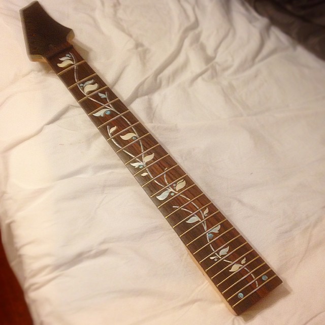

    J custom style inlays are in. Id like to say they're real but thatd be a lie. I dont have the equipment or skill required to inlay something this complex.
  9. #19
    nice one so its a sticker ?
    are the dot markers real MOP or stickers as well ?
  10. #20
    Member ultpanzi's Avatar
    Apr 2014
    233
    Yeahh, somewhat of a sticker. It doesnt feel like a sticker its more of inlay sliced super thin with an adhesive backing. I think its 0.07mm thick. So it feels like real inlay and its made of the same material but its a sticker. The dot markers are part of the inlay sticker.
