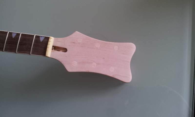

    2. Got the Head "plugged"... suffering the fate as Kells with his GR (and as noticed by Patto) the headstock was asymmetrical and the tuner machines' holes were all out of alignment (Ok, one of them was in alignment, but I couldn't decide which one! ) ... so I plugged 'em all and got them trimmed
Name:	Head Plugged.jpg

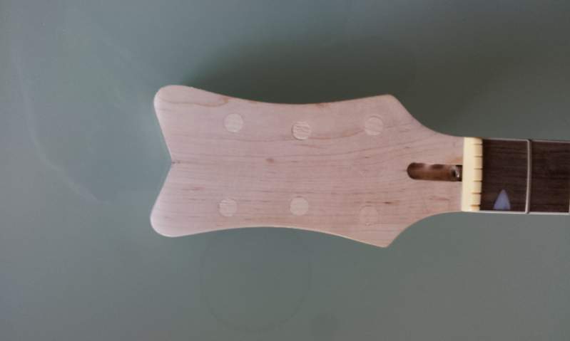

    3. Squared up the symmetry of the headstock and refined the shape (which just consisted of getting rid of the centre "curve" in the top of the headstock and cutting for the correct "straight vee" for a Gretsch) ... only rough-shaped in this pic and still needs a good sanding
Name:	Head Rough Shaped.jpg

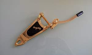

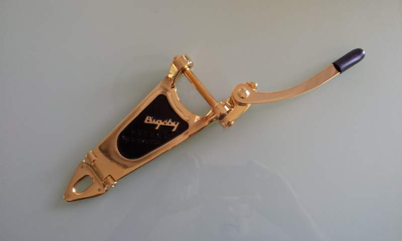

    ... and bonus of bonuses ... the Aussie Post Santa must have been working over time 'ços the gold-plated Bigsby B6 I'd ordered from the US only 3 weeks ago was sitting on the doorstep this morning ... very "bling" and I've been drooling over it for last couple of hours ... and a must have, considering I've replaced all the other hardware with gold-plated goodness (I'm not usually a g-p hardware person, but this kit just seemed to scream for it to go with the DT Orange that DB's mixing for me ... that's a hint DB, I think I wont be far off being ready for it!)
Name:	Bigsby Arrived.jpg

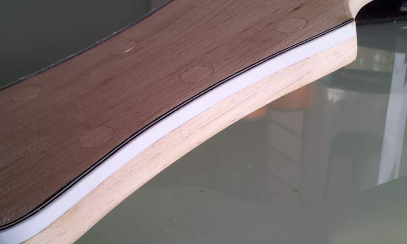

    ... anyway, after finishing sanding the body, head and neck to ready-to-varnish stage, the next step before varnishing will be to install some White/Black/White binding 'round the headstock. It's a bit of nervous decision as hand cutting the channel (with the proper tool of course) and gluing the binding will be a first for me ... but this axe just seems to be asking for this too (and what's the worst that can happen - a complete and utter failure! )
