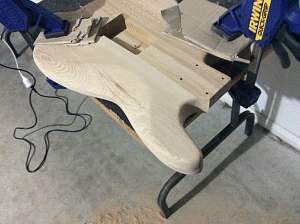

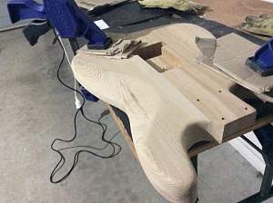

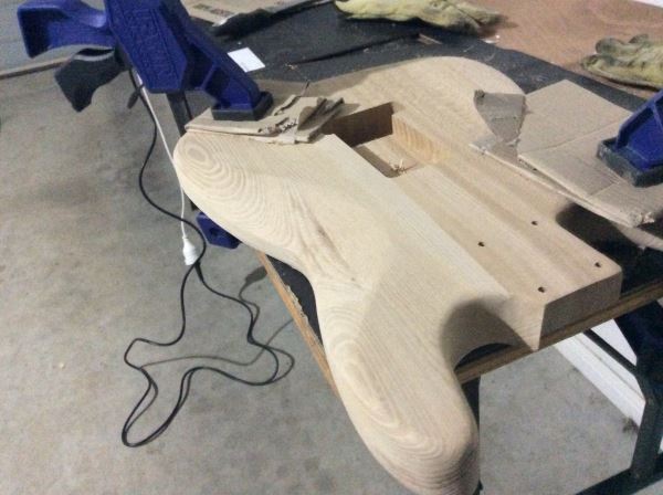

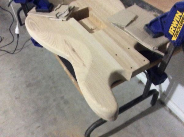

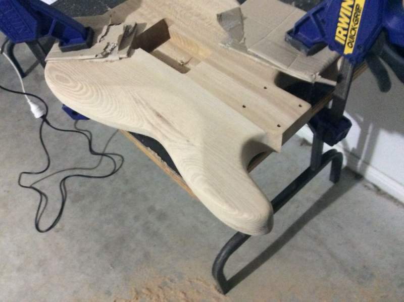

    So lets flip that body over and expand that cutaway
    Before
    After
    And another after

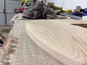

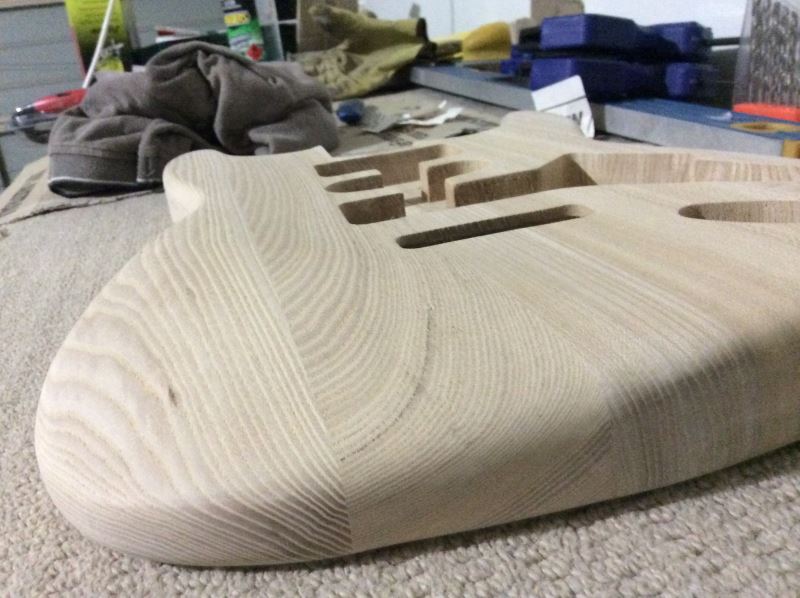

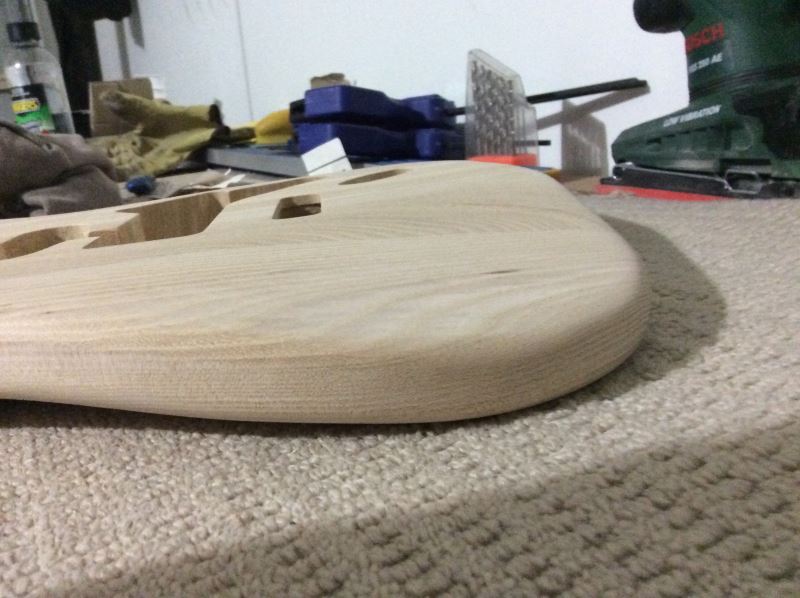

    Sanding
    And after hand sanding at 180 and 220 all the sharper lines have gone away
Name:	Sanding body 01.jpg
Name:	Sanding body 02.jpg
Name:	Sanding body 03.jpg

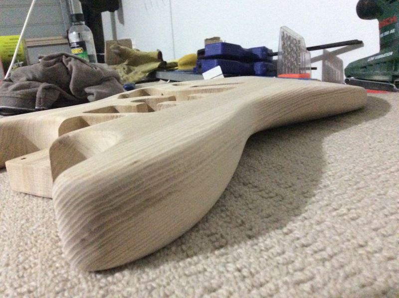

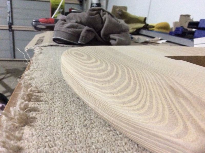

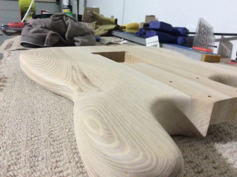

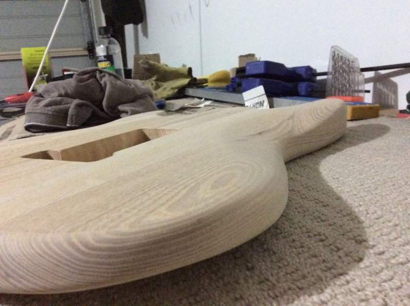

    underneath
    on the backside all is looking good
Name:	Sanding body 04.jpg
    from the front
Name:	Sanding body 05.jpg
    from the back

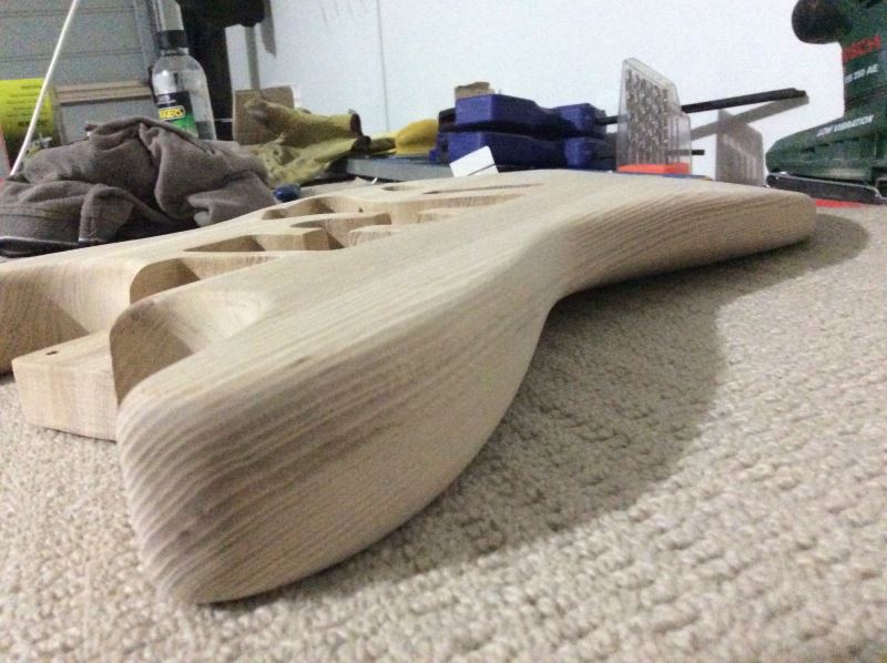

Name:	Sanding body 06.jpg

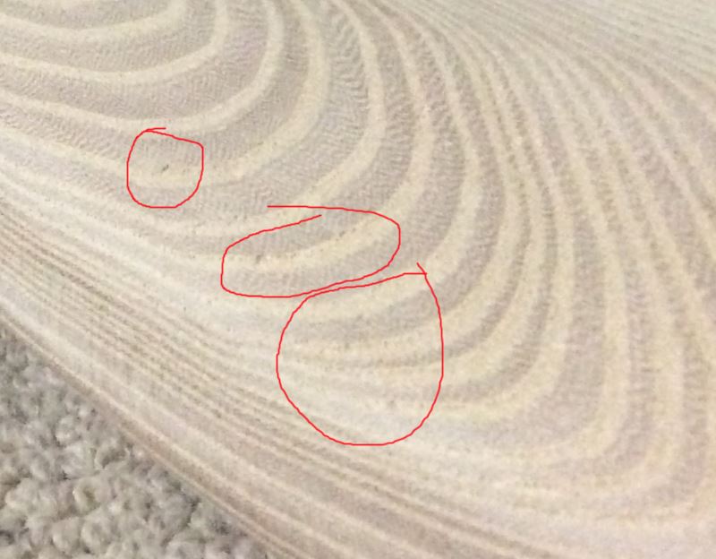

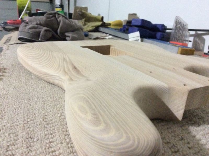

    closer up
Name:	Sanding body 07.jpg
    there are these little marks here right between the rings. Pretty tiny, so I am not so worried. I have sanded past any rasp marks, so I think maybe I have been a bit heavy with the sand paper and those really soft bits between the rings have just "chipped" out. We'll see how we go with the finer sandpaper.

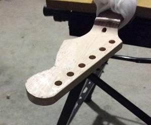

    The Headstock

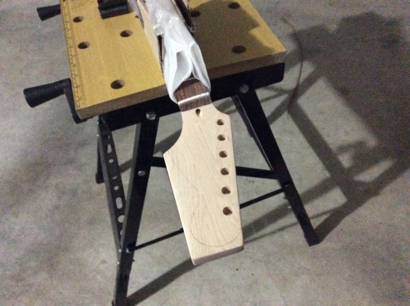

    design drawn - nothing too original, but I have plans. Oh yes people ... I have plans. Mwahahaha

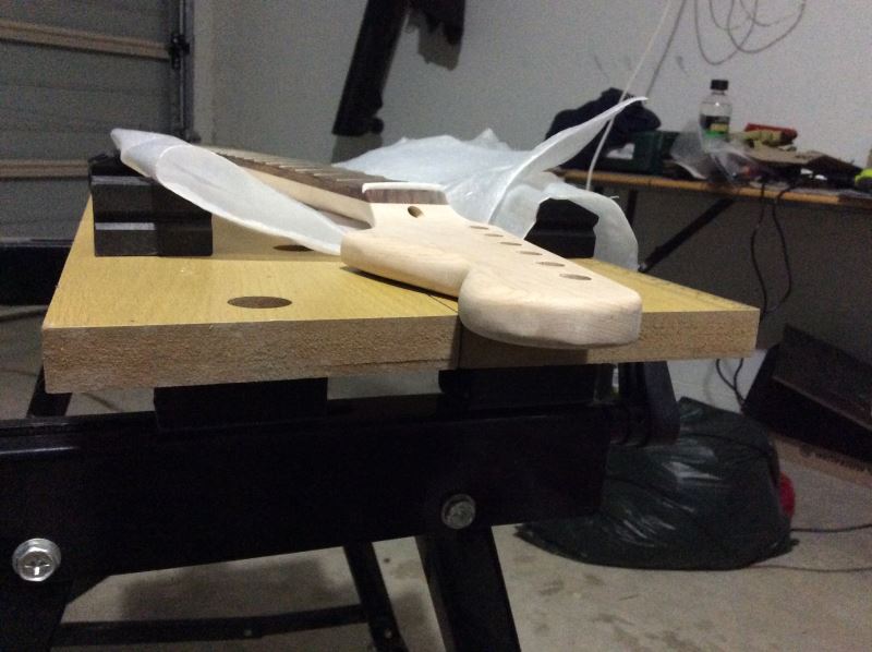

    checking it out - yep. Lets grab that jigsaw.

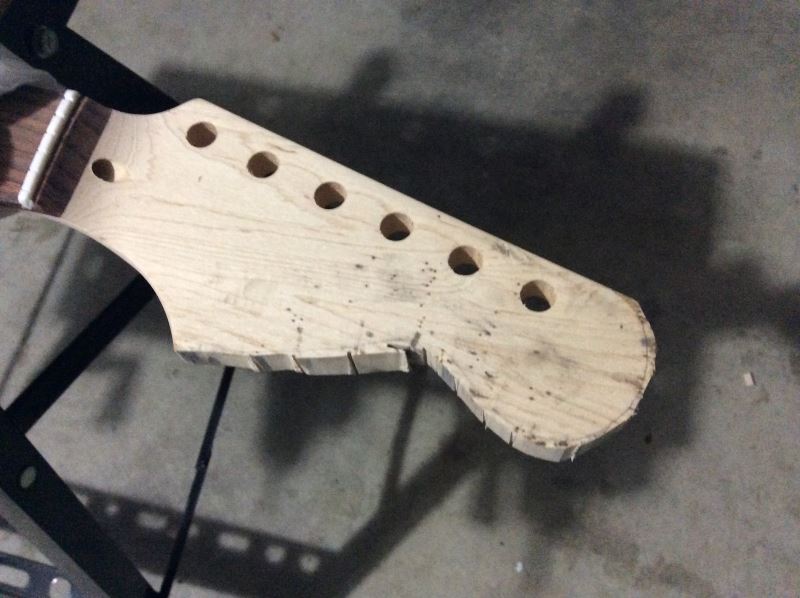

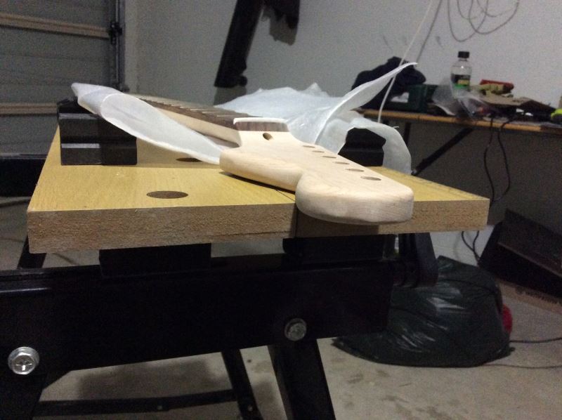

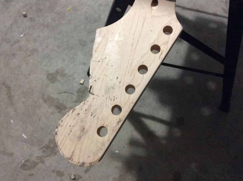

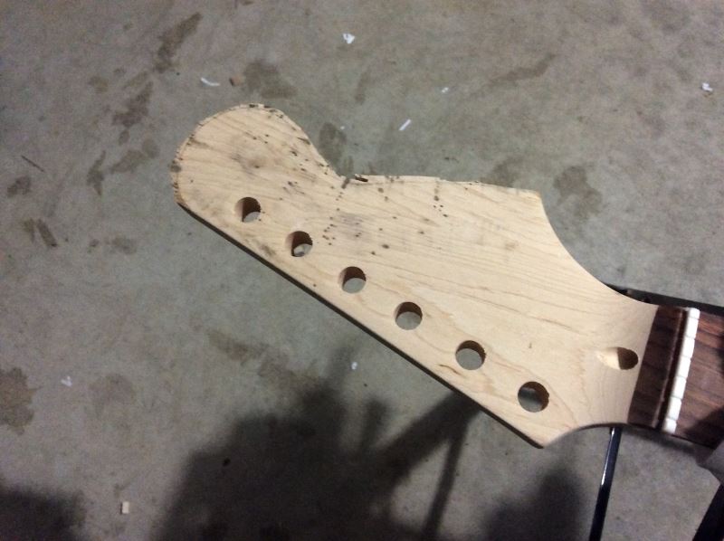

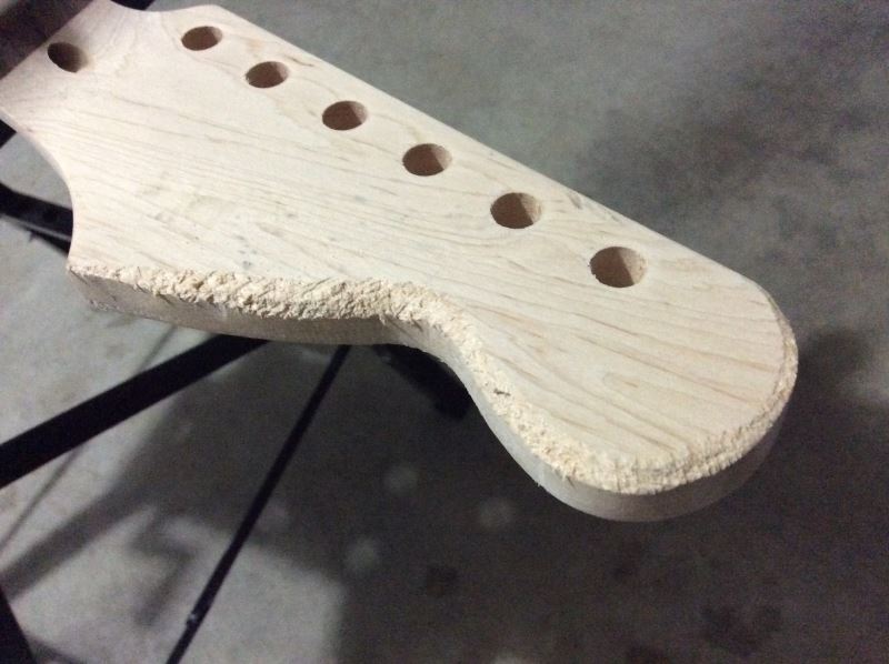

    Oh no. oh no. Vibration was horrible. Kept jumping out of the cheap-ass Workmate knockoff. I may have to invest in a coping saw for Build Two when that comes around.

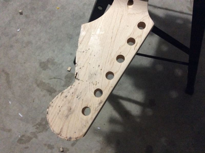

    Actually this looks bad, but with the plans that I have (yes, those plans) I don't think this will be an issue
    But dear baby Jesus it looks so horrible at this stage.

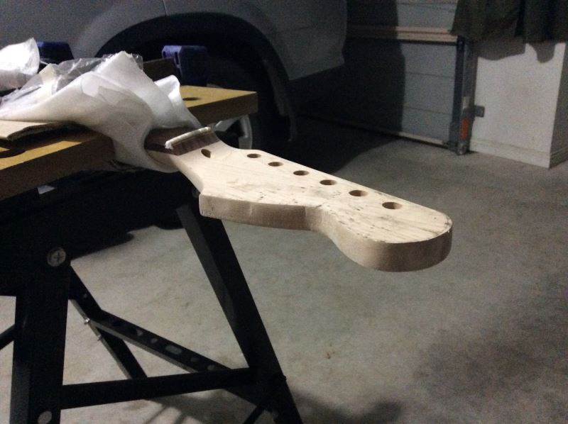

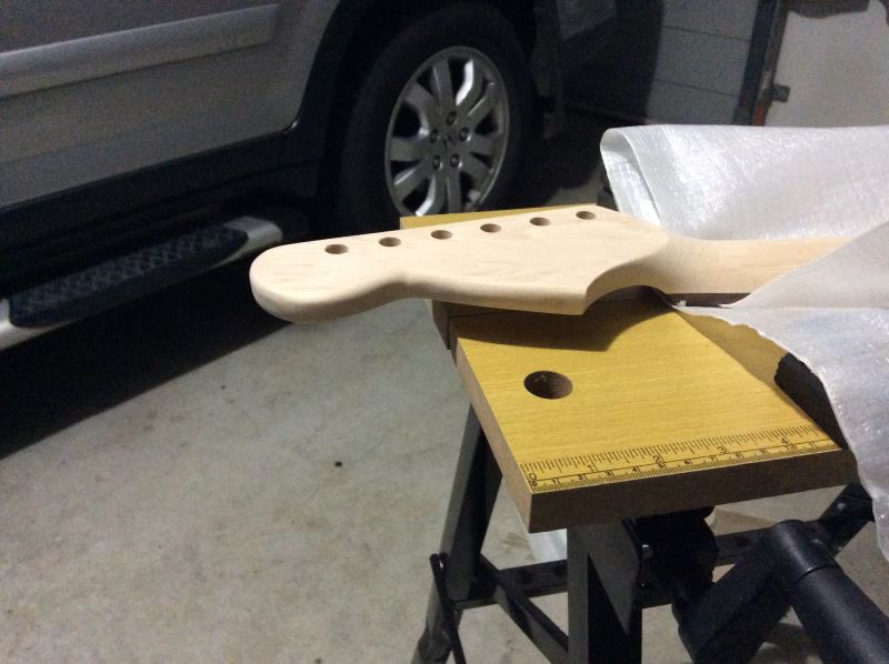

    clean up that headstock
    so first things first lets grab the orbital and sort some shit out
    cleaned up nicely

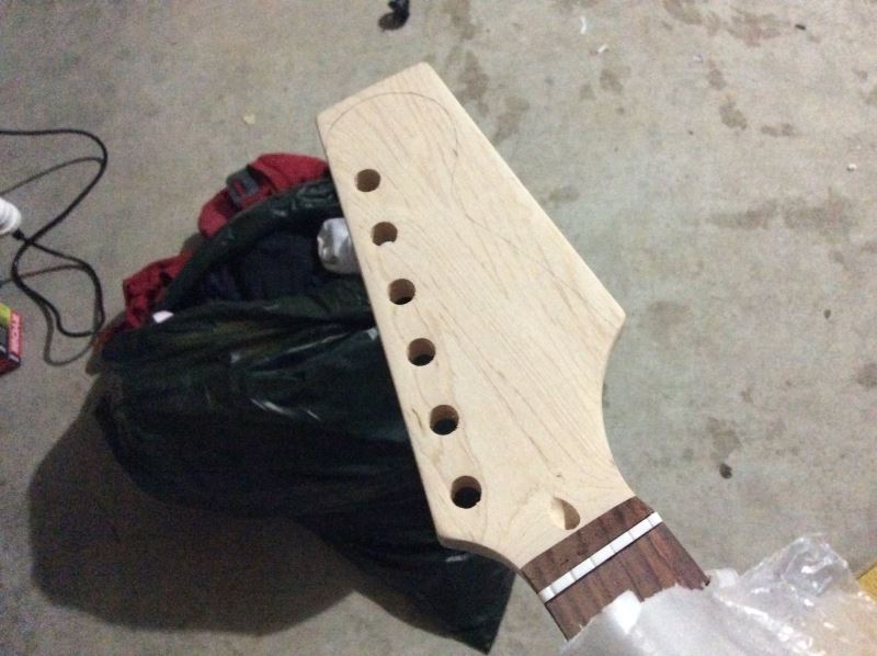

    yep - saved. Now is the time to EMPLOY THE PLAN!!!!!

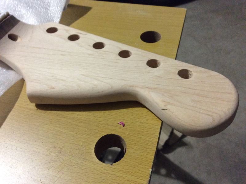

    grab the file and ...
    round that sucka - I have never seen that before so I am claiming it as mine

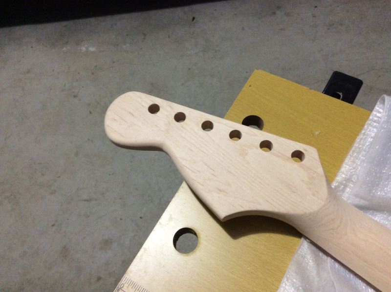

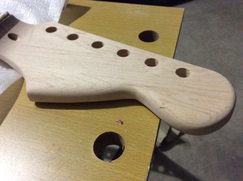

    a few more picks of the headstock
    still a couple of small flat spots that need to be sorted. Not a big deal.
    and the backside got the same treatment obviously
    just a little kink in the curve in front of the 5th hole.
    So this is where I am up to now. Whats ahead immediately is much neck sanding and body sanding before I get to the staining stage.
