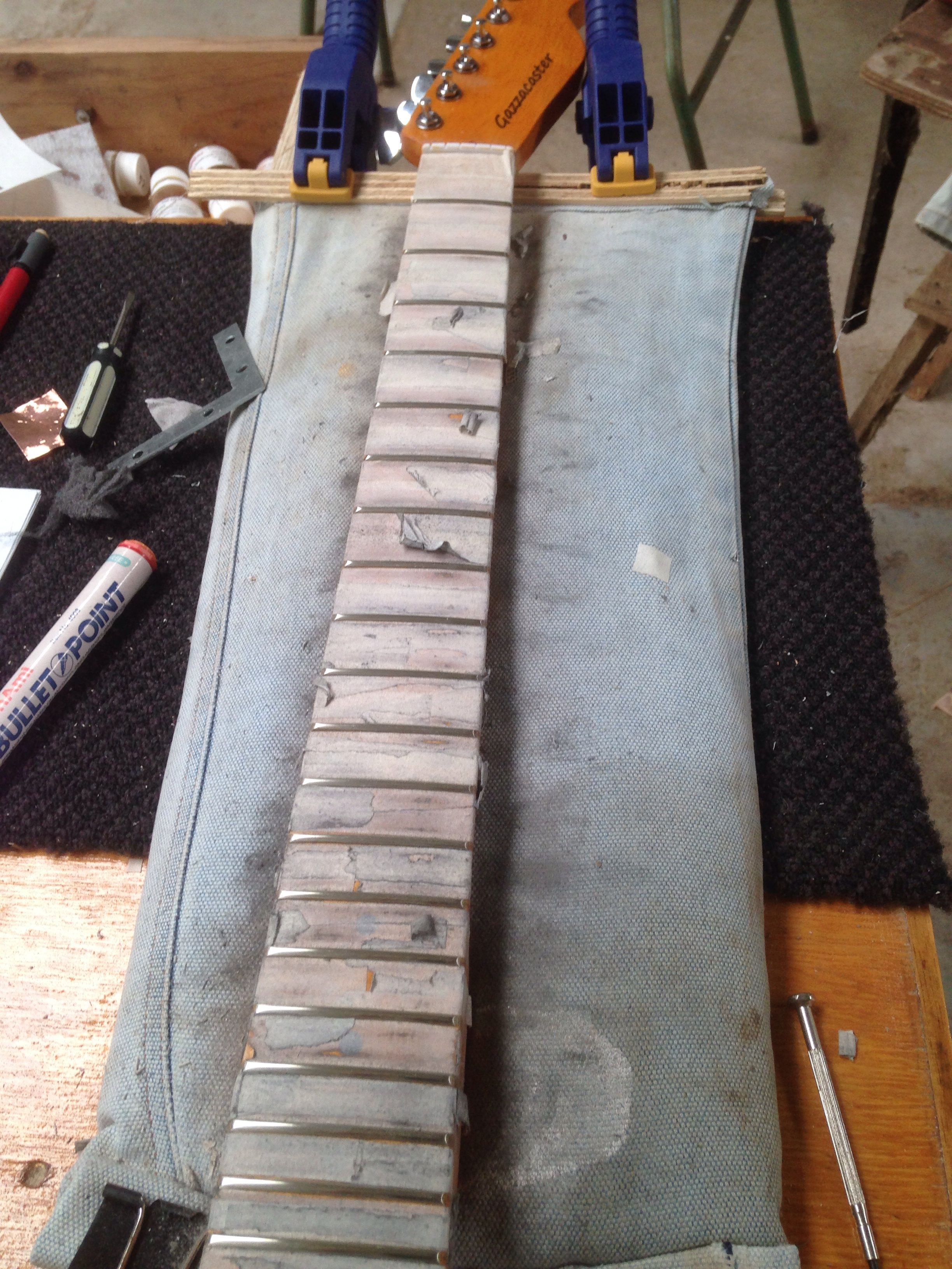

    Build update got myself a fret file and fashioned up a crowning tool by filing a groove in an off cut of timber which worked surprisingly well since when I used the file the frets were looking a bit rough
    Also the project supervisor can be seen checking out the project
  10. #20
    Coupla more pics
