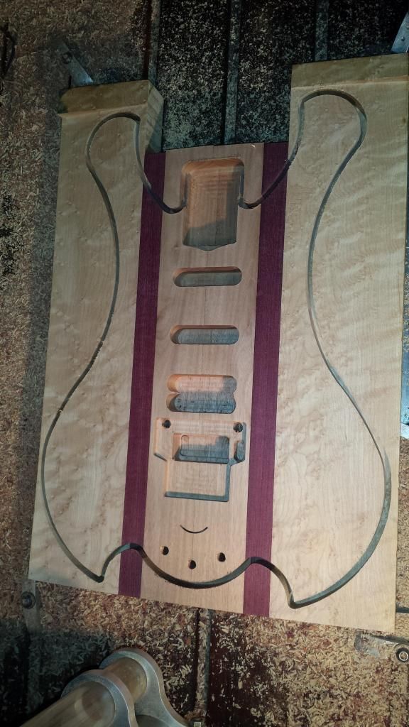

    just did a hardware upgrade on my cnc getting 20000 mm/m out of it so its cranking
    some cad tasters of things to come

    cranking .. a bit too fast for a stable clean wall cut, need to slow it down or do a finnish pass on the walls to make a perfect 100% finnish..oh well all part of the discovery. its not damaged, just not 100% its a good 90% but it can be a 100 so why not..next time!
    Damn that's fast. Throwing a little caution to the wind there?

    Wow.... That is coming along very nicely.
    This is going to be one dead sexy Guitar

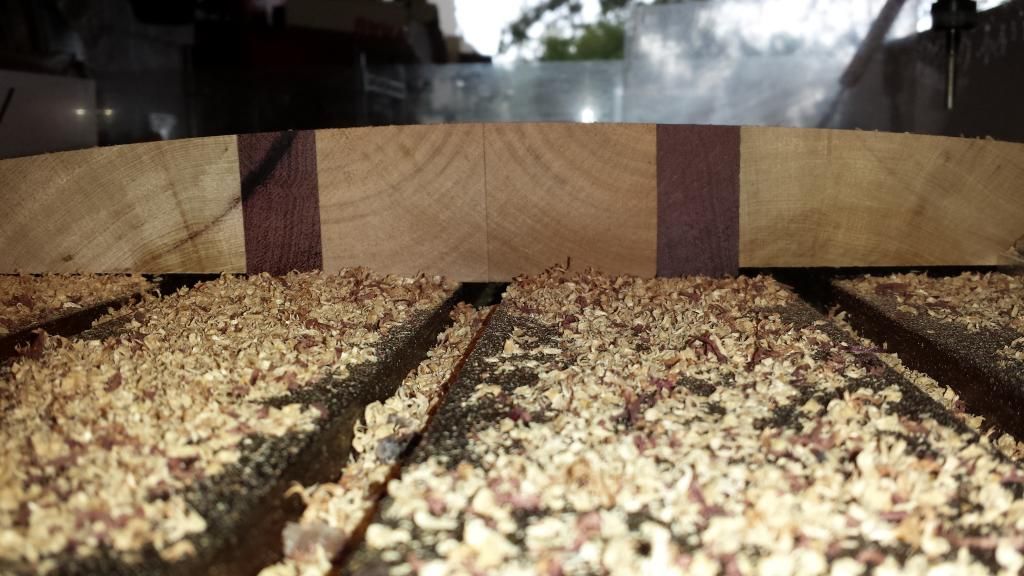

    I dont want to sound like a biarch here but i noticed that the centre join looks like it isnt totally flush.
    The next toy....errrrrm....tool for you to buy is a jointer/ planer. This will enable you to get your timber edges so flat and square that joins will be invisible
    Keep up the great work, and I reckon its time for you to take the 'Wanna be' part out of your signature tag and maybe replace it with 'Artist'

    I will upgrade my triton with the planer attachment next..whoo hoo, thanx for th eadvice dingobass ive not done a lot of guitar wood glueing so will do that next

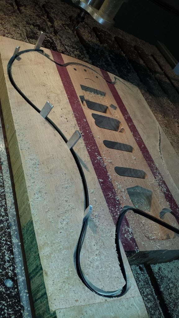

    ok todays efforts and my little way of doing the binding!
    but first..this
    [embed]https://www.youtube.com/watch?v=uMYOwI3uoXM&feature=youtu.be[/embed]

    Moderator dingobass's Avatar
    4,491
    I like it!
    Binding is a lot of fun and this way of doing it just makes a lot of sense when you have the toy to make it easier.
    How many wedgy things do you have? it is best to get as many as possible in there, spaced out about ten mm apart.
    This way your binding will be tight as... sure beats using binding tape
