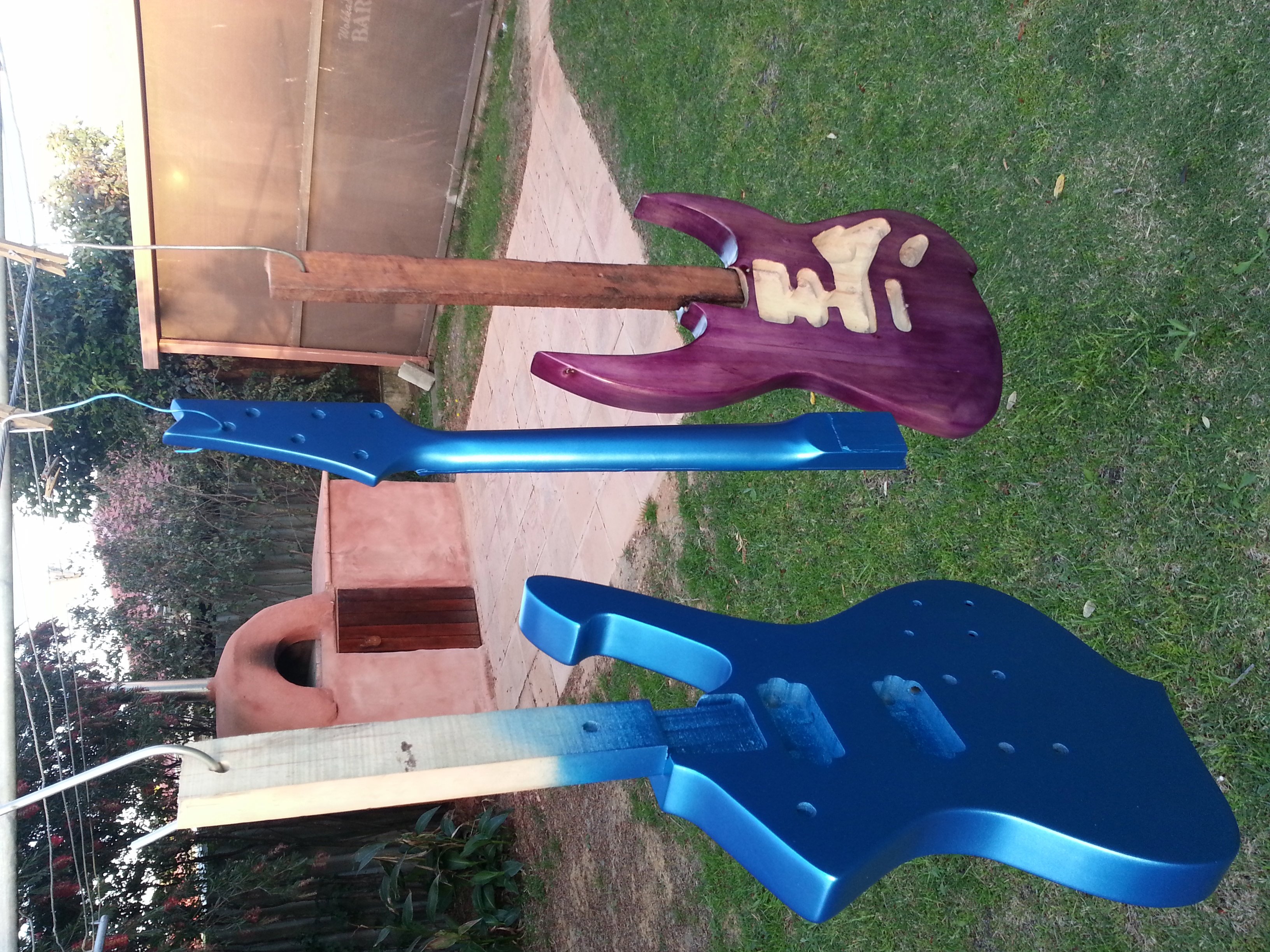

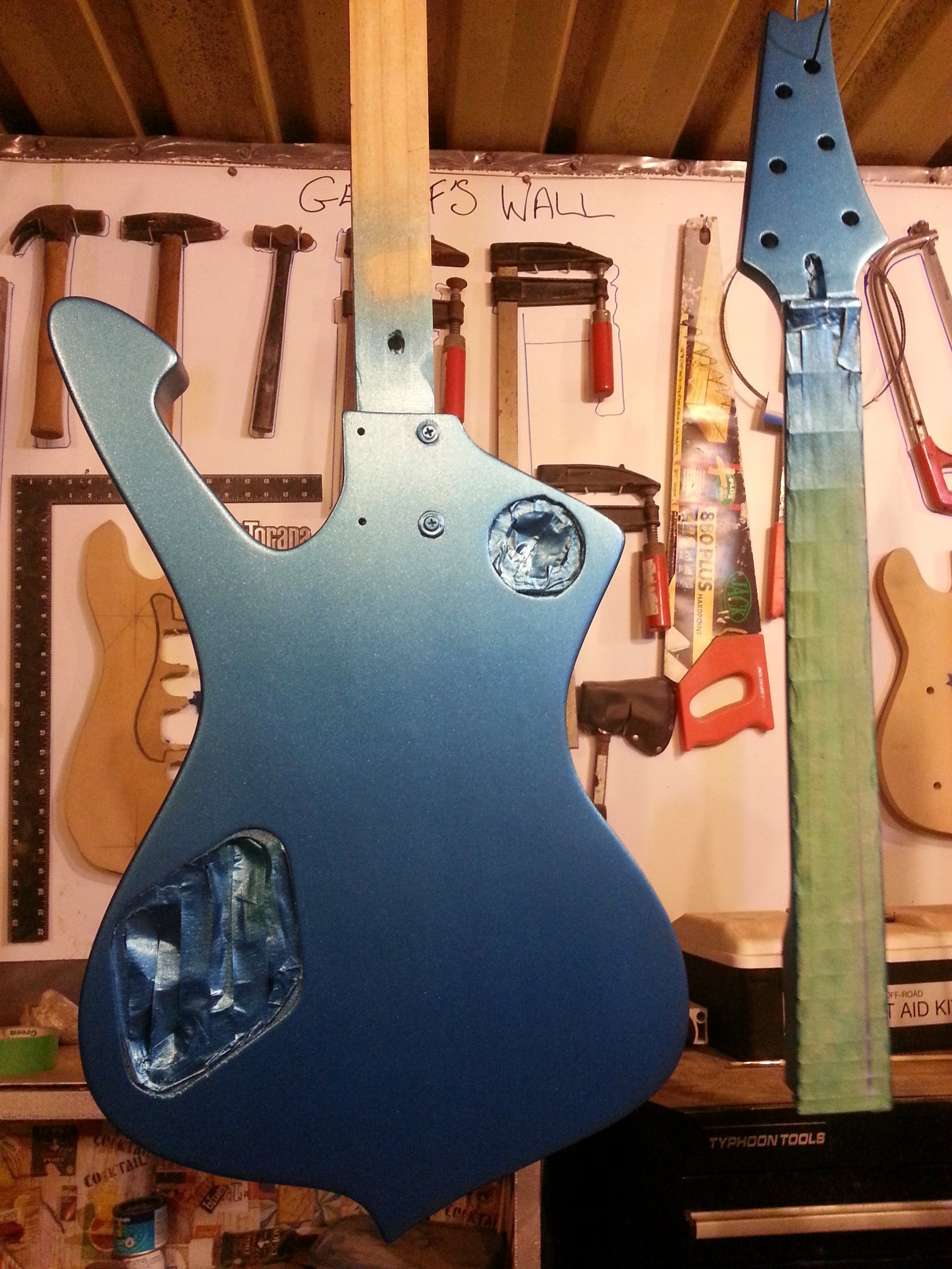

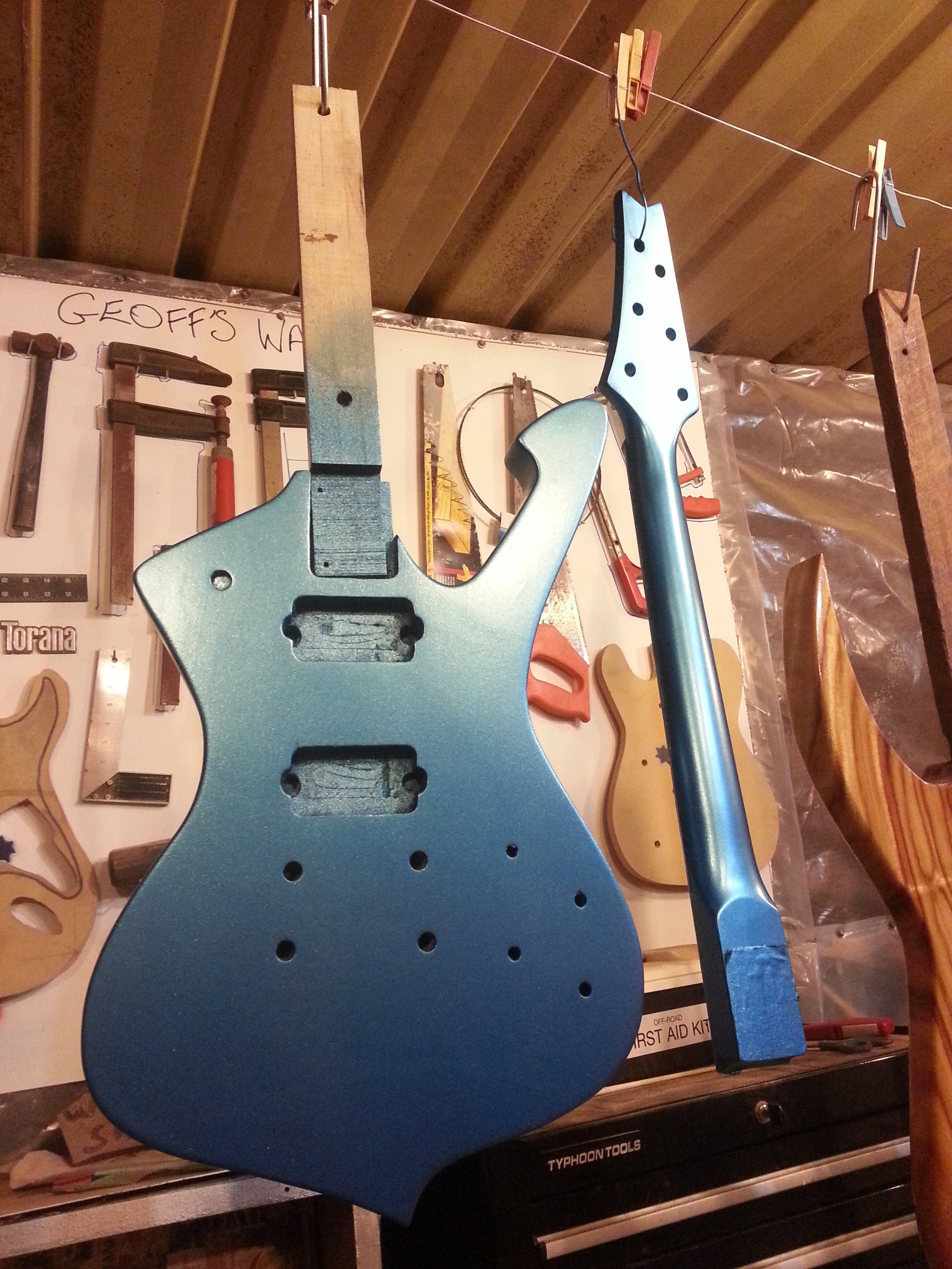

    Got 3 light colour coats on, starting to get the finish I'm after, bit more light sanding and another 2 coats should lock it in before southern cross and clear
  7. #17
    Lookin Schmick!!
  8. #18
    Last Blue coat
  9. #19
    Mar 2013
    Canberra
    162
    that's really coming up nice. Great colour choice for the Iceman too.
  10. #20
    yer cheers Darren, very happy with the colour choice, there are so many different shades of automotive blue so I think any of them would look good on the iceman shape.
    Probably give it one more body and neck colour coat, and I've ordered blank stencil sheet to cut out the southern cross stars, hoping that arrives end of this week, but I'm away following weekend so looks like I won't finish this until December GOTM
