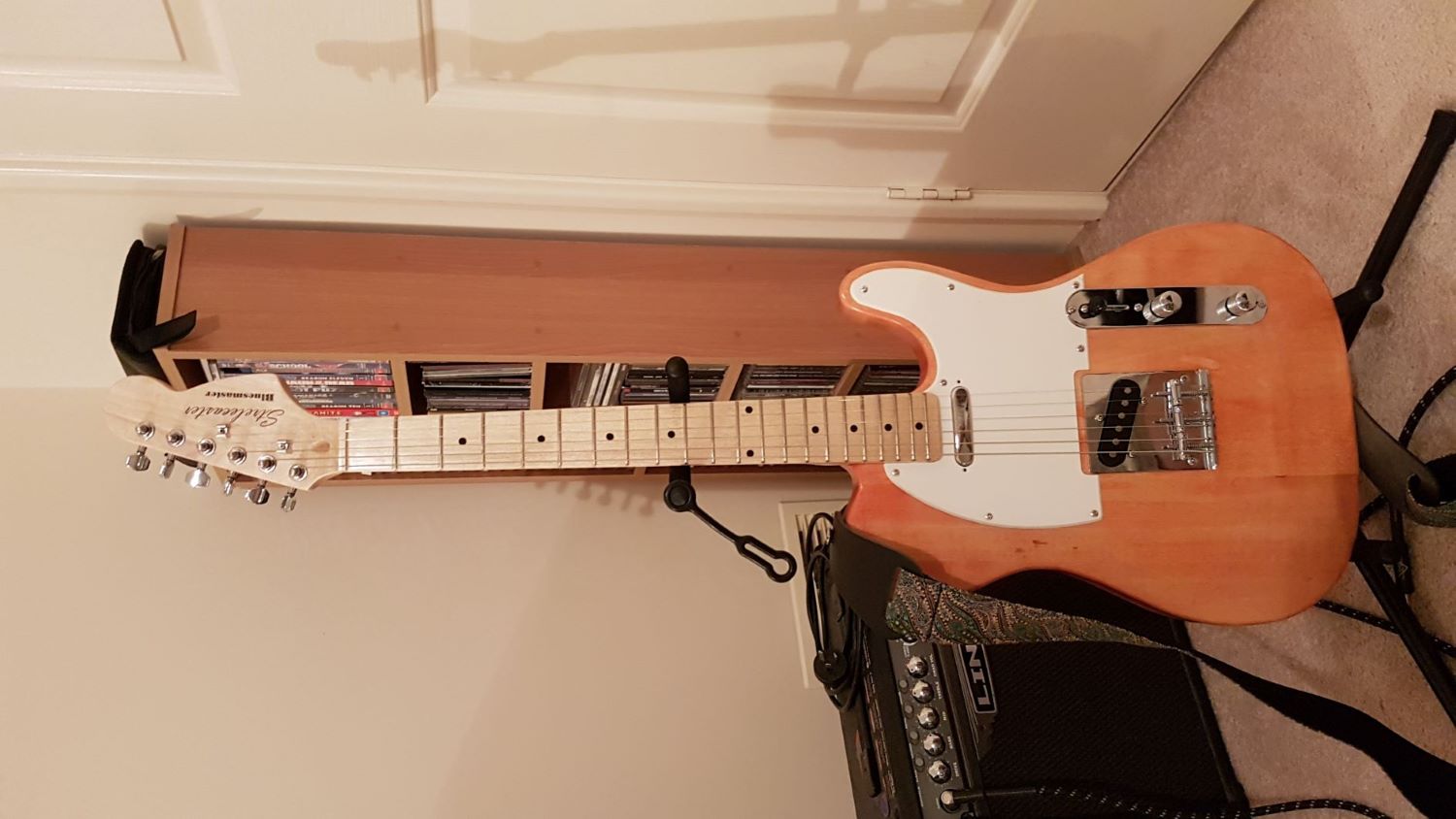

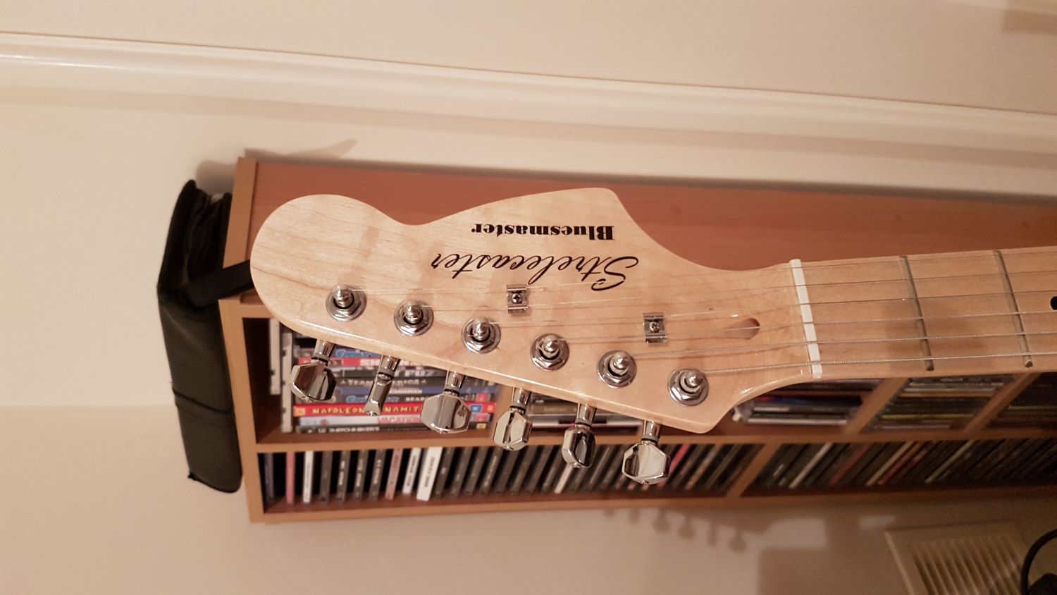

    My first TL-1 build... Tele body, Strat headstock (sorry to the traditionalists, but have never liked Tele headstocks) so the name Strelecaster seemed appropriate... this was great fun and three generations of the family had a hand in finishing it. Stain is Dingotone Bushfire Sunrise. Above all I wanted to know if it was possible and it was (with a $50 local guitar tech setup for intonation and action).

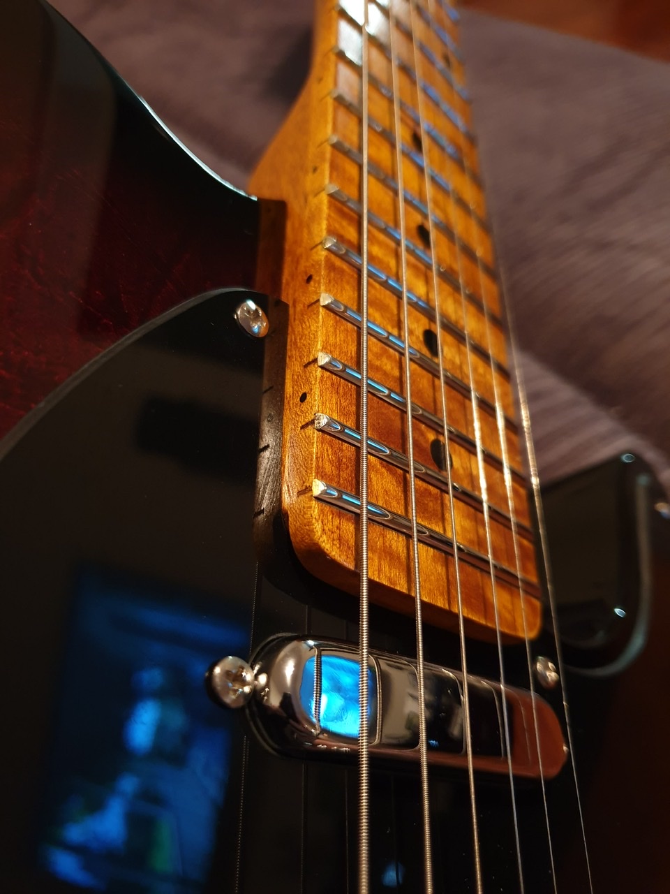

    TL1 Finished all stock

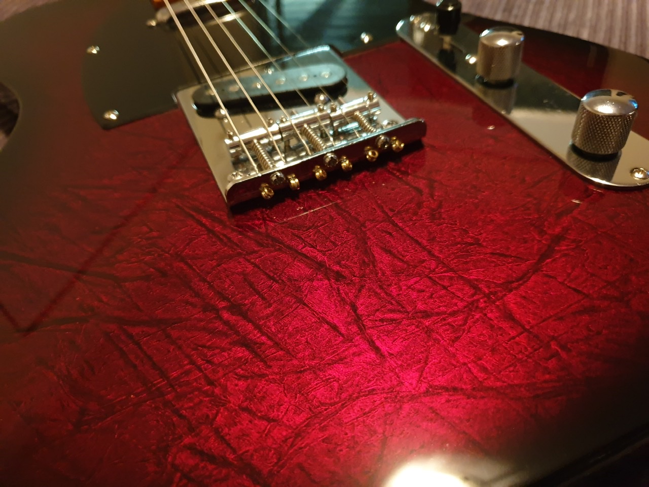

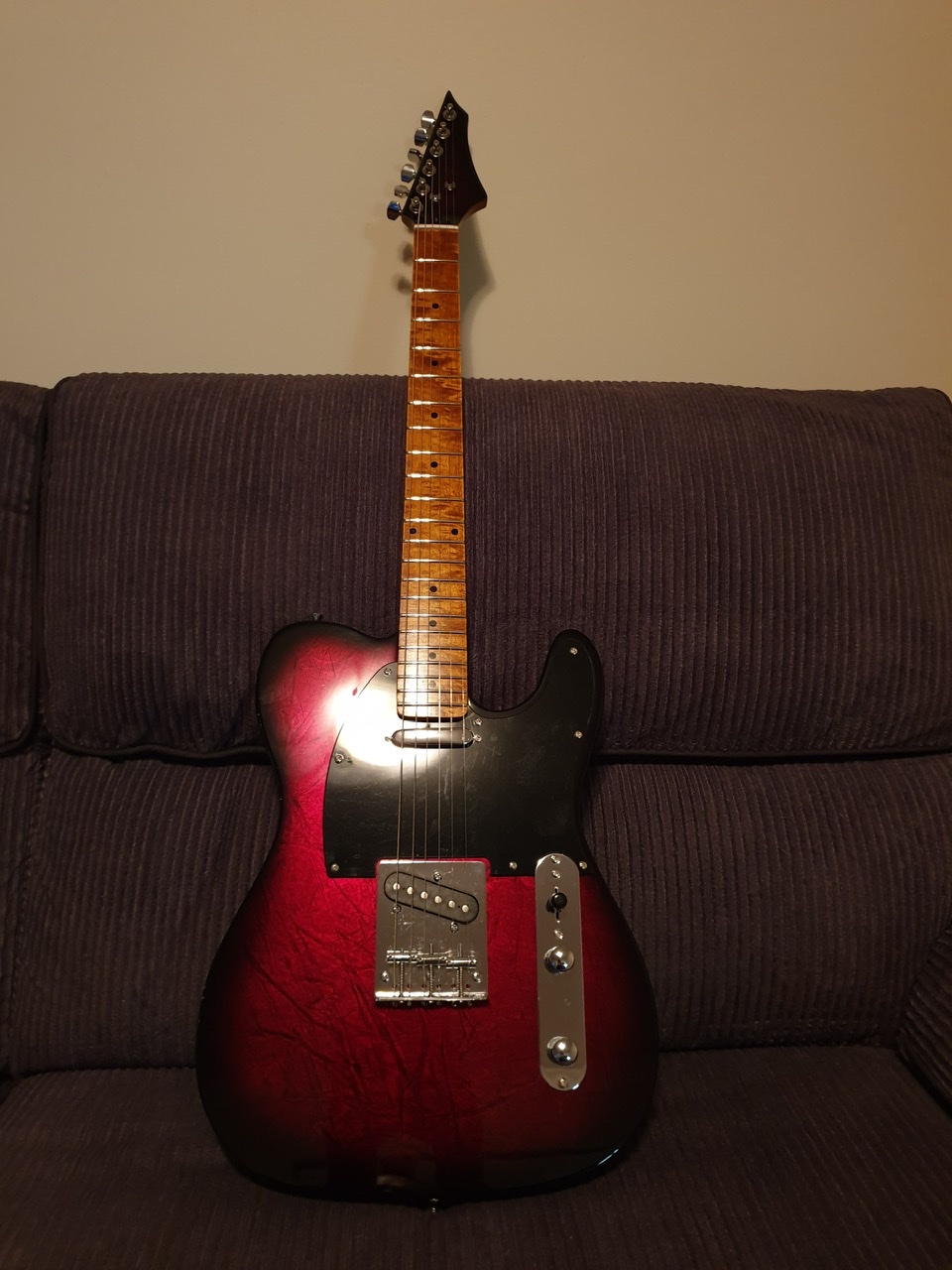

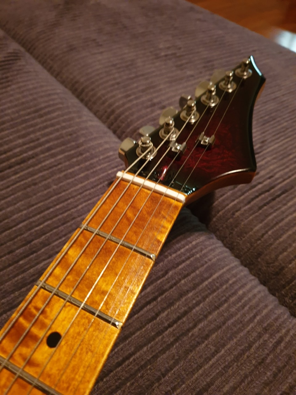

    My first build custom painted by myself in blood red candy marble effect with a black fade, neck stained with golden teak stain and finished with tru oil.

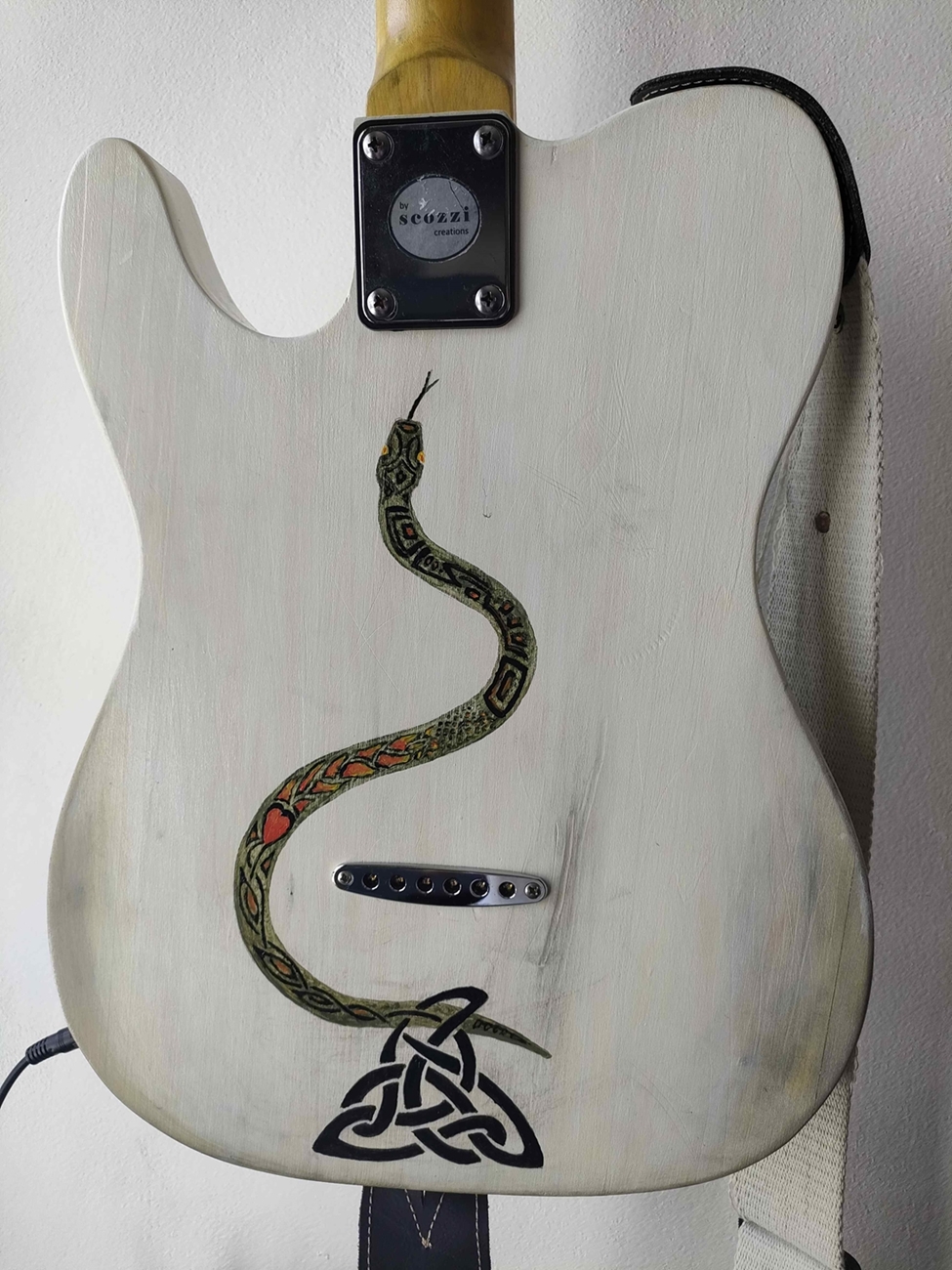

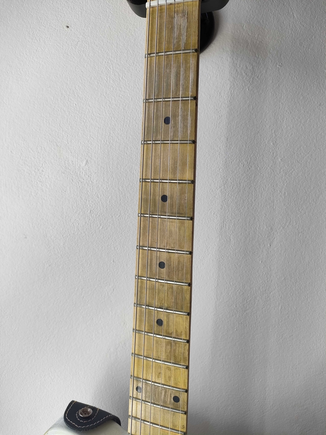

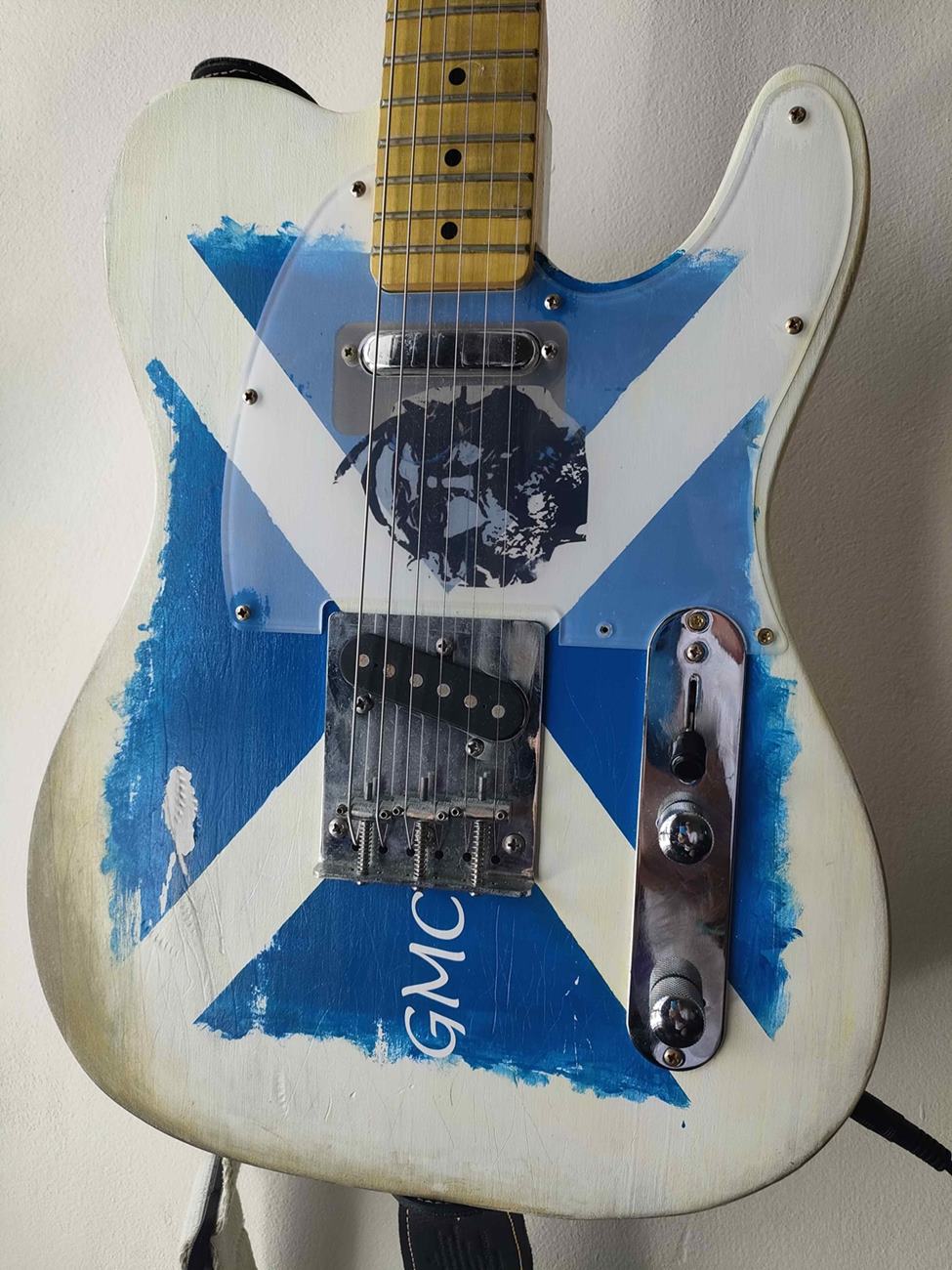

    This T-style, called "Brave Heart", was hand-painted on the body, using acrylic paints. The knot and snake patterns on the back were hand-painted, combining Celtic and Australian motifs from my life-journey. The Scottish flag is also painted in acrylic. On the clear pickguard, the image of William Wallace is reverse-printed to clear label material from a photo image, then applied to the reverse side. The body, neck and headstock were sealed with multi-layer guns stock oil, then the whole guitar was heavily reliced, using sandpaper, a beer bottle (to hammer sections), and graphite dust to darken. The guitar is converted to a string-through bridge.

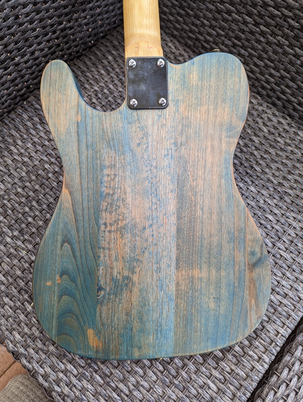

    Stained blue with kids acryllic paint, then dingotone clear stain set over the front and the blue (also used on the neck).
    Tonerider alnico 2's and then basically 2 on of switches (1 for each pickup) with associated volume.
    "Gold" leaf on the front of the headstock, which I have found develops an interesting patina as the guitar ages,

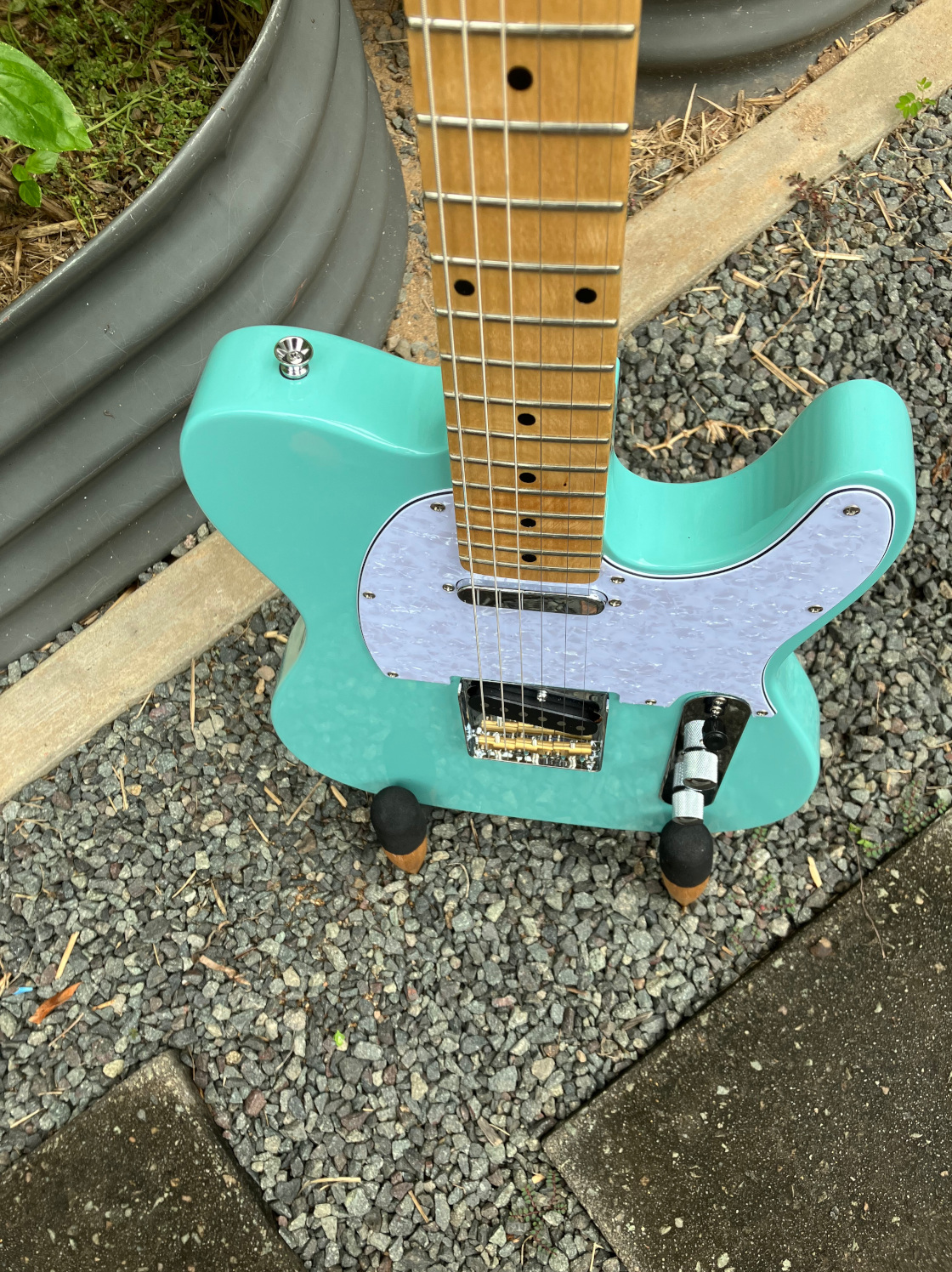

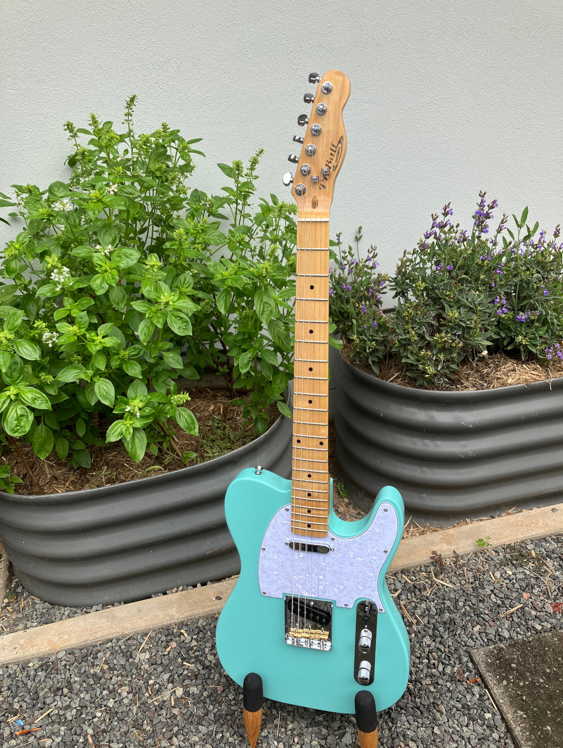

    My first ever kit build: a Pitbull TL-1. I was going for a seafoam green look using Montana MTN94 acrylic paint (matt) with a Montana 2K varnish clear coat. The maple neck and fingerboard were finished with multiple coats of TruOil with no stain. The pickguard needed to be trimmed to fit (I went a bit overboard trimming around the control plate but I plan to redo it at a later date!). Nonetheless, I'm still happy with the final result (it sounds good too!)
    Extras:
    - Wilkinson bridge
    - Grover 406c tuners
    - Bootstrap Extra Crispy pickup set
    - Bone nut
    - White pearloid pickguard
