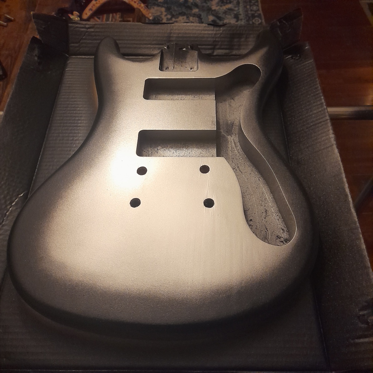

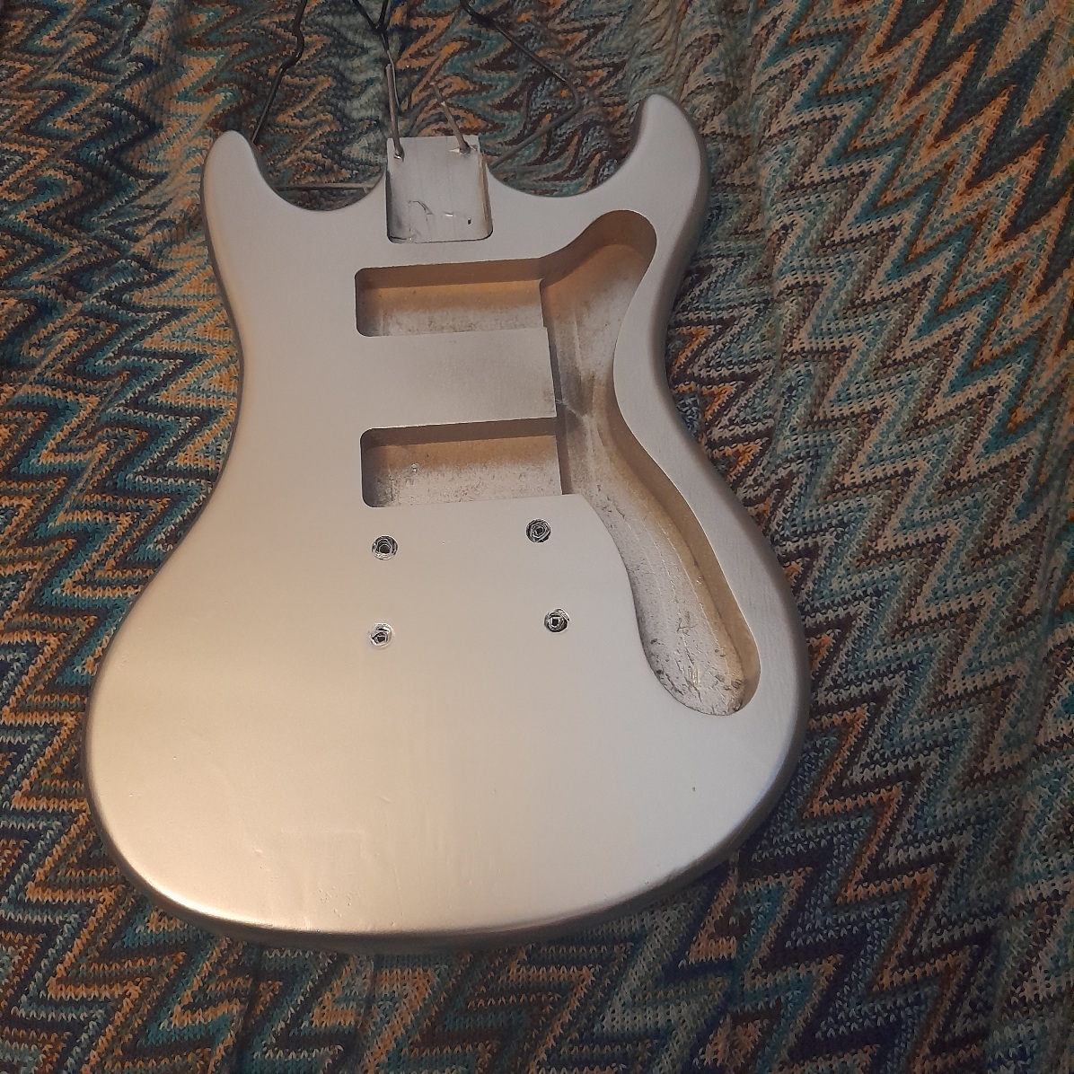

ID:	44540Its been a week of priming sanding of spraying and I'm close to the result I was looking for.I decided to go with a silverburst.

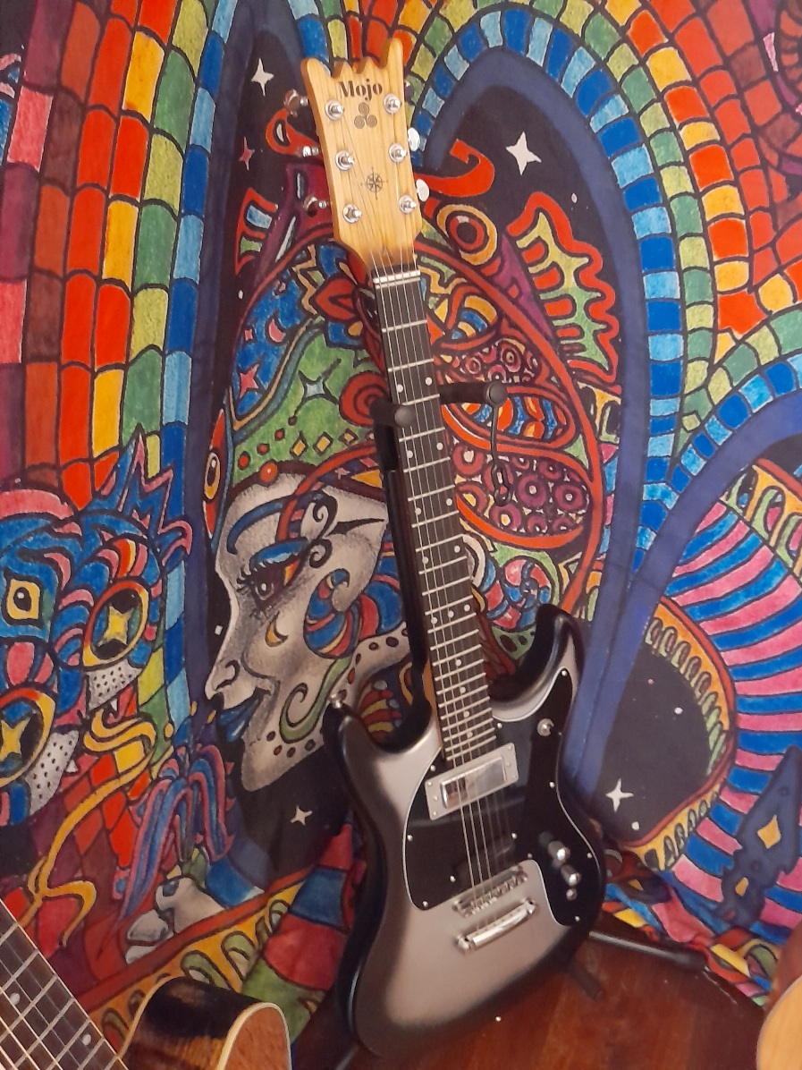

ID:	44560all stock apart from Grover tuners and a hotrail humbucker in the bridge.I wasn't interested in doing a Johnny Ramone white copy,I wanted it to be it's own guitar.Pretty happy with the outcome.
