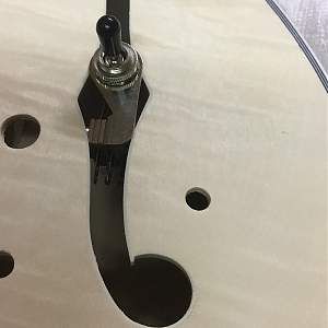

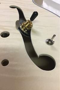

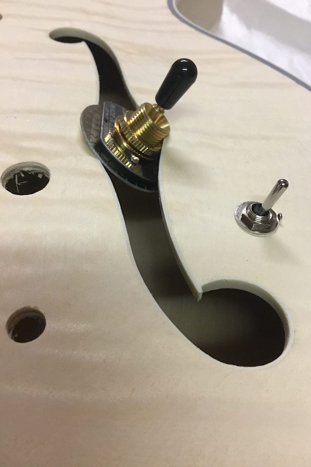

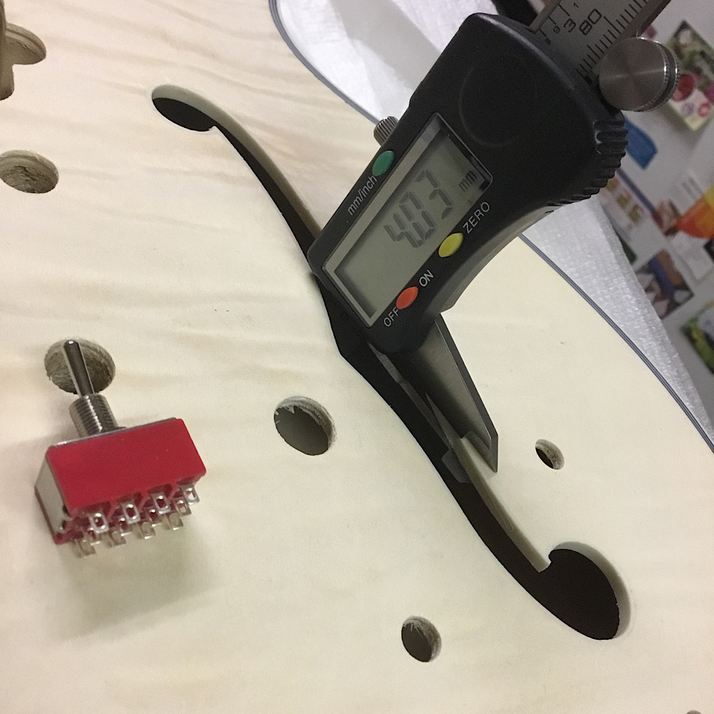

    A parallel/series in/out phase set of options would normally be perfect for the Free-Way Ultra switch. It’s a two row 3-way, giving you 6 positions, which would do everything you want all in a single switch… but currently costs more than the price of a small moon. And, while it is a very shallow switch, it has a huge diameter. So, probably fortunately, there’s no way to manoeuvre it in through the f-hole (see below) and would therefore require cutting an access hole in the back of the body. A ‘standard’ Free-Way *may* be able to squeeze through the f-hole, but (from memory) I don’t think it can provide all the options you want.
    The good news is those mini-switches have just enough thread to mount through the top. They are listed as 8.9mm thread which matches mine, and look identical. When I test mounted mine on a spare ES I left the base nut on and that sat inside the pot hole that I used, and there was room for the flat washer and nut (but I didn’t use the grab washer). The top’s thickness on mine is ~4mm, but with finish could be a little more.
ID:	44551Click image for larger version.
    Having a ‘phase’ push/pull in combination with the 4PDT mini-switch would work as you want. The mini toggle would give you series ‘out of phase’ and with the push/pull up you would have series ‘in phase’ ( or ‘out-of out-of phase’). And, the push/pull by itself allows parallel ‘out of phase’. The caveats being the 4PDT can only do its thing in combination with a Switchcraft style 3-way toggle switch where the two output lugs can be separated. And, this is still going to be a challenging layout to wire and solder… and a nightmare to fit through the f-hole and mount.
    I’ll draw up a layout in the next few days.
    Note that the second of those switches requires you to pull up on the switch first before it can be moved to the other position. It saves it being knocked by accident, but if you use it live, then it might not make for the smoothest of selections, especially if you have sweaty hands.
    Also, you’ll probably want the switch to operate in either a vertical or horizontal mode. Which means that it needs to go within easy reach of the F-hole so you can hold it in the right position whilst you tighten the nut up. A stiff wiring harness may keep it in place, but it makes getting it through the F-hole harder and if you are like me, you won’t want it operating at a slight angle.

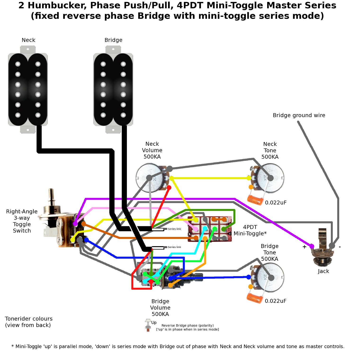

    Ok, one with everything...
    The push/pull pot swaps the polarity (phase) of the Bridge pickup, and the output from that then feeds the 4PDT mini-toggle.
    With the mini-toggle 'up' everything works as normal:
    Bridge volume and Tone, Neck volume and tone all work as expected, and the 3-way Toggle gives you Bridge, Bridge + Neck parallel, Neck. Pulling the push/pull up changes that to 'Bridge (out of Phase) + Neck parallel' in the middle position.
    Mini-Toggle 'down' switches to series mode, and changes several things:
    1. The Bridge volume and tone are disconnected from the circuit.
    2. The Bridge polarity (phase) gets reversed, putting it out of phase with the Neck. However, if the push/pull is 'up' then it gets reversed twice, putting it back in phase.
    3. The Bridge pickup is linked in series with the Neck pickup.
    4. The Neck volume and tone are connected directly to the output, ignoring the setting of the 3-way toggle switch, and act as master controls.
    This configuration relies on the separate output lugs of the Switchcraft style toggle switch to enable the 4PDT switch to make all the changes. It wouldn't work with a standard kit box style 3-way.
    This is going to be a challenging layout to wire up, particularly in a way that you can fit through the f-hole of an ES kit. You may need get some 4/5-conductor shielded cable to make the connections from the push/pull to the mini-toggle and from the 3-way right-angle toggle to the mini-toggle, as there are 3 or 4 connections between each.
    The 'dark grey' wires on the diagram are the ground connections, and I tried to route them so that 'bundles' of wires will have a nearby ground point. But, how they actually get configured will depend on what type of wire you use and how you group everything to fit through the f-hole. The important part is that any 'dark grey dot' ground connection eventually connects to a ground point that leads to the jack(-). If you get what I mean.
    Good luck!

    Scott: Thank you so much for preparing this - it is perfect. I admit to being rather daunted by the amount of wiring, but after spending some time studying the diagram, you've made the routing clear very clear and clean. In fact, you could not have made this clearer and easier to follow. And it’s going to do precisely what I want I to achieve.
    Scott/Simon: I have three FINAL questions:
    1) Wire Choices. I’m proposing to use the following types of wire for this harness. Thoughts? Is there a better way?
    Vintage Cloth Wire with Braided Shield (and heatshrink over the top)
    • 1xground/1xactive between Neck Volume and Neck Tone
    • 1xground/1xactive between Bridge Volume and Bridge Tone
    • 1xground/1xactive between 3-way Toggle Switch and Jack
    • 1xground/1xactive between 3-way Toggle Switch and Bridge Volume
    Shielded 4 Conductor Pickup Wire
    • 1xground/3xactive between 4PDT and Bridge Volume
    • 3xactive between 4PDT and 3-way Toggle Switch
    Vintage Cloth Wire OR Vintage Cloth Wire with Braided Shield (and heatshrink over the top)
    • 1xactive between 4PDT and Neck Volume
    • 1xground between 3-way Toggle Switch and Neck Volume
    PVC Insulated Wire
    • 1xground between Jack and Bridge (Ground)
    • 6 small connections (active/ground) within the 4PDT and Bridge/Neck Volume
    2) Shielding. Do pickup cavities require shielding?
    3) Grounding. I’m installing a bigsby (style) tremolo with Tonepros Roller Bridge. I’m assuming I can still ground to the bridge, or will I need to drill a hole through to the end of the body and ground to the bigsby?
    Thanks both for your ongoing assistance. Hopefully this will all be of use for others, too.
    Mathew.
  7. #17
    Easy stuff first.
    2) Have you got covered or uncovered pickups?
    If covered, then no, shielding is not required as they are enclosed in a grounded metal case and so are already shielded. You can shield the pickup cavities if you want to, it won’t do any harm, but you’ll need to run ground wires to each cavity, adding to the wiring count and you might want to think about widening the pickup cavity to control cavity holes slightly to make it easy to get the cables in and out.
    If uncovered, then the single coil modes of each pickup could benefit from shielded cavities. Wiring notes above apply. But you’ve got a lot of wiring to fit in already and it’s very easy for wires to get tangled round pots when stuffing them in the F-hole and restricting movement and maybe requiring the harness to come out again to be sorted.
    Before I put covers on them, The BK Mules in my Jimmy Page LP worked quite happily in single coil mode without shielded pickup cavities.
    3) Grounding the bridge as standard is all that’s required.

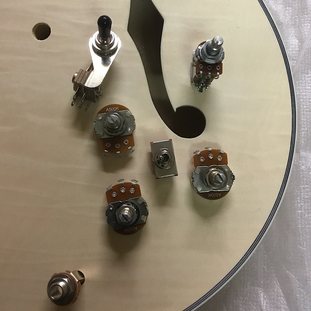

  9. #19
    Everything that Simon has said ++. Care and planning will often be the difference between getting the wiring working and installed and something getting smashed.
    A lot of images incoming, so probably multiple posts…

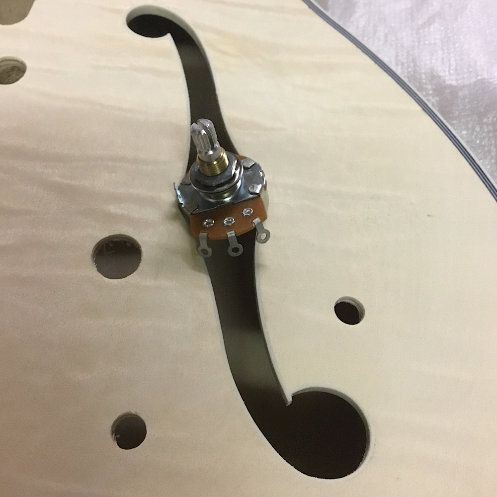

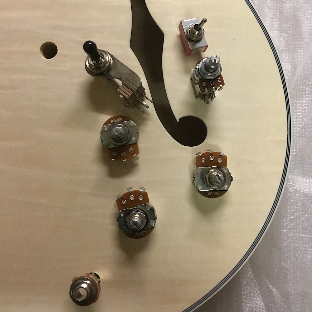

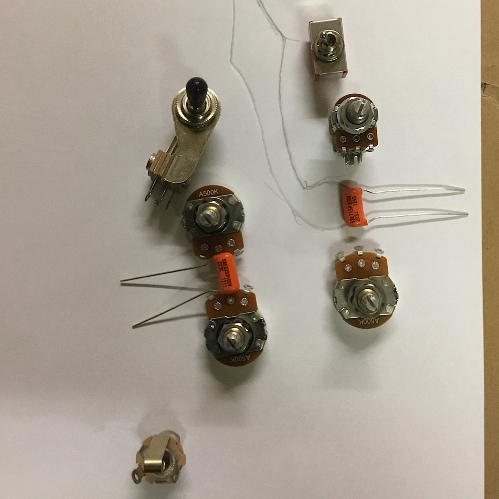

    First, I’d get some paper and make a rubbing of the holes, including the f-hole, and use that to cut your cardboard template. Then it’s time to work out where you want your mini-toggle and how you want the parts oriented to each other.
ID:	44568Click image for larger version.
ID:	44570Click image for larger version.
    The right-angle 3-way is a big switch, but you most likely still want it oriented towards the pots. That means either pointed towards the f-hole or pointed up above the neck volume. If it’s the latter, then you need to check there will be enough clearance from the centre-block in the body to accommodate the switch and multiple wire attachments. Also, if you’re connecting your bridge ground wire from the bridge post then it’s going to be easier to go to the 3-way’s ground point, rather than the jack in my diagram.
    Once you have decided on positions and orientations, you then need to think about the other components and wires routes.
    As Simon stated, caps as the link between pots can be ideal and eliminate a wire link. But, they can also make things more difficult with how they need to be positioned, particularly when it comes to finagling the harness in through the f-hole.
    The position of the components will affect how you need to route your wiring and which wire(s) would work best (and exposed in the f-hole or completely hidden). Sometimes you want a stiff harness, other times it needs to be more flexible. In the above configuration you may want a ‘U’ shaped wiring pattern that runs from the jack across the neck tone to neck volume to 3-way, then a loop back down that route then across to the bridge tone, bridge volume and mini-toggle. Using braid from the jack up to the 3-way, then a combo of braid and multi-core for the loop down and across to the bridge controls and mini-switch could be a viable option. The pickup leads length also comes into play, especially if you need to extend them, and where and how you want to attach them to the harness. And, will the harness be partially of fully inside the body at the time.
    And…

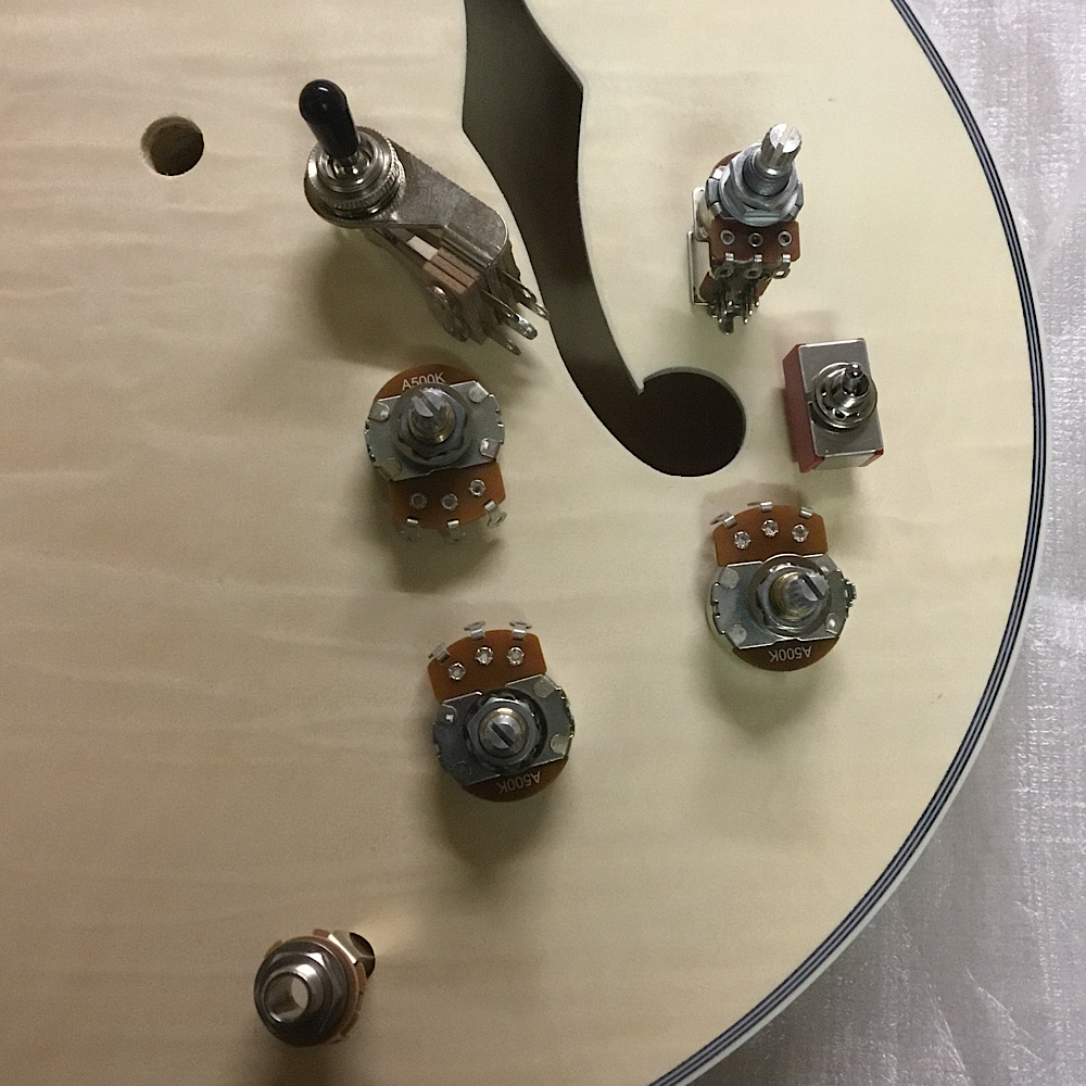

  10. #20

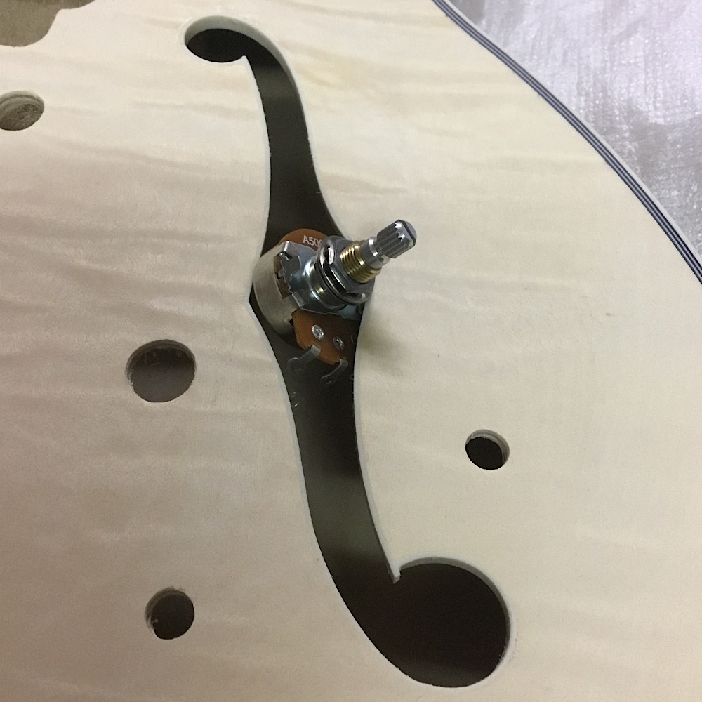

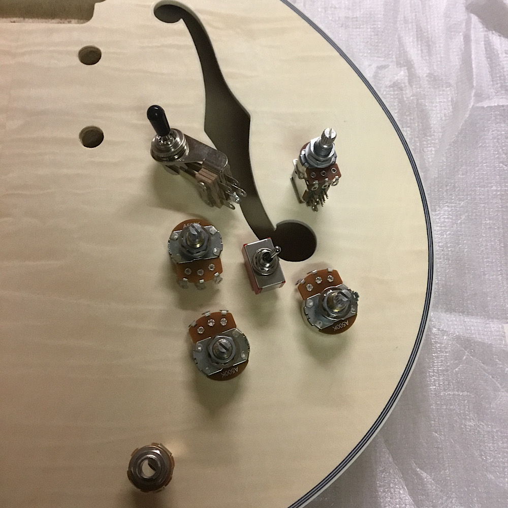

    … you also need to consider how you will need to manipulate the components to get them through the f-hole once everything is connected. The jack, push/pull and mini-toggle will all fit through the f-hole easily but once wires are attached it can become more tricky.
    The right-angle 3-way needs to have one end in first then slide forward insert the other end. Which will be much more difficult with half-a dozen wires of various thickness attached. Possibly the most difficult will be the full-sized pots. They can’t go straight through and instead have to be inserted at an angle. This is where the position and way the caps are attached can make a difference, plus all the other wires and ground connections hanging off them. Challenging to say the least.
ID:	44575Click image for larger version.
ID:	44573Click image for larger version.
    The more you can work out these issues, and even test them, before you fully commit to the full harness the more likely it will succeed.
    First step, work out where you want everything and then we can all weigh in on the best way to achieve it.
