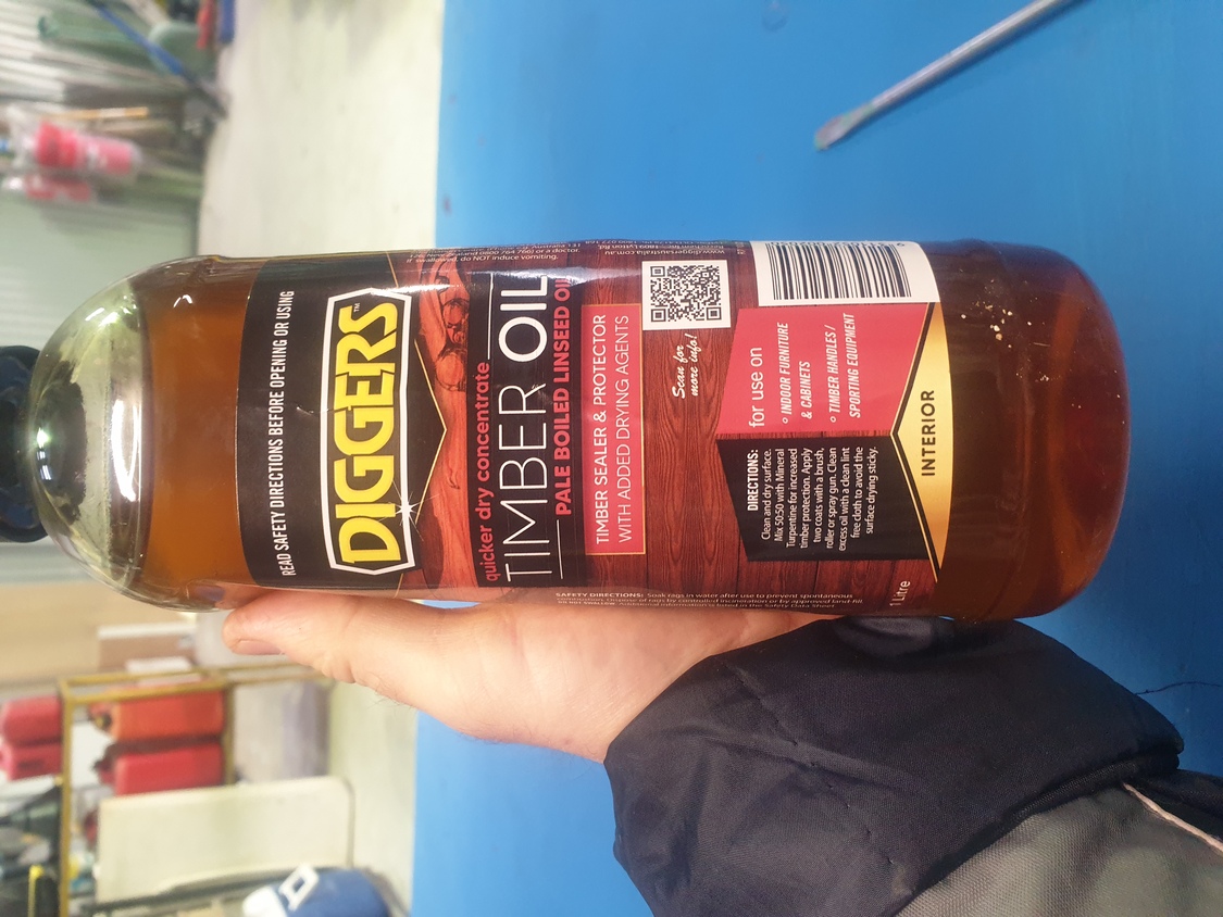

    WOW that sure is a lot of words mate
    Sounds like youve got a shit load of experience building guitars. And yes whenever something has a lot of hype around it i get skeptical , i kind of decided i woukd use only locally available , affordable materials in this project , so instead of ordering 100ml of tru oil for like $50 i went to my local BunningsAND BOUGHT THIS TO TRY
    it seems to have similar ingredients to tru oil except the proce is $19 for a litre
    Main ingredient is boiles linseed oil and a solvent like turpentine to help it penetrate and dry faster
    I will use this and report back on if its good or not
    Might be a great alternative for others in future
