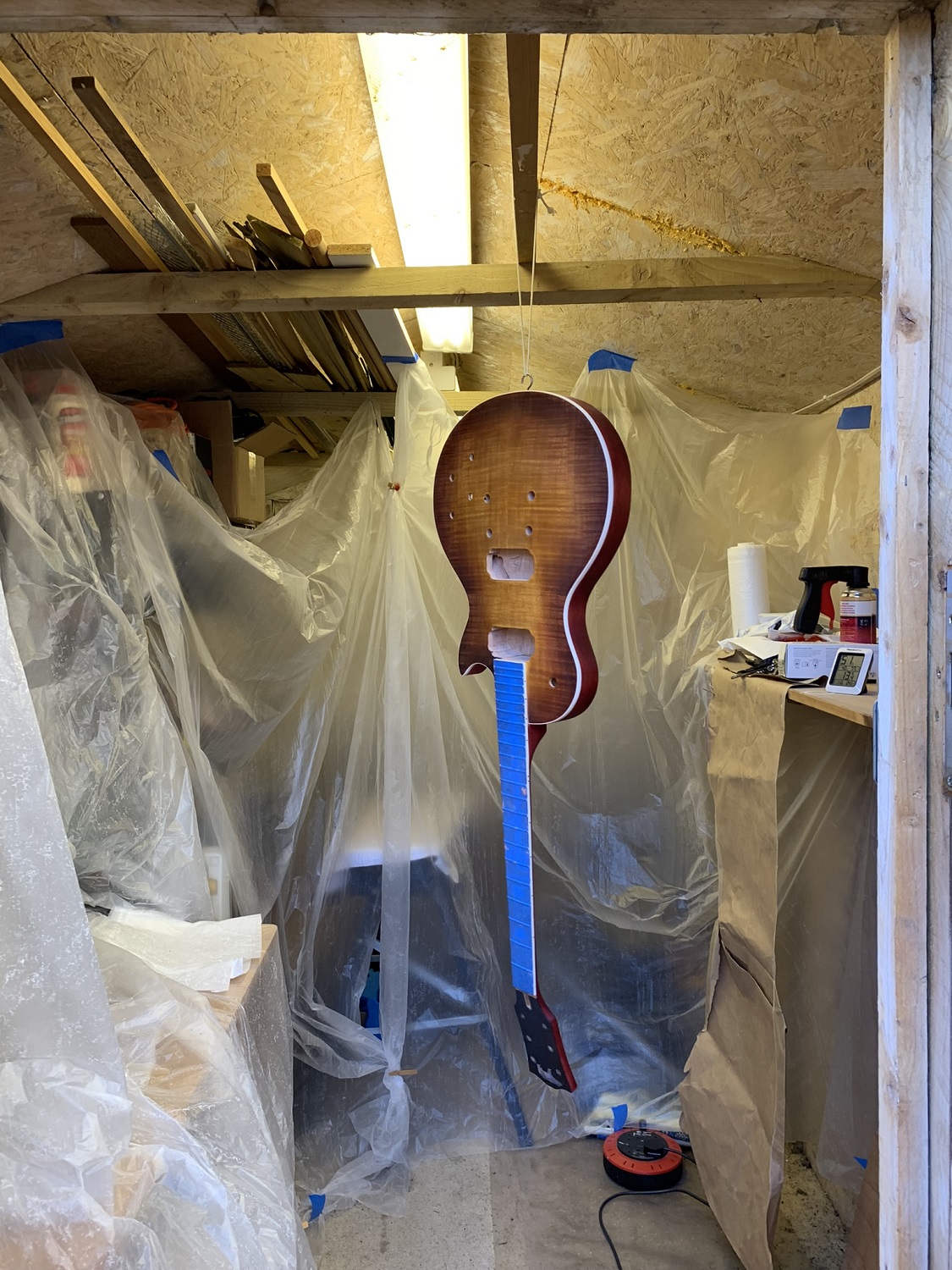

    Today I manned up to spraying - I've been apprehensive about doing it so found lots of reasons to put it off.
    Last night I hung up some plastic in the shed and moved out anything I definitely didn't want overspray on. This morning I was up bright and early rewatching the YT vids before making a start.
    My routine was to heat the shed to about 20C whilst the can was heating in some warm water. Then suited up and shook up the can for 2 mins. Against Simon's advice I sprayed with the door wide open and then shut it immediately after spraying. Despite having a respirator, goggles, gloves and suit, I was super conscious to give myself as much ventilation as possible. The door stayed shut for five minutes and then open again for 30 mins to an hour.
    Following this pattern I got 5 coats of sanding sealer on before the sun started to go down and I reckon another 3 coats tomorrow should do it. My plan is then to leave it until I get another calm sunny day before spraying the top coats. In the meantime I'll sand any rough areas - 1200 wet sand, sound about right?
    The spraying seemed to go okay - I tried to remember all the things I'd learnt here and from the YT vids. But as with doing anything for the first time, I'm sure mistakes have been made that I won't find out about until much further down the line.
    Here's my setup in the shed taken before coat 3 - The plastic has fallen down a bit in that shot but I fixed that back up:

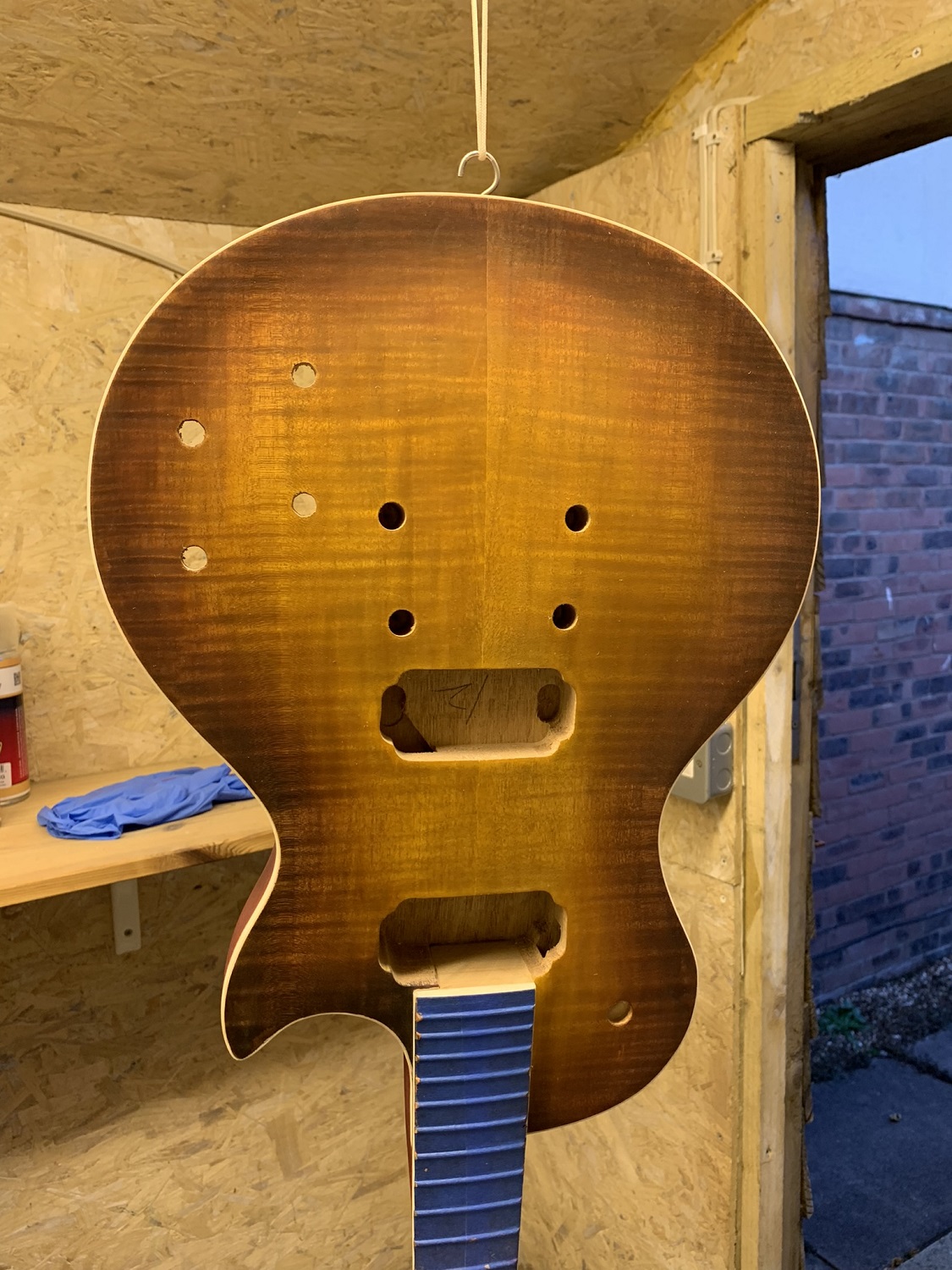

    Ive wet sanded the sealer with 1000 and it feels lovely
    One thing though - on the back, in one small area it seemed to blister. I’m guessing this is a temperature or humidity related issue perhaps? Moisture under the sealer?
    If that’s the case then its made me think again about spraying the gloss until the gods bless us with better conditions.
    For the time being Ive restained it and I guess I can reseal it? Or can I just spray the clear over the top?
    Here’s the top with its sanding sealer lushness.

    Blistering normally a reaction to something on the surface, though I have had bubbles in the finish because I’m sure it got too hot in direct sunlight in the summer. Although it’s still relatively mild here I doubt it’s due to excessive heat. So I would suspect something hot onto the wood. Humidity can cause clouding of the finish but not blistering.
    I’d like to be more technical but sometimes things like this just seem to happen and without a full chemical analysis of the surface, you’ll probably never know just why.
  9. #18
    You can spray the clear without putting on more sanding sealer, but it’s going to sink in a lot more on that patch. You’ll just need more coats on that area.
