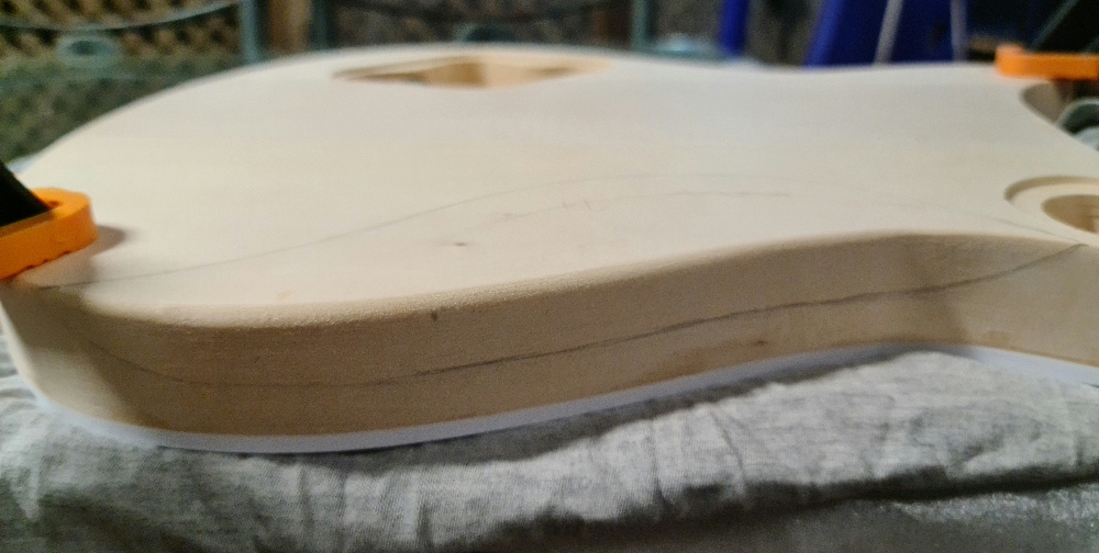

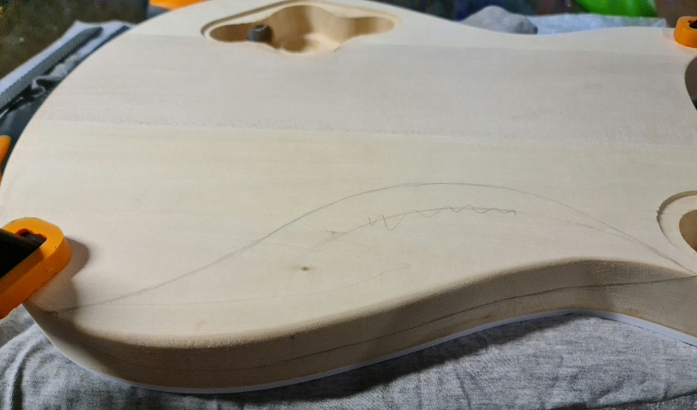

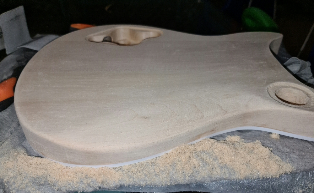

    Then started prep work on body. I drew approx shape I wanted for belly curve and started shaping.

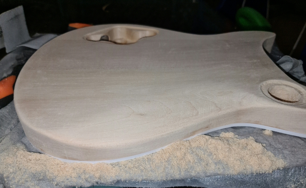

    This process was kinda scary being a first timer. But I got alot of satisfaction from the outcome. It was exactly what I set out to achieve. Which was to remove alot of material and still have it look subtle. And have the whole thing flow with the curves of the body shape.
    BeforeClick image for larger version.
    Marked outClick image for larger version.
    Finished and sanded with 80gritClick image for larger version.
    As it stands right now, I'm making my way into finer grits on the back of the body. And hoping to have it finished ready for stain shortly. And hoping to get stain done tonight.
    Was just excited to get it going and share my progress. Thoughts and suggestions as always are appreciated. Cheers guys

    If you're open to suggestions, and while you're still in the pre-finish stages, I will say you should consider doing more shaping on the back around the neck join and lower horn, as well as the heel of the neck.
    The standard neck joint has quite a "stepped" transition from the body to the heel. Shaping/smoothing that transition will make a big difference in comfortably accessing the higher frets. It is one thing I regret not doing on my build. I ended up scalloping the front of my body (post-finished) and it made enough difference that I didn't take it any further, but in hindsight I would have done both before applying stain and finish.
    You can see my "scallop mod" HERE.

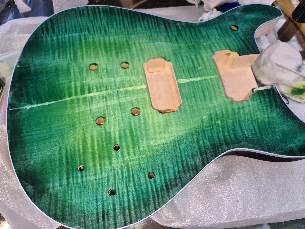

    Current situation is I need to make a trip to Office works to get some coloured markers.

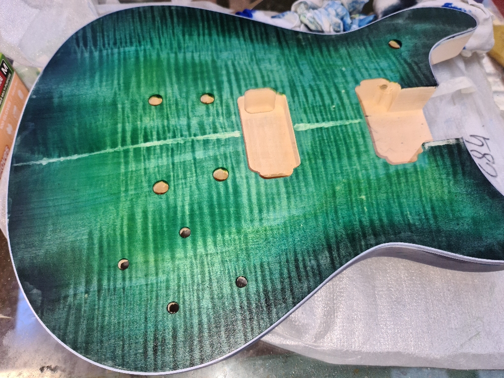

    No manner of cleaning fluid/adhesive remover budged the excess glue. Which means it's bleed through adhesive on the veneer.

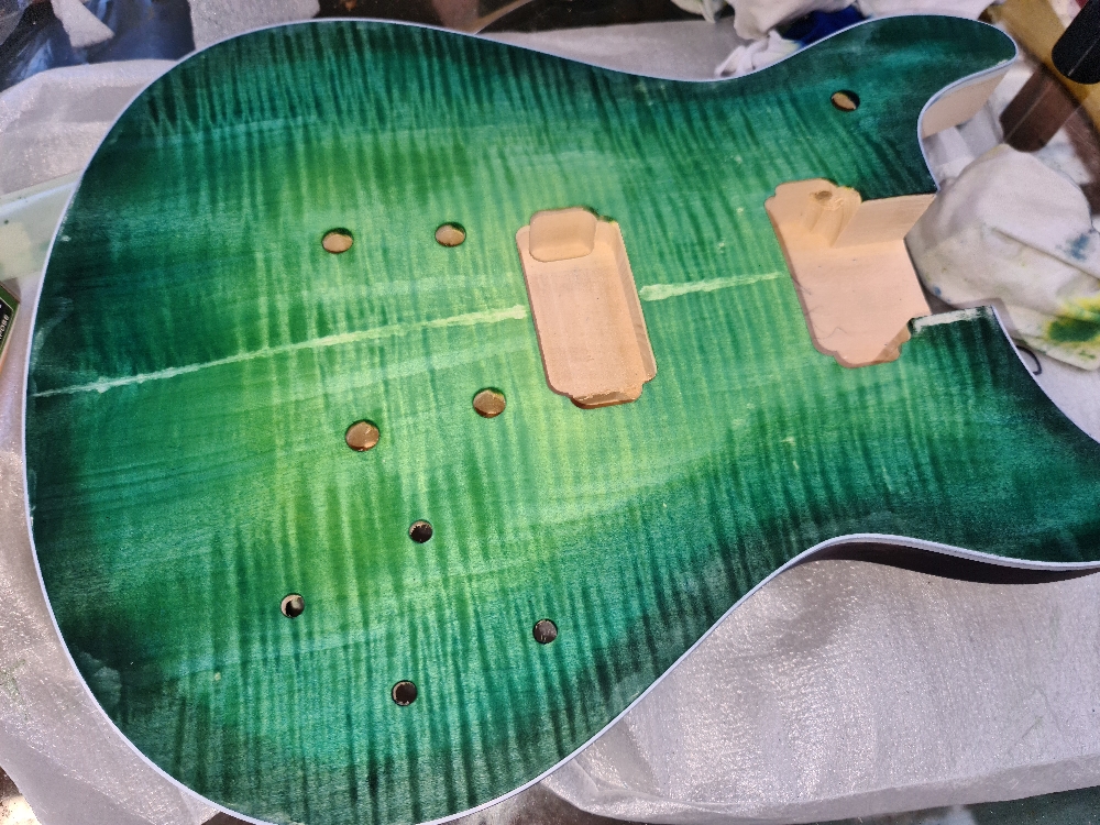

    So I have got the stain to a point I'm happy with, but will be using markers to touch up areas where glue prevented staining ( Mainly bottom edge, one side above top pick-up cavity/neck and the join down the middle )
    I had alot of fun layering the colours/blending.
    Mid way

    After/final
    Jeez, that's a shame about all the glue... you've done a really nice job with the burst.
  6. #16
    The majority of it I'll be able to hide with markers. But it is ALOT.
    I've already decided on my next maple top kit I'll be purchasing internationally to get a maple cap, not veneer.
    Just so much I wanna try my hand at with the staining that is impossible with such a thin veneer.
    Thats not to say I'm still not happy or having fun. Because On both fronts I am.

    I don't know whether it's the thin veneer or workmanship has just got to shit. There have been past issues with glue, but it's become significantly more common and more extensive in the past 3 or so years. I bought my PRS1-TS in 2018 and had some glue to contend with, but nothing like what I've seen builders contending with of late. It's just shocking IMO.
    You can see mine in the Photo Gallery and it has a nice even colour on the top.

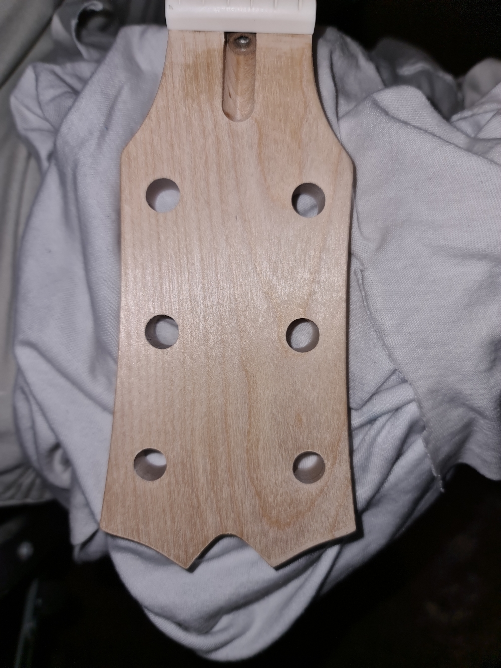

    Also as an update. I have roughed out my headstock shape. I looked at millions of templates online and decided to just freehand sketch what felt right and go with it.
    I'm more than happy with how it looks so far. Still a ton of sanding to go. But still progress

    Your burst looks great and I really like the shaping on your headstock.
