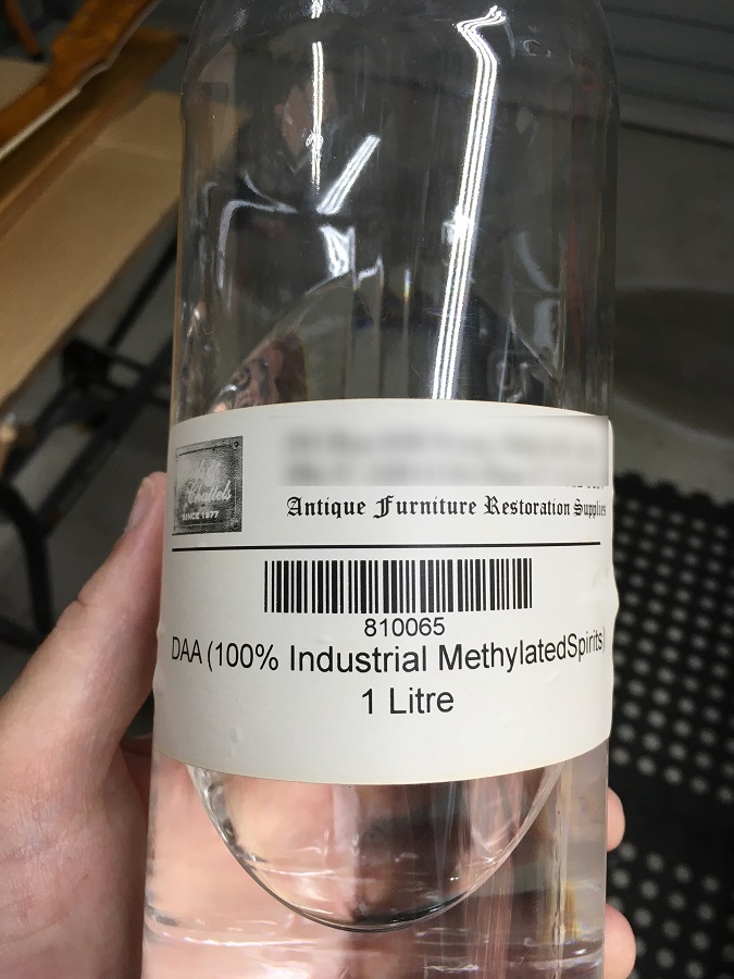

    When it comes to dissolving the flakes, you want to source methylated spirits that are "industrial" (100% Ethanol) not the 95% Diggers you'll get at the supermarket (or Bunnings).
    <rases hand> erm, NO! 100% ethanol is *not* mentholated in any way shape or form, and what you are probably thinking of is nenatured alcohol. Via diatillation 96% is the best you can manage.. 100% is harder to do and costs a lot of money and requires certain licesnces to obtain. Since you are using it for a coating rather than to drink, and you want to go the no water route you would go for dessicated denatured alcohol . from memory it's 95% ethanl and 5% methanol. We used to buy 20L drums for the lab.
    Sorry, I meant Methanol (aka methyl alcohol) not ethanol. What a difference 1 letter makes!
Name:	Metho 100 anon.jpg
    It's about $10 a litre, but it makes a noticeable difference in dissolving the flakes.

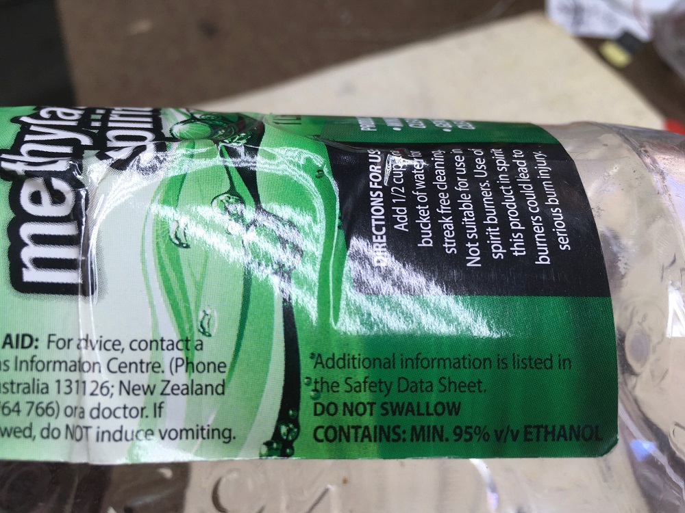

    Methylated Spirits in Australia IS what you in the US call Denatured Alcohol.
    I am not a chemist, and it seems I have managed to confuse myself (not hard to do these days) but I was correct the first time when I said Ethanol.
    This is Methylated Spirits which we use here, and the run-of-the mill 95% stuff you get at supermarkets and hardware stores:
    It clearly states 95% v/v Ethanol

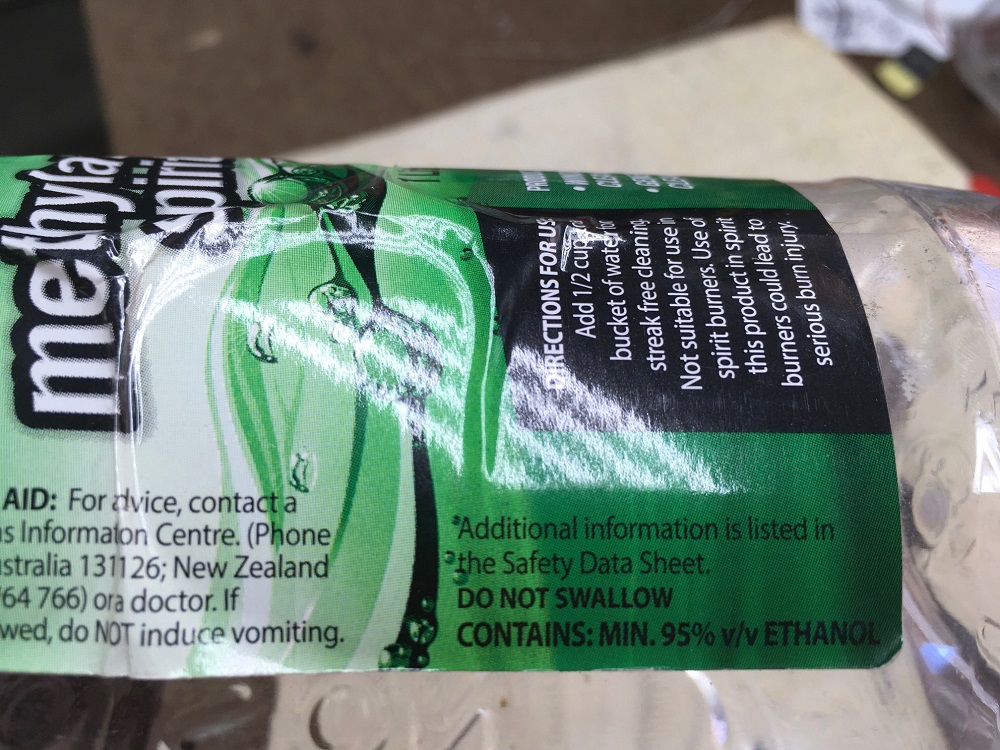

    Well, I *am* chemist, and in a laboratory metho in Australia is called denatured alcohol.The stuff you get from Bunnings will be 95% ethanol, some methanol, some water and some other trace amounts of crap to make it even more undrinkable than the methanol makes it... although I suspect for the purposes of using it to solubilise shellac it probably doesn't makes much difference. Unless you get desiccated denatured or absolute ethanol (that's 100% and *very* expensive) there will always be some water in the mix. lab or industrial grade (like the pic> will not have the extra impurities they add to metho, just etrhanol and methanol. by 100% methylated spirits that does *not* mean 100% ethanol, or it would not *be* methylated spirits :P. But yeh... the industrial stuff is probably better than the domestic stuff .
