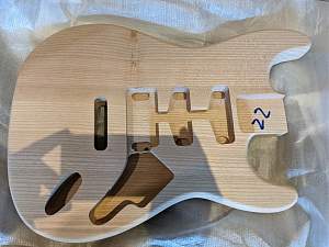

    Quick inspection shows the body in pretty good condition.

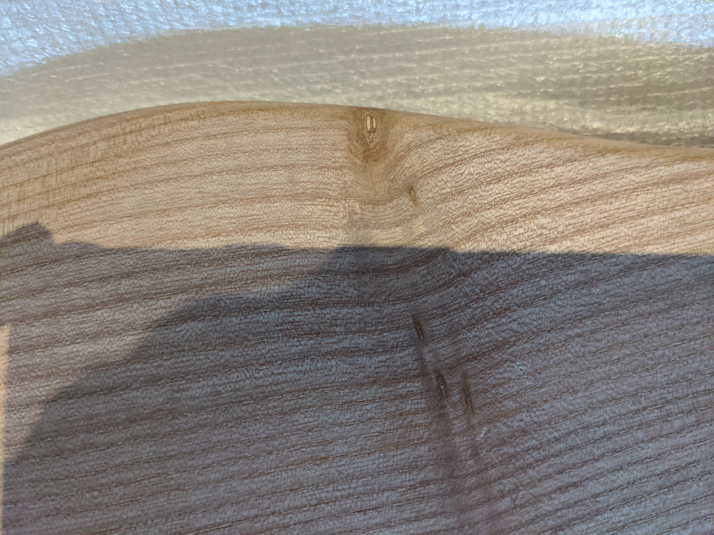

    This knot in the body is a bit ugly, but given the solid colours it shouldn't be an issue as long as I prep correctly.

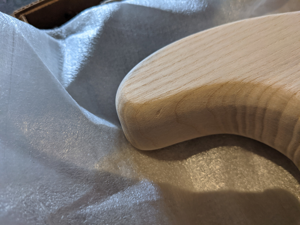

    This tiny ding on the horn should come out easily enough. That and a little nick around the edge of the humbucker route are the only bits of damage I could find so far.

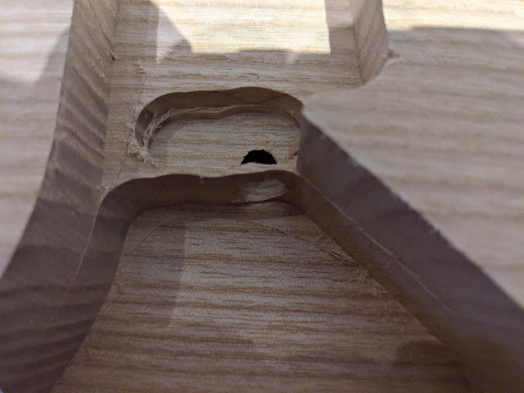

    Very thin bit of wood between the humbucker route and control cavity is probably normal but looks weird to me. Can't help but think it would be easier if it wasn't there at all. No such separation between a single coil version and the control cavity. It might get removed.

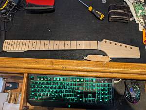

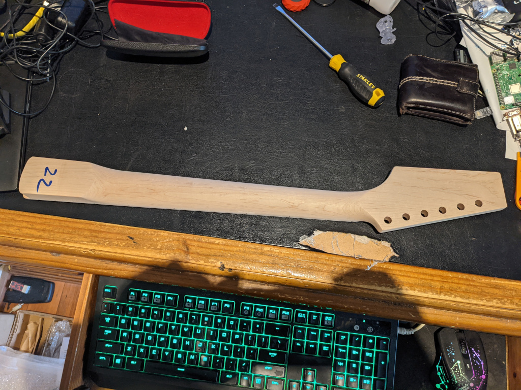

    Neck looks OK to me. Dots seem to be aligned. Not that my eyes are any good anyway.

    Btw the original guitar body was sold to EVH cheap as it had a flaw in it, an unsightly knot, so yours is perfect!
