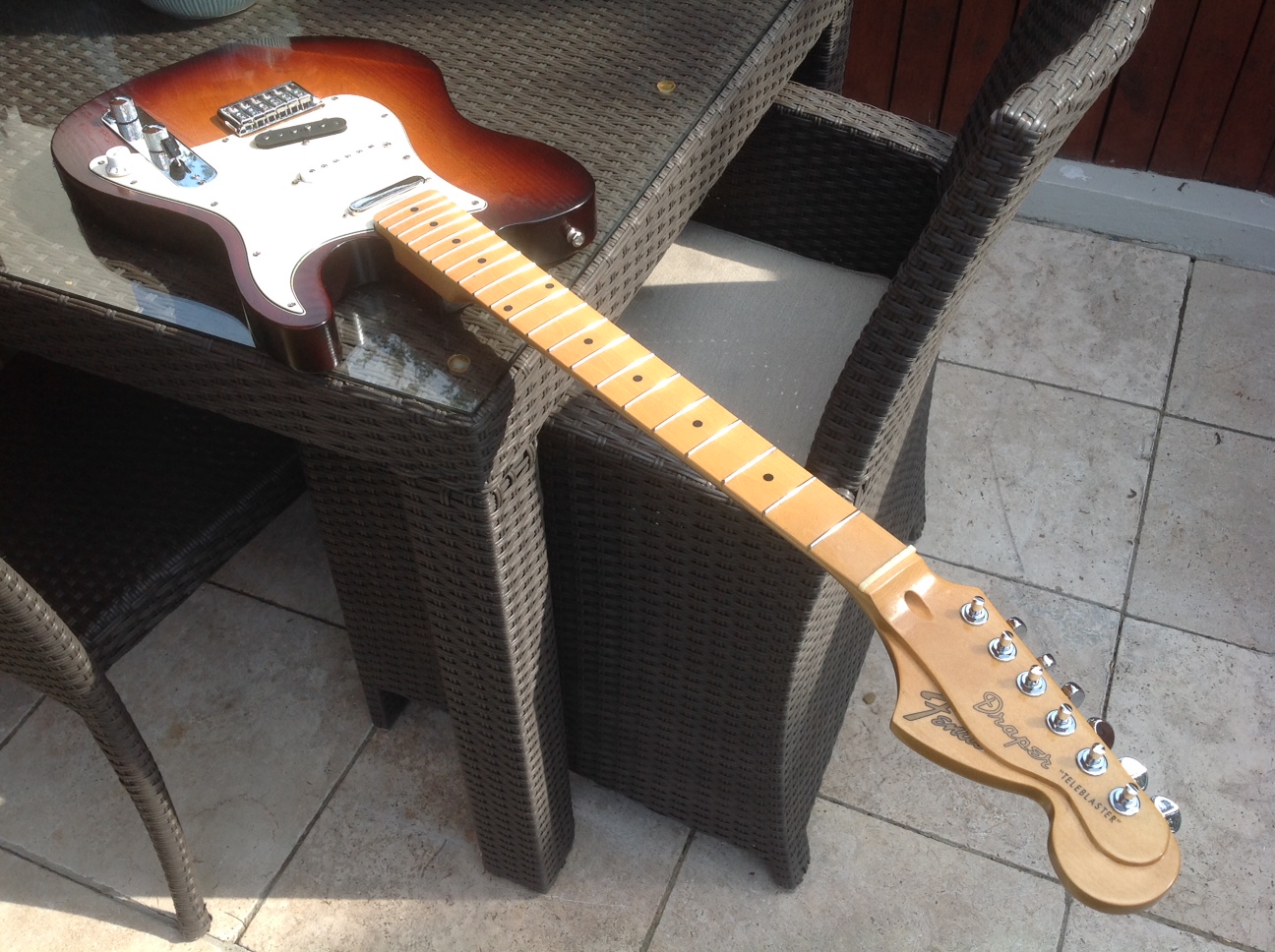

    Re the headstock, if you can't decide, just do both like I did on this one

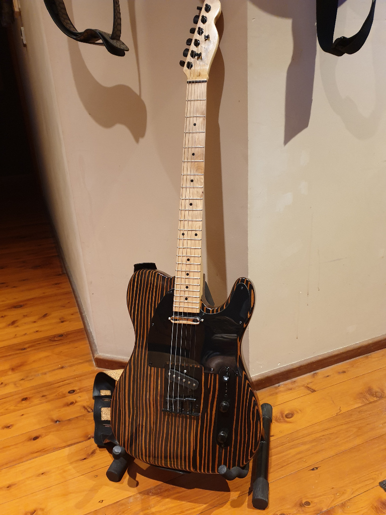

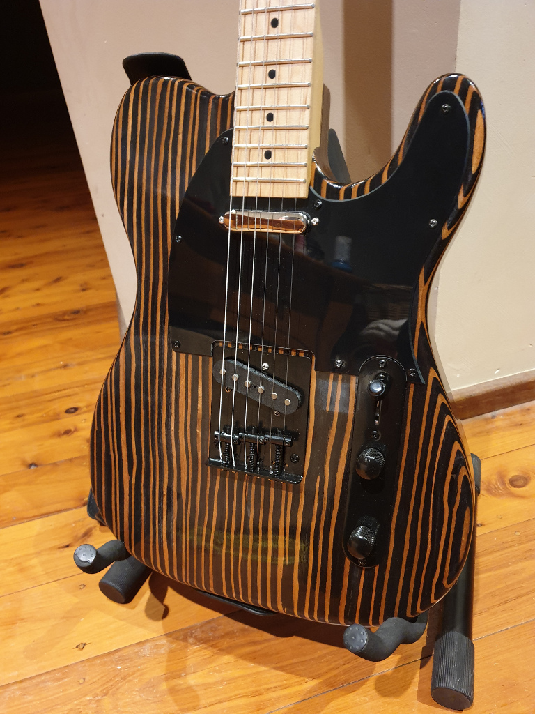

    As for the colour contrast with the black hardware, I did a zebra tele with a dark finish using black hardware and I kinda like it. Might not be everyone's cup of tea, however.

  10. #17
    Oh, and that tele was done with nothing but Tru-oil, since you were asking about finish options. It's not perfect - I've learnt a few things since that was built and should probably go back and do a bit more work on it. However, it's not terrible.

    That's a very sharp looking instrument, nice job. I like the modern black on the classic lines.
