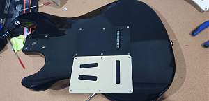

    It dawned on me yesterday that the back plate was still the white(ish).
    A quick measure and recreated in TinkerCAD then spat on out my 3D printer this morning. Fairly bogan spec - I didn't even plot the screw holes - I literally just clamped the original on top and drilled it. You can see the usual print pattern up close, but I don't care too much about that.
    At some point I'll pull it off, countersink it a bit and find some new screws that are a fraction bigger. The originals are loose.
    I considered replicating the cut outs that allow access to the screws holding in the claw for the trem, but I couldn't be bothered. Once I set that trem up, I probably won't change it.
    Now literally the only "Samick" bits left beyond the logo are the body, the bridge and the neck. No electronics, no covers.
    It'd be nice if the gear for the fretboard work would arrive next week so I can get on with that.

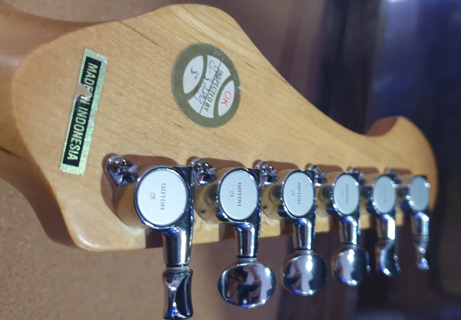

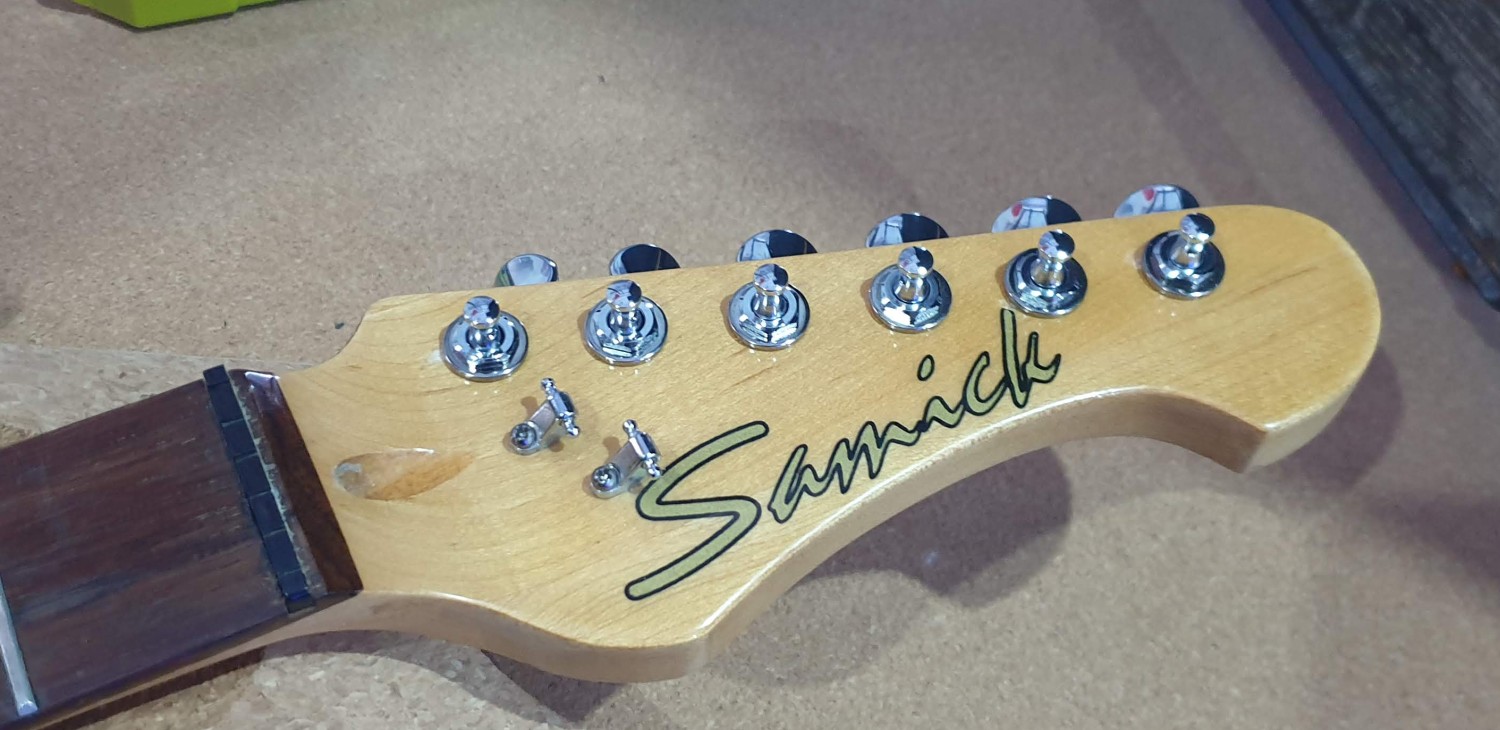

    New Gotoh machine heads arrived today. As did the new frets.. which are about .01mm narrower.. just enough look dicky, but I'll probably just use it for now anyway given I only need one.
    I've put the machine heads on. Frets will wait until I've got something that can pull the bad one out and some gear to get the replacement done and frets leveled and dressed.
