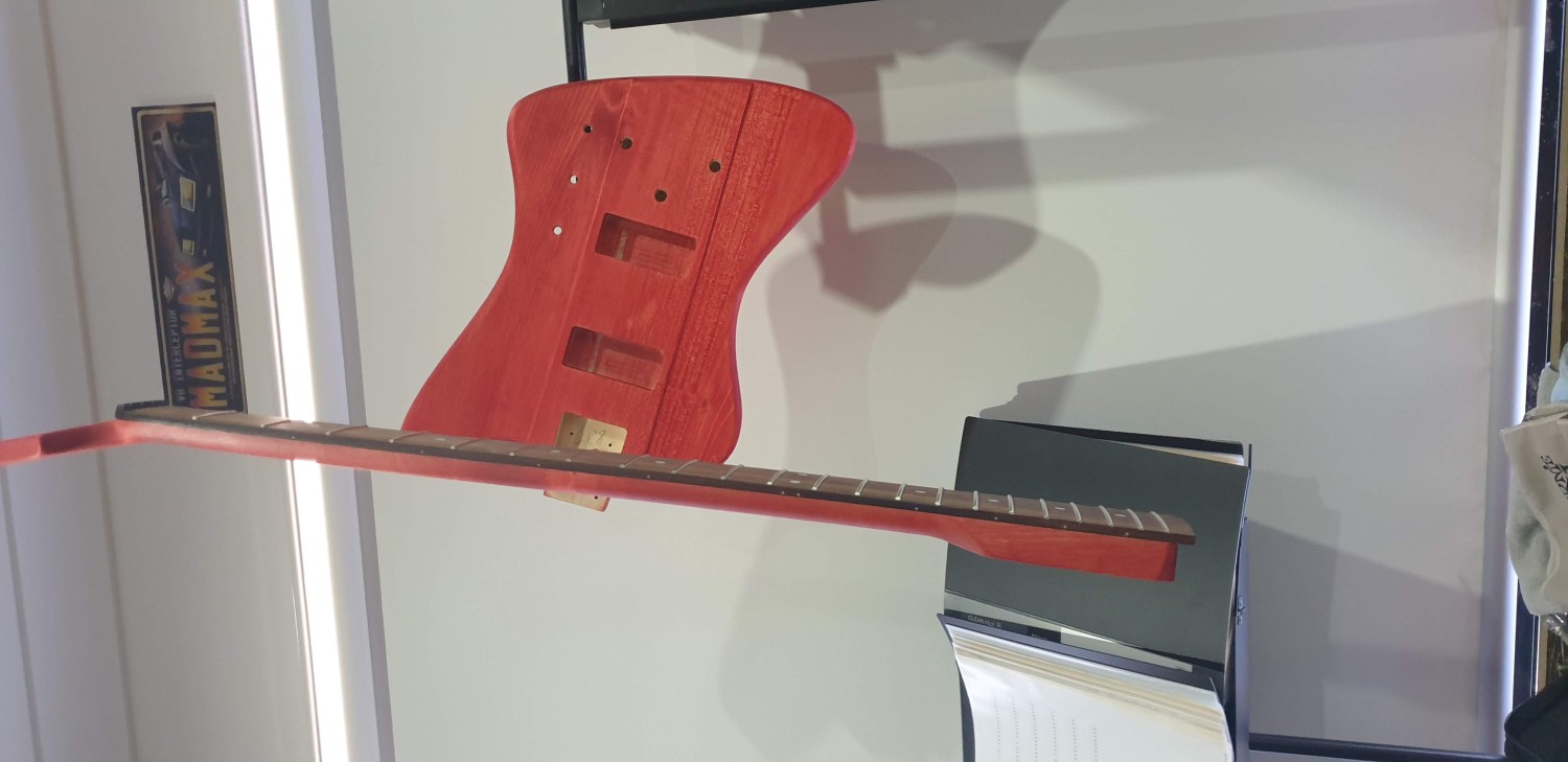

    It got the better of me and I decided to make a rig to hold up the TB-4 in the house so its warm. I went over a few spots with a little more of the Dingotone just to darken them a little more. There are some random spots a little lighter than others, but not much I can do about that now.
    I've been tossing up whether or not I really want to run a burst around the edges now. The red has a real "bloody" look to it which I'm sure will either vanish or stand out even more when I put the intensifier. Giving it a burst almost starts to feel like it's "expected" for a Thunderbird style, so doing something "different" feels like something I should be doing.
    I've also created my own truss rod cover for it. Basically the same as the OEM one except it has TR-IV standing up in the Jurassic Park font. I'm calling this the Thunderaptor.. kinda lame, yet trying to stick with the "thunderbird" concept. The velocoraptor is after all related to birds, so it kinda fits. It's a little fiddly given the size and detail, so currently waiting to see how it dries with a coat of paint over it.

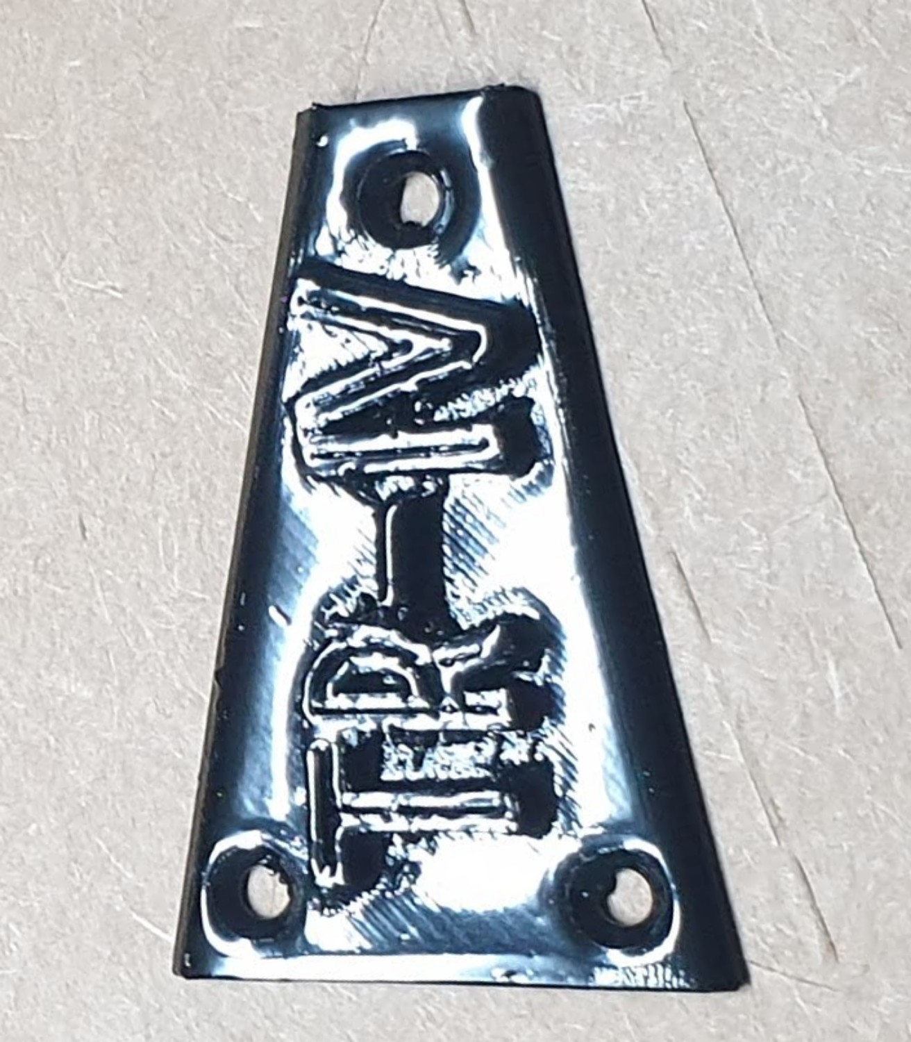

    This is the Thunderaptors truss rod cover. It doesn't look quite so messy when you're actually looking at it. The paint is less than perfect, but it's hard to get right around such fine detail. I don't think I could get any finder print with using a resin printer or getting someone to etch it. I think it'll be one of those it'll do until it irritates me things.

    That cover looks unreal! I would leave it like that. How did you do it???
  9. #19
    Member lunaticds's Avatar
    Aug 2021
    Ballarat, Vic
    146
    Printed the cover with the text added. Scraped the crap out of it with a jewelers flat head just to clean up the letters, quick sand around the outer edge then hit it a couple of times with spray paint until I couldn't see the underlying PLA any more. I think the magic came from my 5 year old managing to knock it off on to the garage floor whilst still wet, and managing to get it to land bottom down where I left it to sit for 4 hours (mostly because the garage was about 10C) given there was no way of picking it up without marking the paint.
