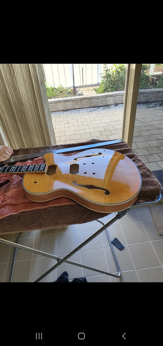

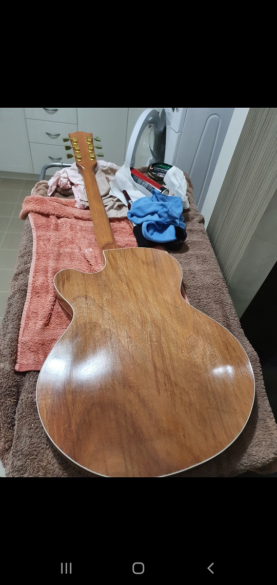

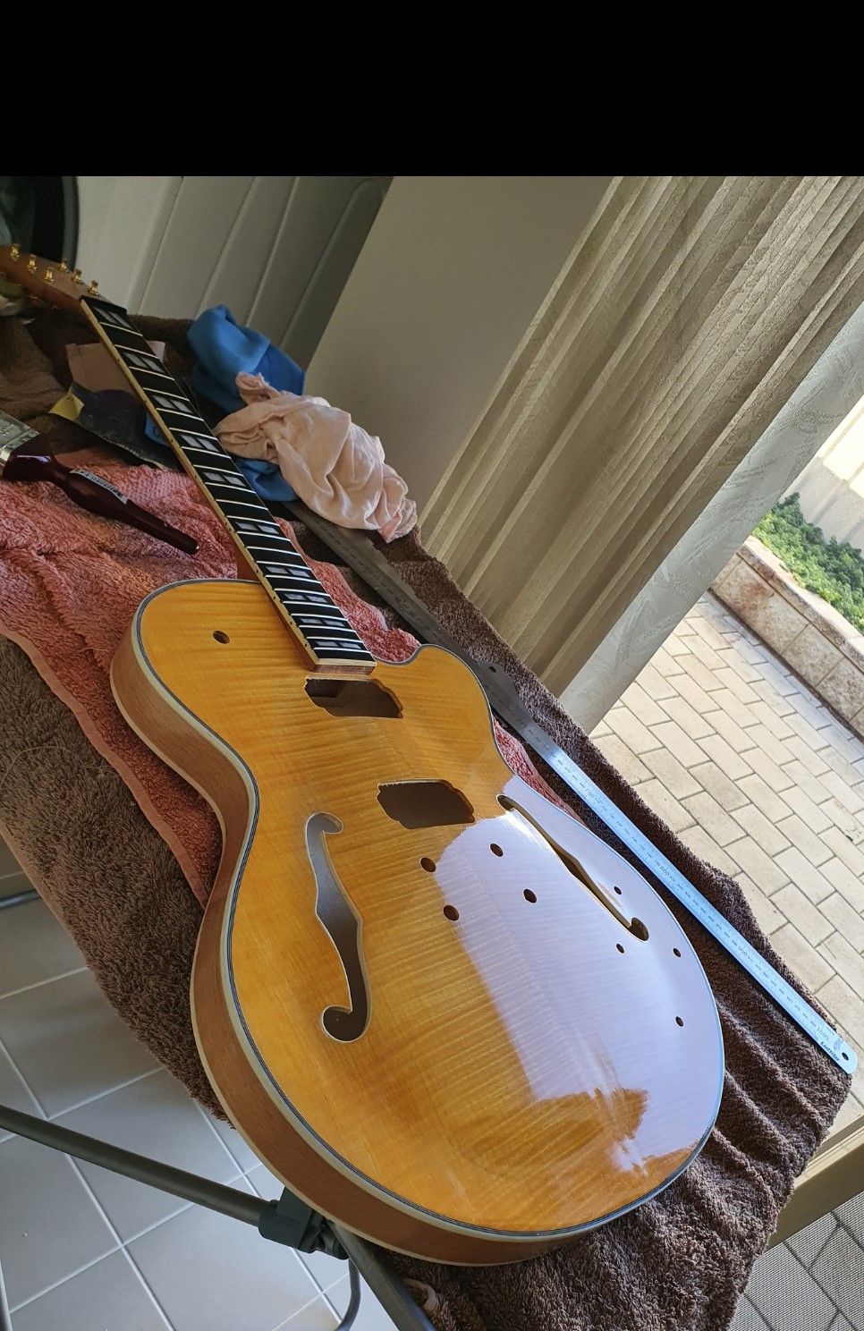

    Pretty proud of this first effort. Last coats of Tru OilClick image for larger version.

  6. #16
    Looking good. Nice glossy finish. You're approaching the homestretch now.
  7. #17
    1,949
    Got to be happy with that finish. Looks great.

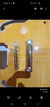

    Help is this a problem, or normal
  9. #19
    1,949
    Looks normal to me. What do you think is the problem?
    The bridge is meant to be angled slightly.
