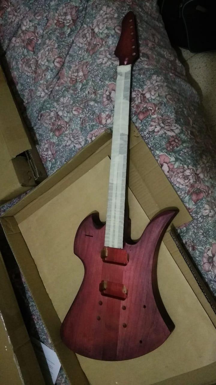

    Greetings, so I got the kit yesterday, it's a MBM-1 with custom specs:
    alder body
    ebony fretboard
    25.5" scale length
    reverse headstock
    24 frets
    In the original specs it also included single coil route for the neck pickup
    and dot inlays, which are missing due to some manufacturing errors.
    I guess I'll have it in my next build .

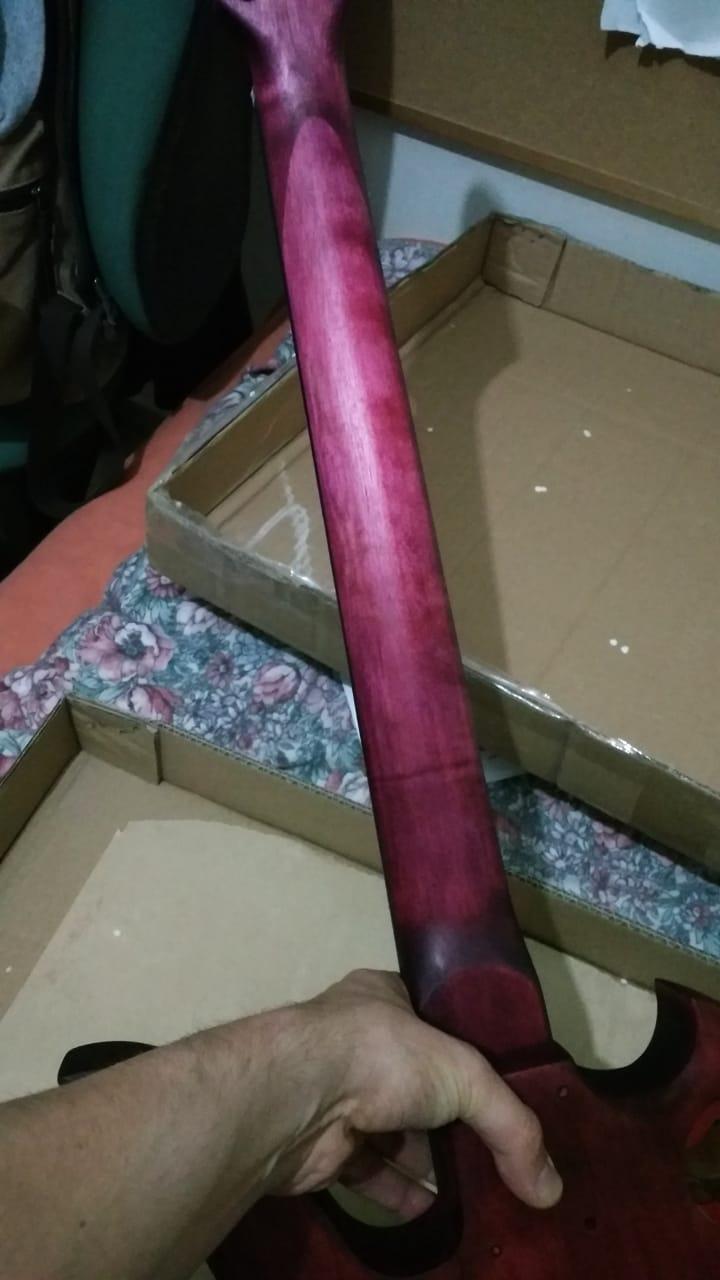

    Than I rounded the fretboard edges after the 24 fret which has some chipped wood, still visible but looks better:
    After that I oiled the fretboard with some boiled linseed oil, to prevent cracks.

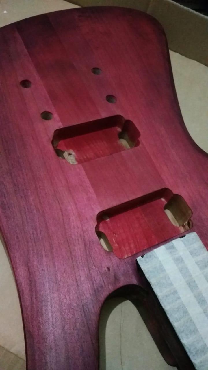

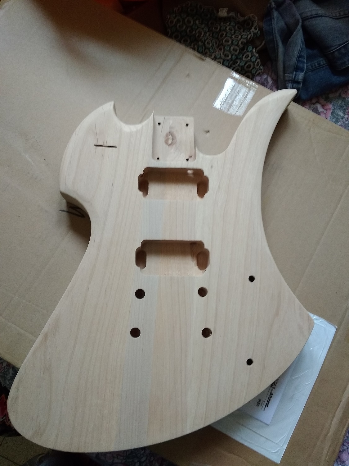

    I sanded the body using 120 grit I think I sanded most of the scratches and tool marks but still have some glue spots I didn't manage to get rid off, I guess it needs more sanding.
