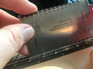

    Mock up - Pre sanding
    So far so good.. I think? The neck is really straight and only the 2nd fret seems to be a little high. I had to prop up the saddle a little to check the string height was the same up and down the neck (I started to put the saddle posts in but panicked that they'd get stuck).
    So far sanded all over on 180 and 240 (by hand).

  6. #16
    You really shouldn't put any posts inserts in at this time. You can get them out if you know the right tricks, but each time you do that, they fit a little looser. (Also, don't forget to fit the bridge grounding wire before you fit the top E side bridge insert for good). If you fit the bridge and stop tail inserts now, you can't sand around them or polish the finish properly in that area.
    Hey Simon, to be honest... I did think that. I was following the guidance in the pitbull manual and it states to wrap tape around the post threads, but I knew if I did that I wouldn't be able to inset it at all. Then looking at the picture on page 12 it looks like they just did what I did? Anyway, I got them out gently with some wood blocks and a little leverage without marking the body. I spotted the pre drilled hole for the grounding wire and made a mental note haha
  8. #18
    Sounds like you did it right then. The posts themselves wrapped in tape are fine, it's the post inserts that the posts screw into (with the fluted sides) that push into the body that should be fitted right at the end.
    So much depends on everyone using and understanding the same terminology, and this is one area where even seasoned builders will differ in their terms for the parts, so it's easy to misunderstand.

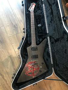

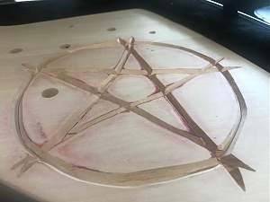

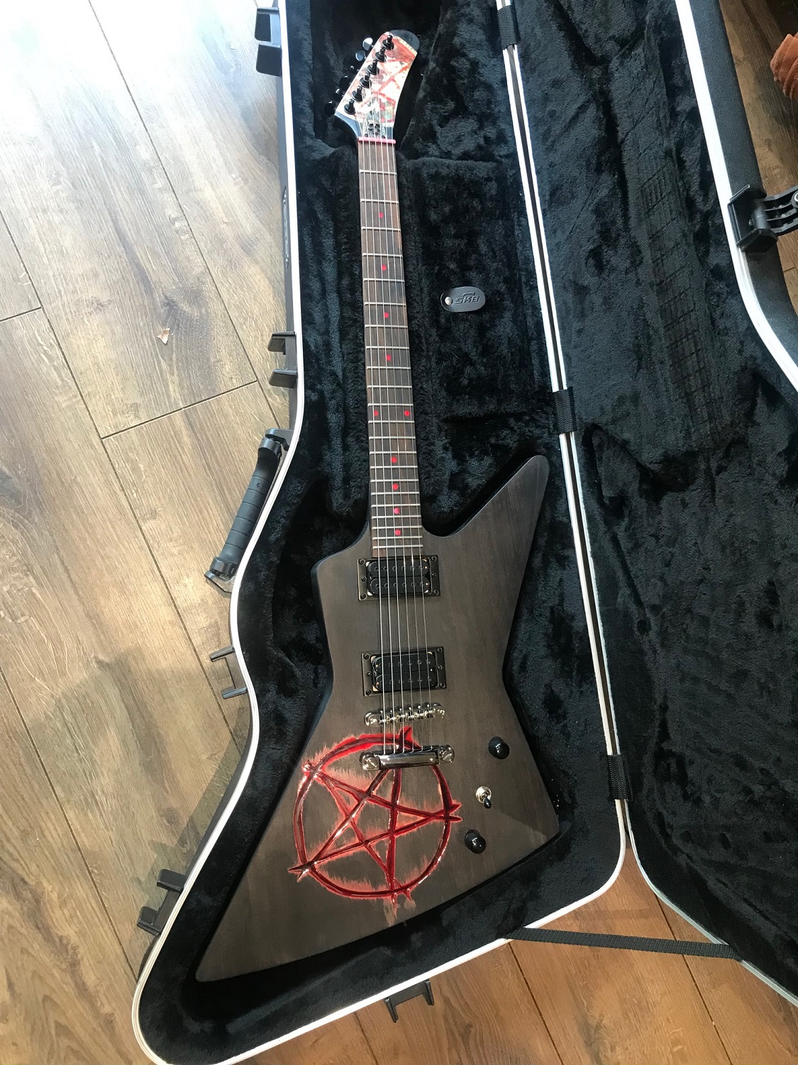

  10. #20
    Feb 2021
    Manchester, UK
    18
ID:	41279Click image for larger version.
ID:	41280Click image for larger version.
ID:	41281Click image for larger version.
    Finished my explorer a while ago but didnt get around to posted pictures! Her she is. Sounds and play fantastic, really happy!
