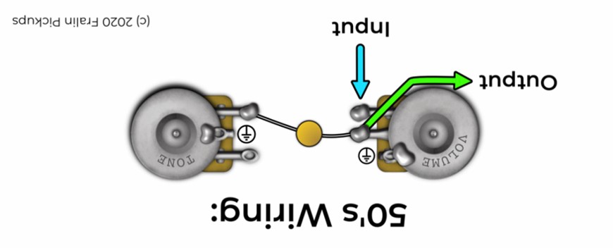

    Edit: I think I was mistaken again - sorry, trying to learn and help at the same time. It's confusing because there are so many variations of essentially the same thing. I just can't wrap my head around pulling the signal to tone from the volume INPUT rather than the OUTPUT. It seems like the signal can bypass the volume pot.
    Here's a schematic from Fralin Pickups. I flipped it upside down to help align with your setup. It's basically what you have but tone pulls from the volume OUTPUT.

    Quote Originally Posted by Joe Garfield View Post
    Yes, I'm a bit confused by this too, however I did find this article which explains some of the differences between 50s, 60s and modern wiring which helped. Also as you've said there are many ways of wiring components into what effectively are the same circuit which doesn't help when you are learning and troubleshooting!
    (thanks also for flipping your picture

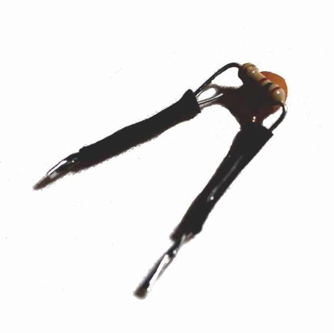

    I've checked the resistor on the treble bleed circuit (measured and colour code), and it's 150 ohms rather than 150K ohms as advertised in the "kit". I'm no expert but I'm pretty sure that was the cause of the problem ...
  8. #18
    OK, I'm starting to doubt myself now. Pitbull advertised their "capacitor and resistor fidelity upgrade" as having a 150k ohm resistor, but I'm pretty sure I got a 150 ohm resistor. This is their picture, which I also think is 150 ohms - am I completely misreading the bands/code (I know the colours aren't great but I would have thought the multiplier would have been much higher for 150k (yellow))?

  9. #19
    What are the band colours from left to right with the gold band on the right?
    Using the 4 band system (as shown) 150k ohm should be Brown, Green, Yellow, Gold*. (*depending on tolerance)
    4 band 150 ohm = Brown, Green, Brown, Gold. (which is what the picture kind of looks like, but hard to pick if the second band is green)
    edit to add:
    5 band would be: 150k ohm = Brown, Green, Black, Orange, [Tolerance value varies]
    150 ohm = Brown, Green, Black, Black, [Tolerance value varies]

  10. #20
    Yes, that's what I thought and even though it's hard to pick the second band the third band is definitely not yellow!
