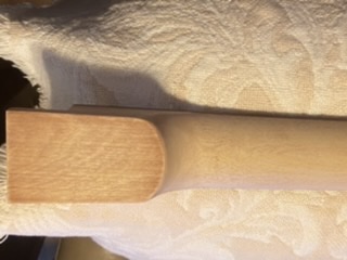

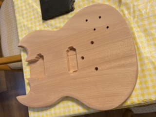

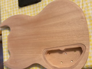

    Ok, I have finally got going on my build. Been spending a few hours a day mainly sanding wood filler. Seems to have filled everything well. Soon as I figure out how I’ll post pictures.

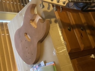

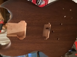

    Very productive few days. Have begun staining. Click image for larger version.

    Two coats today and I’ll do 2 more tomorrow. After that I’ll decide if it’ dark enough.

    Finally have some pictures up
