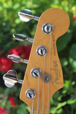

    Have you fitted the string tree for the D and G string? (big round button with a screw that fits through the middle) That should hold the two treble strings in place If it's not doing the job, it may need lowering, or you've mounted it too far back on the headstock to be effective.
    Like this:
    The string break angle over the nut will be too shallow without one.
