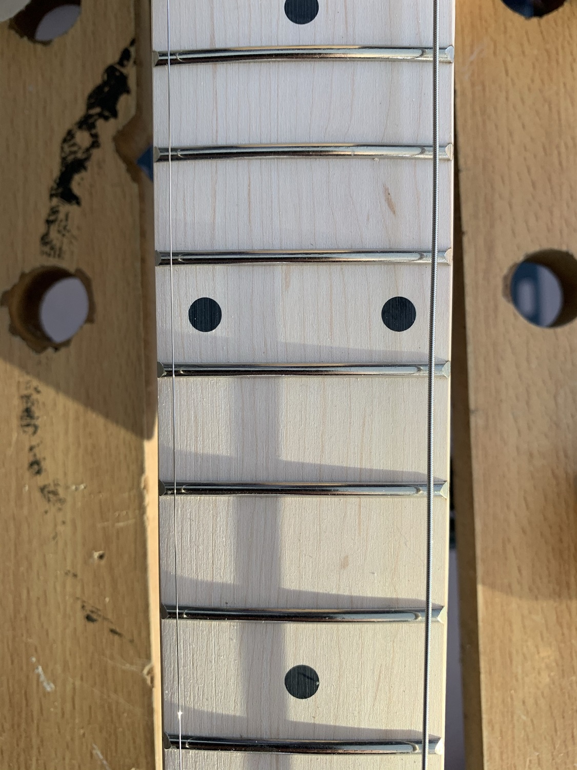

  11. #18
    Member Groovyman32's Avatar
    Feb 2021
    256
    Job done - I’ll update my build diary with the full deets - but here is the preview:
  12. #19
    3,094
    Beautiful job! Cruising over the the deets now...
