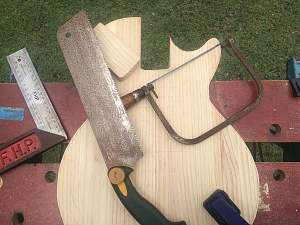

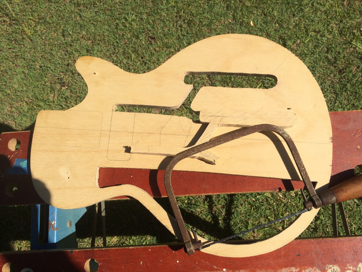

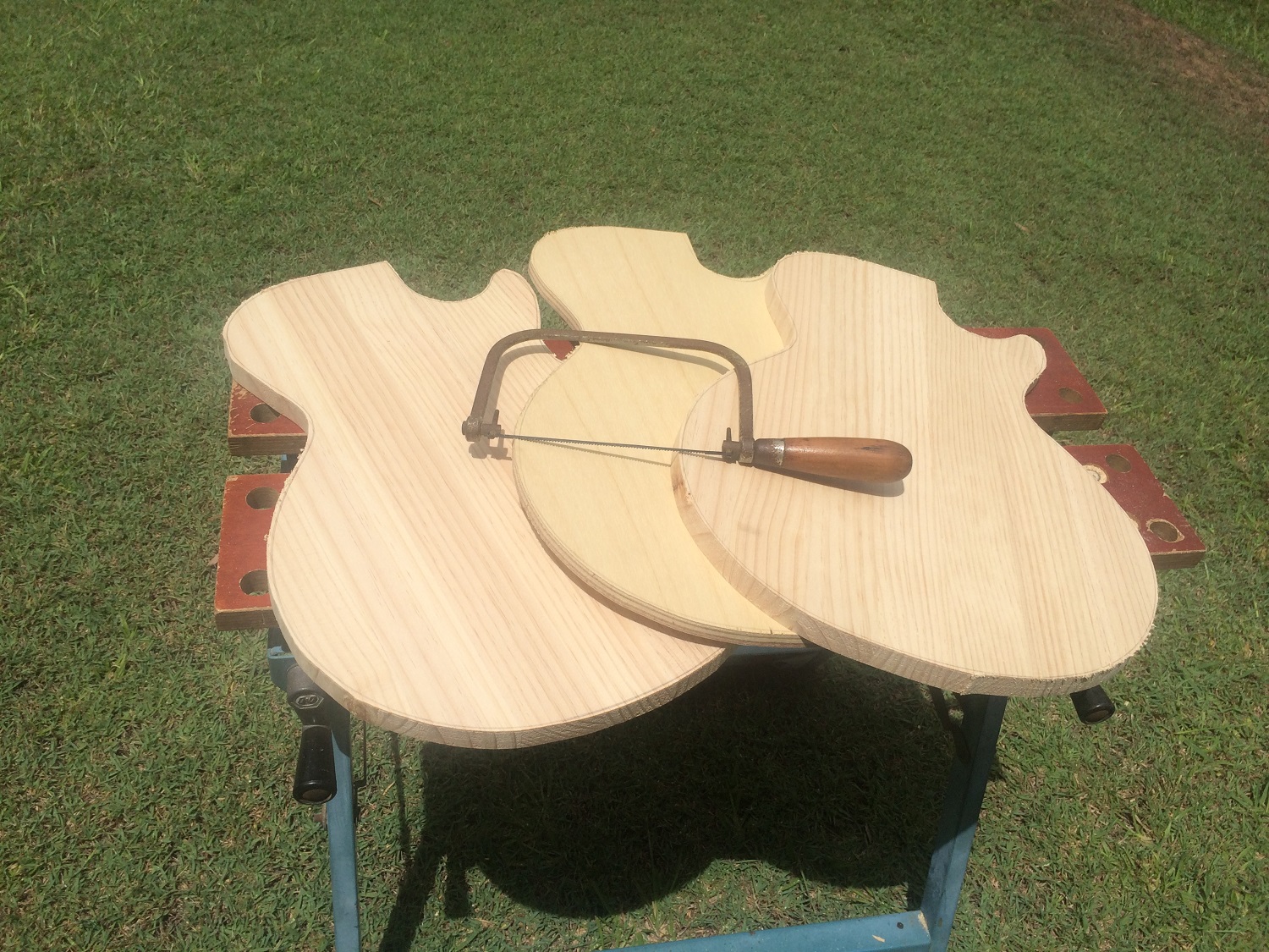

    It took most of the day but I got the 3 separate body sections cut out today.
    2 outer layers of laminated pine that sandwich a layer of marine ply.
    Why 3 layers? That’s because I don’t have a router and this seems to me to be the easiest way to cut out a neck pocket. I just need to cut the pocket out of the top layer.

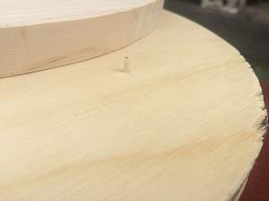

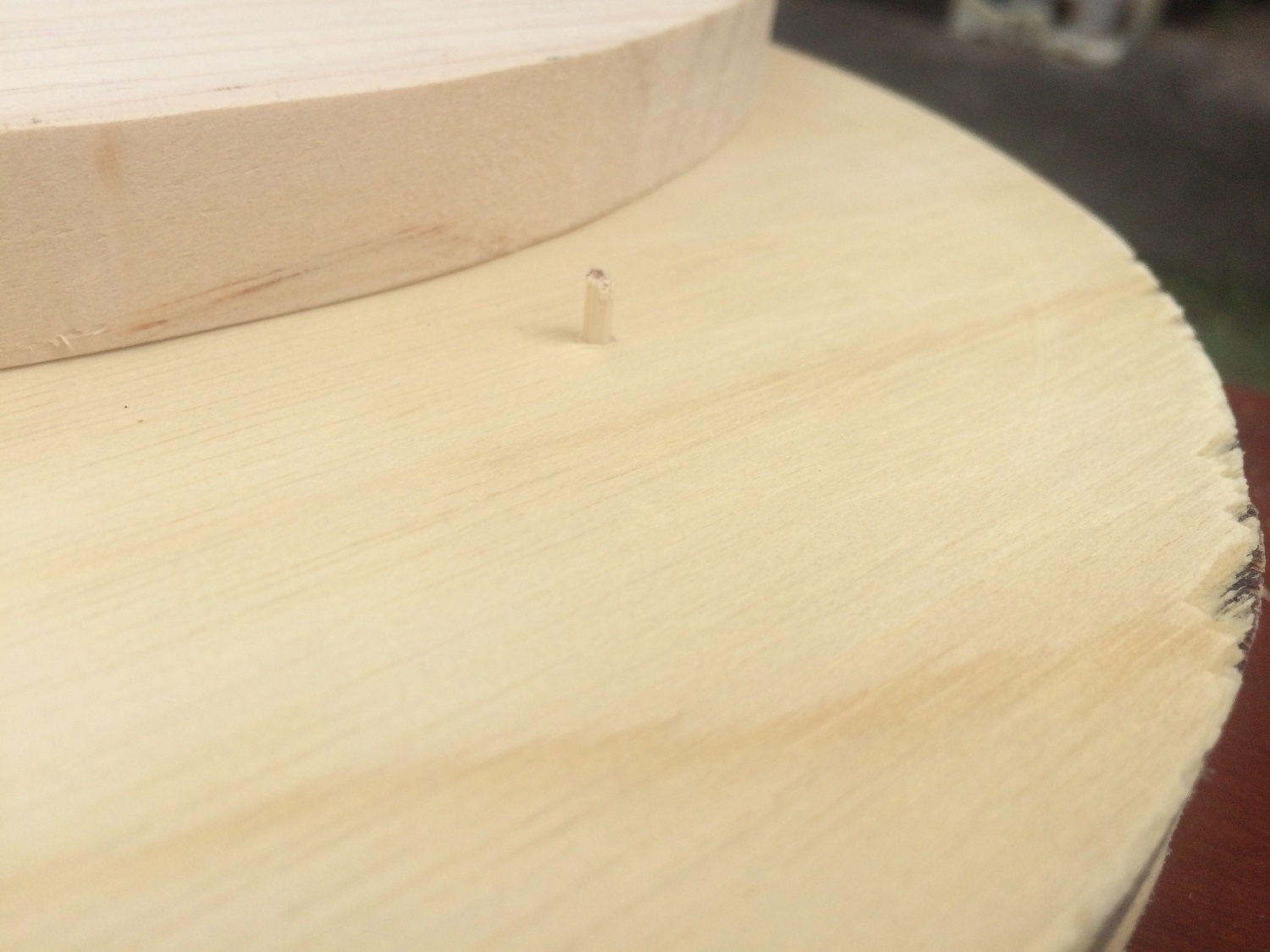

    I need to do some work on the body pieces before they are glued together so I cut up bamboo kebab skewers as dowels to locate all the pieces together to stop them from moving around while I am working on them. You can just make out the dowel in this shot.

    Mistake #2. It appears that did not do a very good job with the neck pocket. Its ok but not as tight as my previous guitars. I have some thin veneer off-cuts laying around so should be able to shim it to tighten it up.
    Tomorrow I will use my Japanese saw rasp to roughly shape all the pieces before I get into chiselling out any internal routing that has to be done before gluing the body together.
