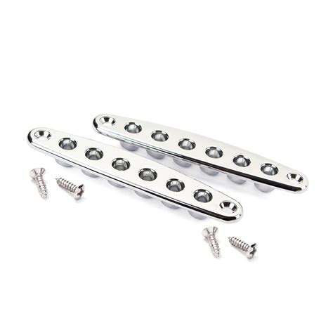

    Quote Originally Posted by robin View Post
    Not sure if these are any good for a contoured body, but a Ferrule Plate might be worth a go if you are concerned about lining up string trough holes.
    Attachment 38925
    On eBay for about $15.00
    https://www.ebay.com.au/itm/String-F...frcectupt=true
    Just be sure the centre to centre string spacing is a correct match for your bridge on these before you buy.
    Whilst it is likely to be 52.5mm E to E, I didn't see anywhere on the listing that states what it is.
