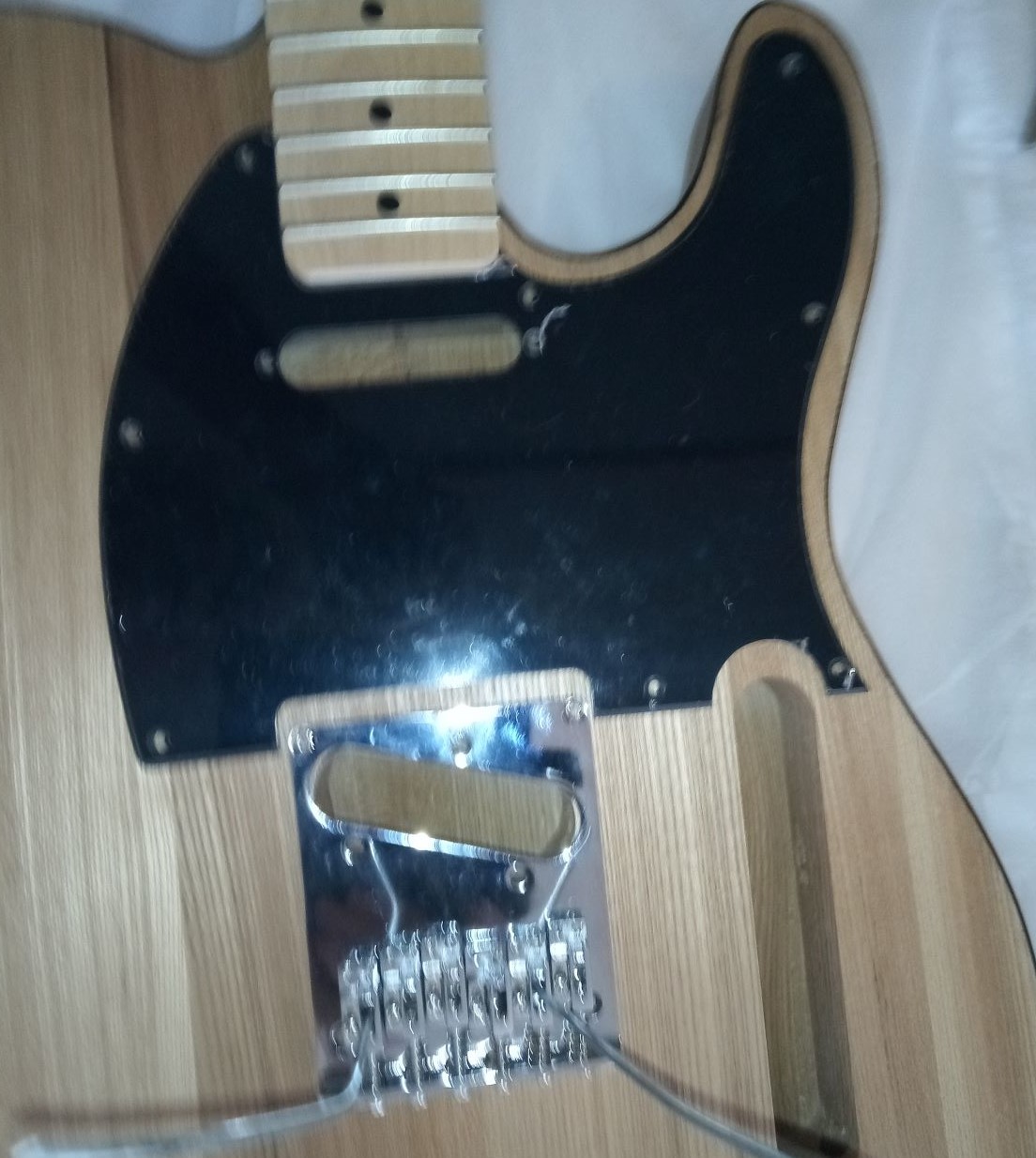

    Another query. In the notch in the body to take the neck someone has written 640 in pencil. Is this significant?
    Also - am attaching a pic of the neck, body, bridge and scratch plate --- . I was under the impression that we should not see and timber between end of the neck and the bridge plate. Opinions please. Thanks Mark and McCreed. Click image for larger version.
    If you mean between the pickguard and the bridge plate, that gap is pretty common, even on genuine Fender Telecasters.
    The gap on the real deal tends to be slightly less but it existence is not irregular. The gap on PBG kits tends to be wider and can vary from guitar to guitar.
    I'll reiterate that PBG kits are generally very good (especially at their price point) but none are perfect or flawless. All require troubleshooting and outside thinking to more or lesser degrees.

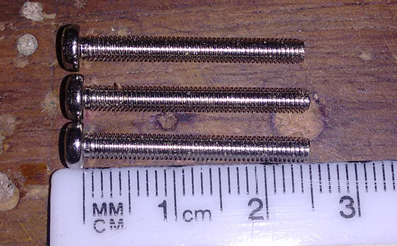

    the 25 mil screws plus longer springs did the trick. 648 easy. Thanks for the assistance.
  7. #16
    Good to hear. FWIW the spare screws that came with the Trem-King.
Name:	25mm machine screws.jpg
    cheers, Mark.
