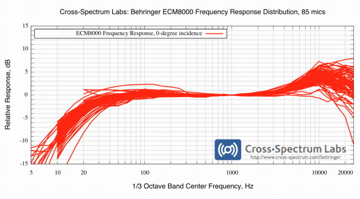

    Here's a graph comparing the frequency responses of 85 Behringer ECM8000 mics.
    Whilst some are pretty flat, the majority are far from it, and without its response being checked, you have no clue what yours would be like. That graph has also been 1/3 octave smoothed, so the actual frequency response will be a lot spikier.

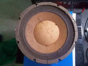

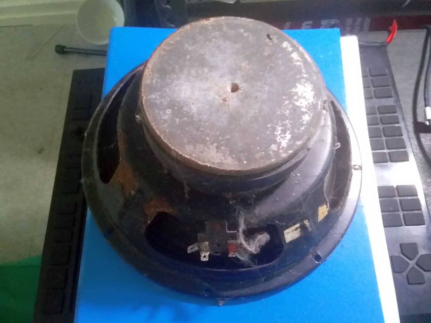

    I decided to take some pics of the only working speaker from my Peavey 410TX Bass cab:

Name:	Stock Speaker 2_resized.jpg
Name:	Stock Speaker 3_resized.jpg

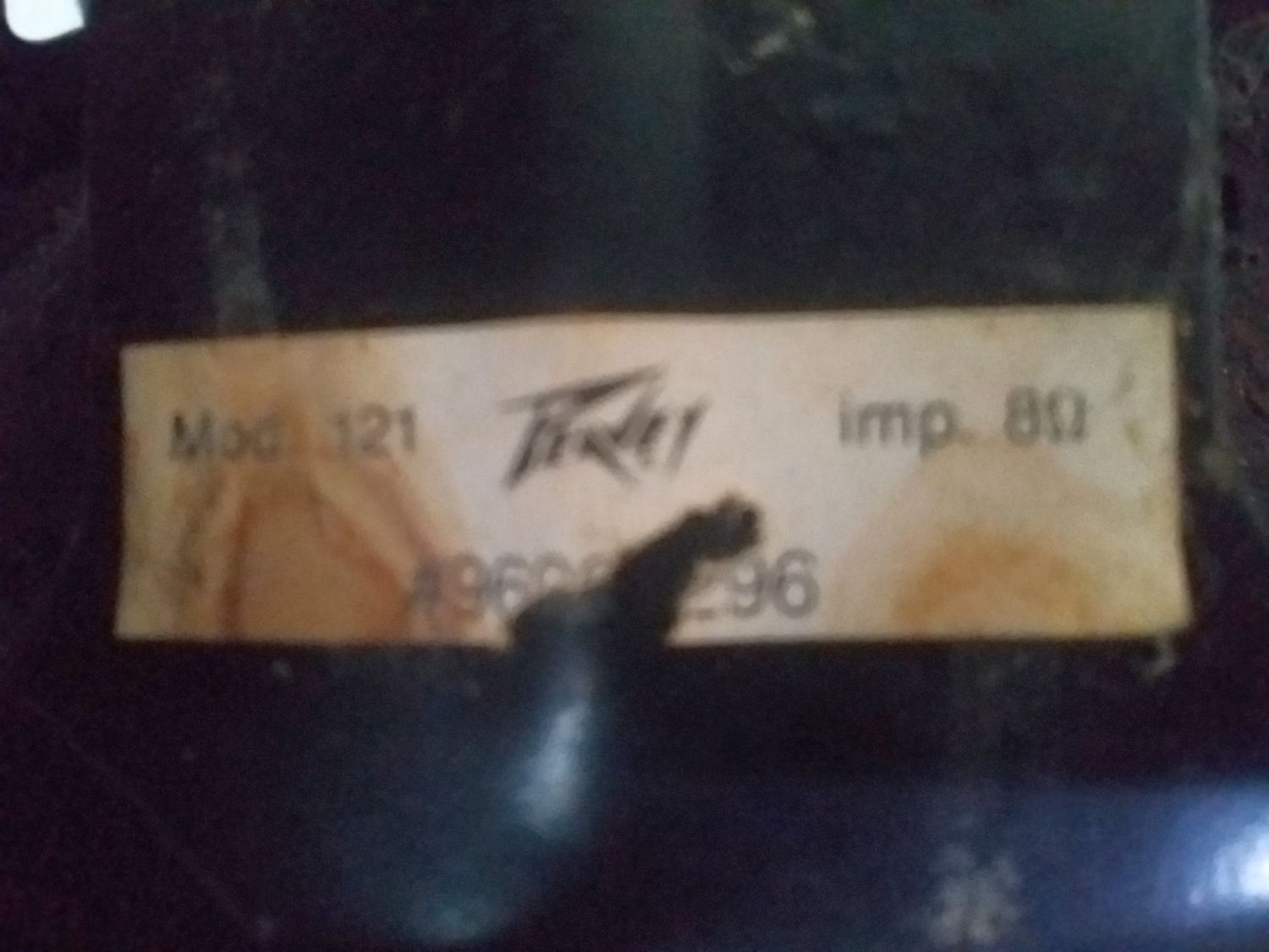

    The last pic is a close-up of the label on one of the other three non-working speakers.
