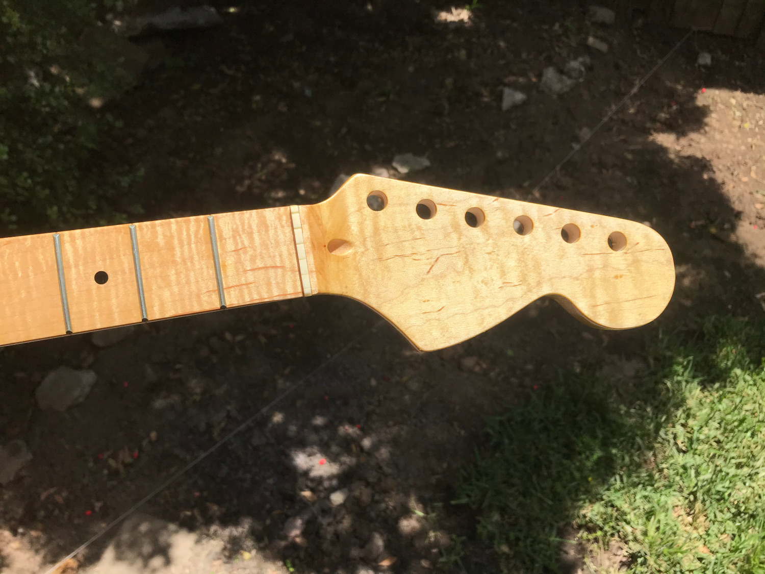

    I am. The stain didn't really seem to take to the fretboard, but the colour's turning out daily even with the Tru Oil. Here's a photo - taken in bright sunlight, so I'm afraid the colours don't look very accurate to me.

    If the colours are accurate, then it looks like it's developing into a nice colour.
