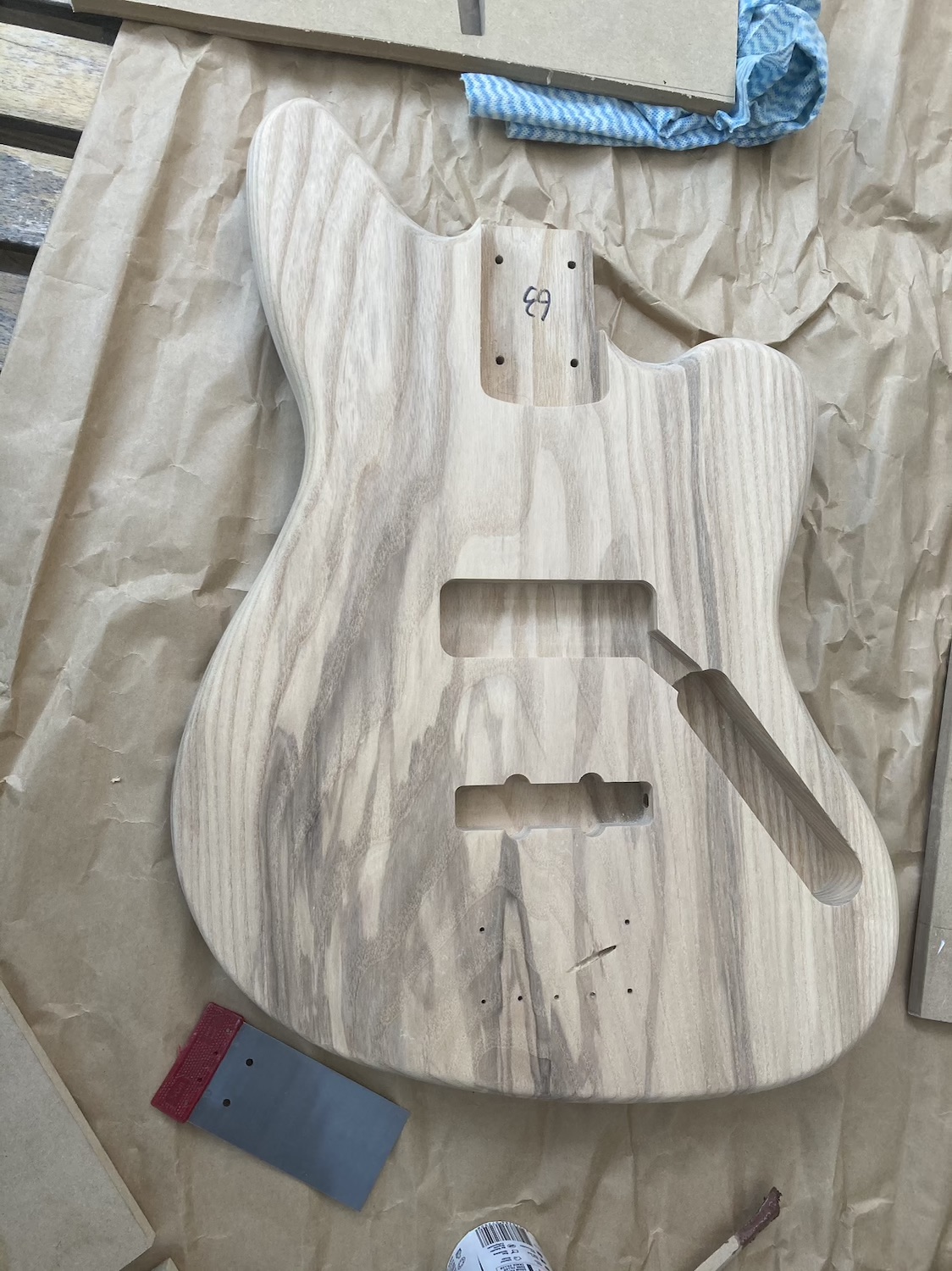

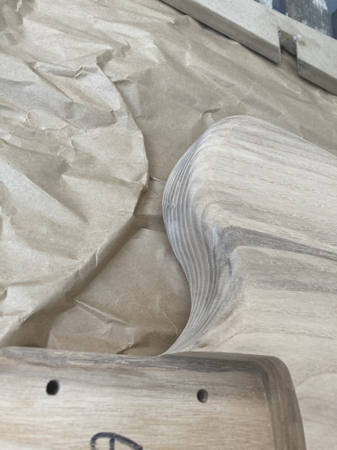

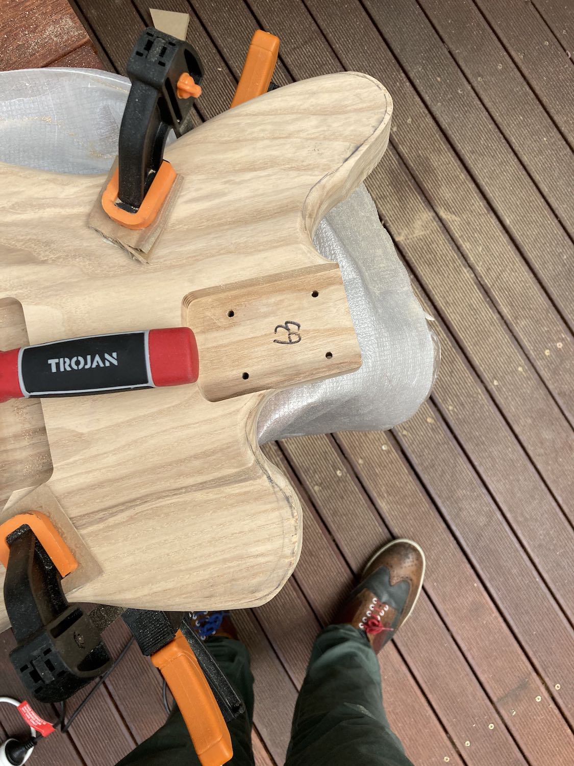

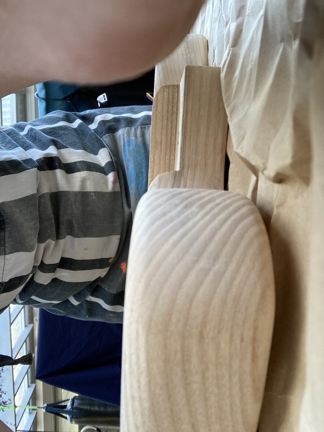

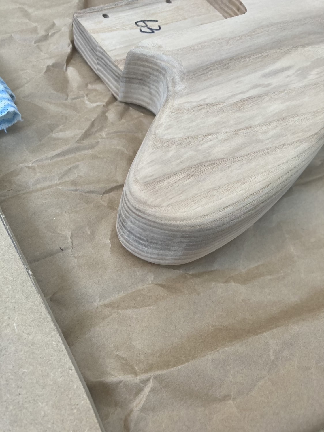

    Body reshaped
    Met with a acoustic guitar builder friend who helped me out with rasp and spoke shave to round off the horns from my rough cuts.
    Before
    After

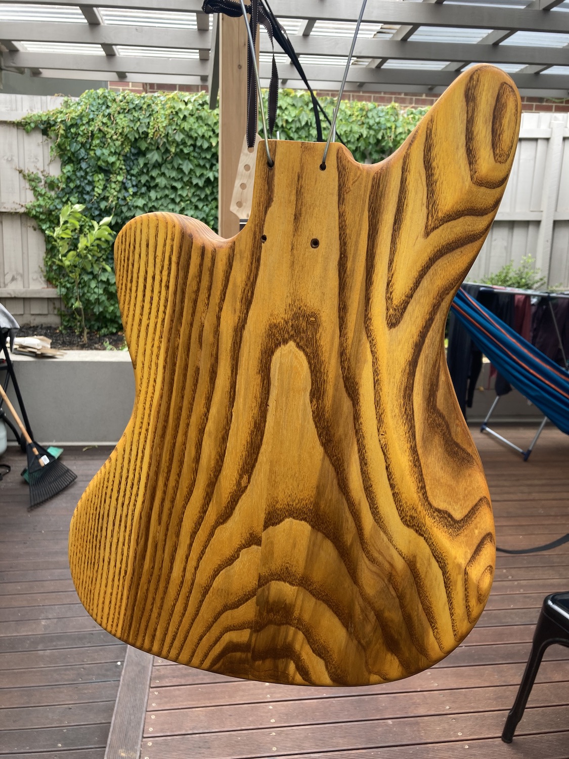

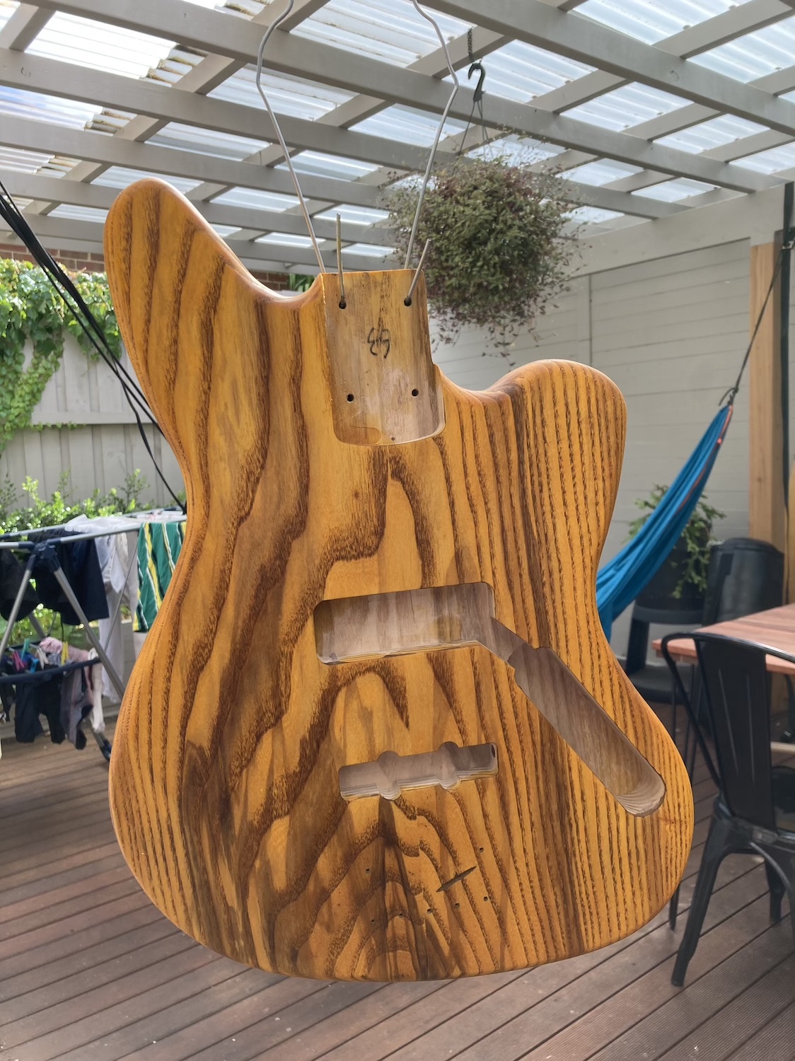

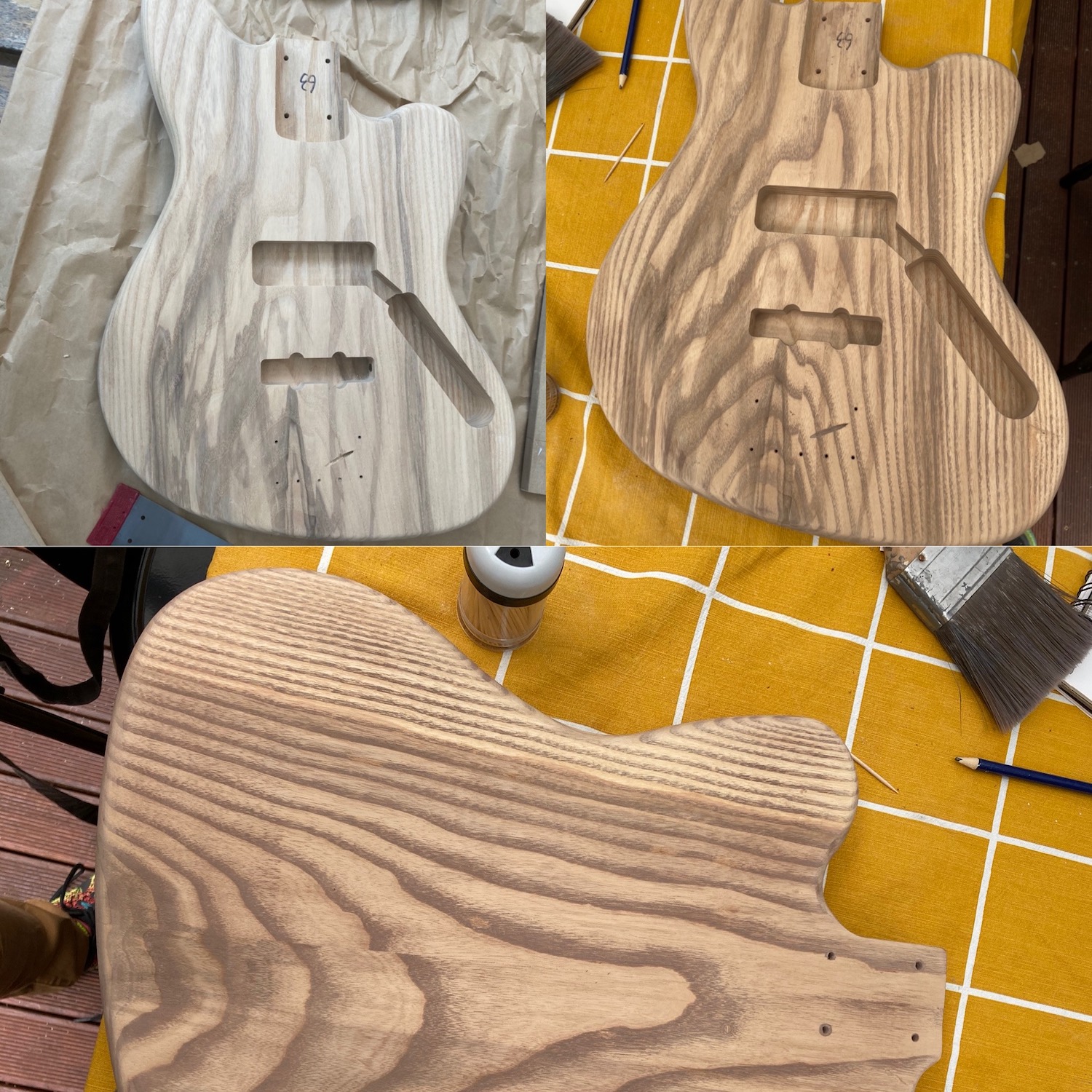

    Grain filling and Stain coat #1
    Grain filled with walnut Timbermate.
    Did first stain coat of Dingotone Coolangatta Gold after sanding to 400. Take up on back a lot less than on front as you can see. Very strong penetration on the end grain on the sides.
    First coat of Dingotone Gold.

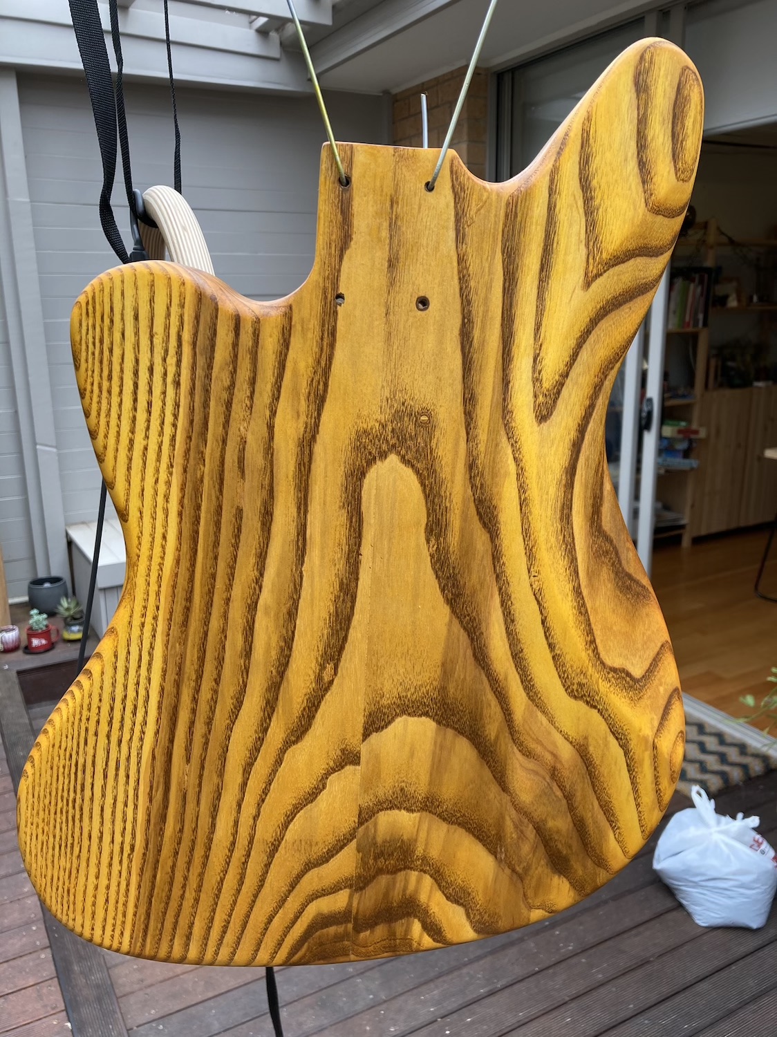

  9. #18
    Dec 2020
    Melbourne, Australia
    37
    Stain coat # 2

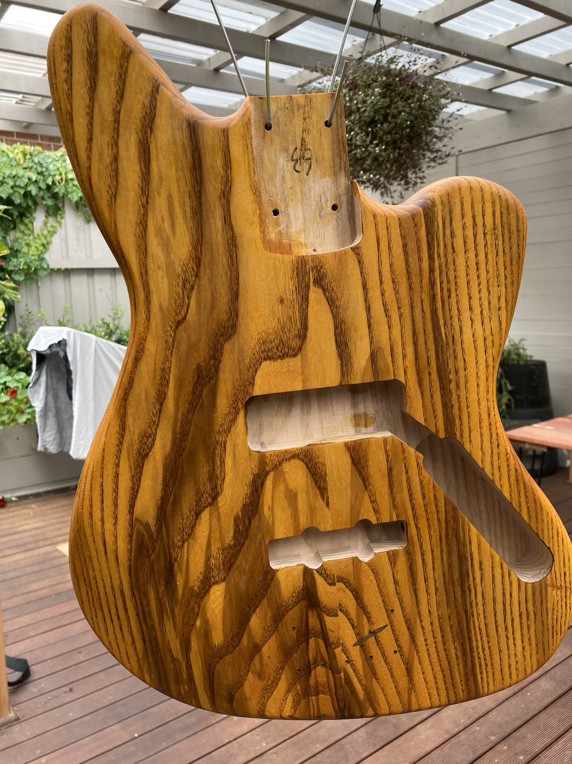

    Waited a week for Dingotone to dry in Melbourne weather. Back and front dry, sides (end grain) still getting yellow residue on fingers. Decided to do a second coat just on back and front - heavier on the back to even up the colour.
