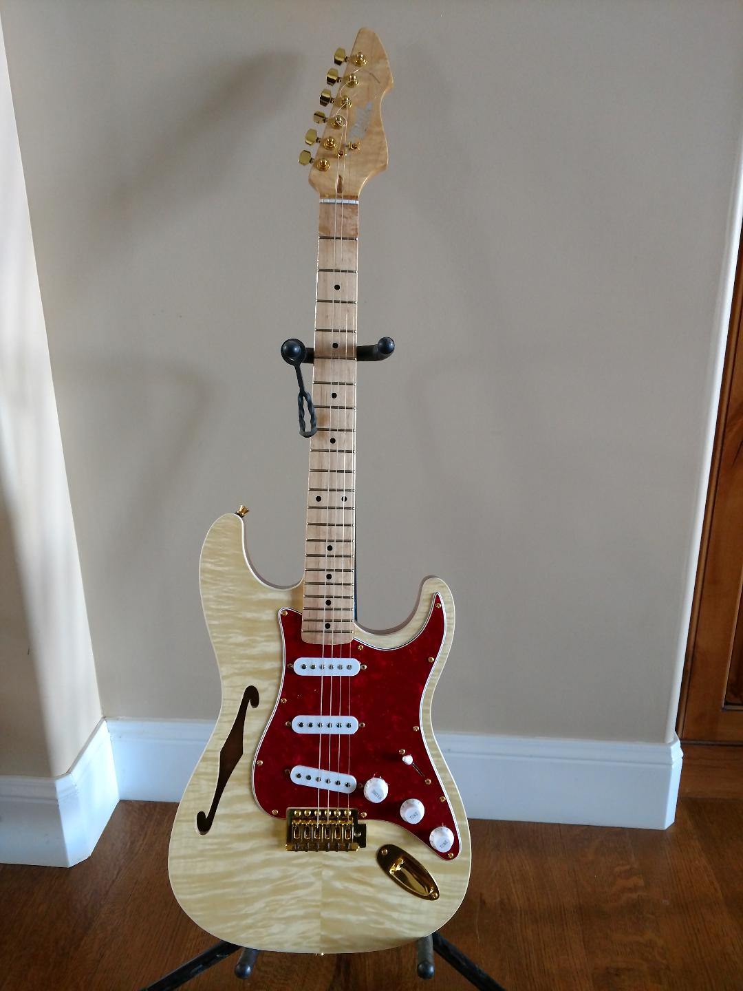

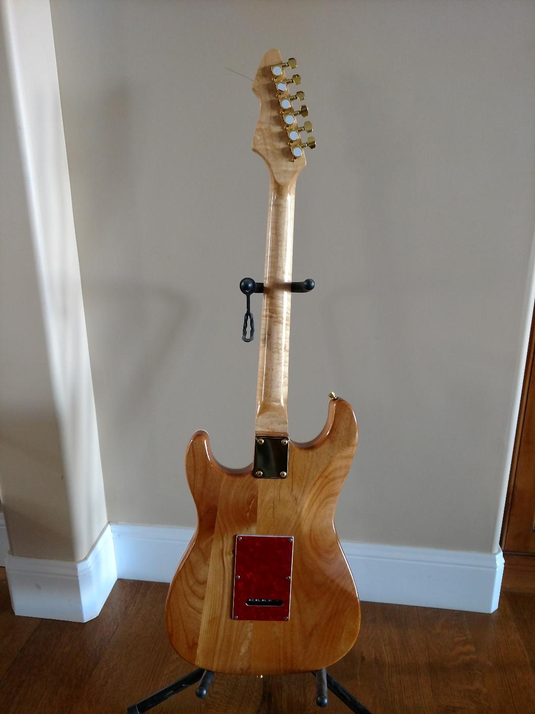

    I'll try to add a couple of photos of the ST semi-hollow I built last year. Click image for larger version.
ID:	38392 Didn't work. I'll try something else.

    Member XP Rider's Avatar
    Sep 2019
    Western Utah
    170
    OK, did work after all. So hers is the back. Click image for larger version.
