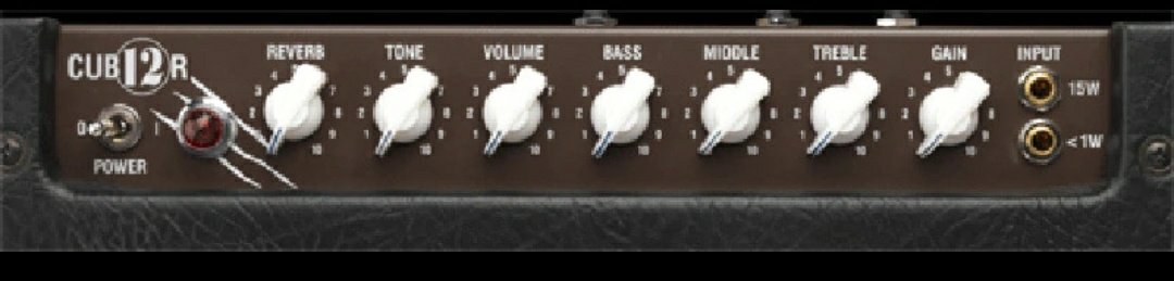

    Maybe there is more than one Laney 12. I have read that the amp I just got is a clone of the Laney 12r with a few differences, which does have a tone control. Laney had digital reverb, a different speaker and the chassis is mounted so that the controls are on top rather than on the face. On the Stage Right/HB there is a switch to go from 15w to 1w. The Laney replaces the switch with two jacks, one for 15w and the other for 1w. I have also seen defences to them being built by the same plant in China.
    I am getting all this from reading. I have never actually seen a Laney 12r. I live in a cave too.

    I looked at a head version (as it was easier to see the knobs), but which turns out to be a super cub 12 and that's why it's very different. Should have looked at the combo!

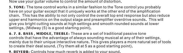

    This is from the amp's user manual:
