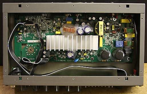

    I found a picture on the inturwebs of the pcb, and there definitely should be a tube socket there.

    The leads on the tube will sometimes corrode over time, making them not slide in and out of the socket so easily (which also kind of helps to keep them in place, a tight friction fit). Give it a firm tug - but don't crush it in the process - and it should come right out.
    The best way to remove a 12AX7 tube from it's socket is to gently move it from side to side while pulling so you basically are walking it out gradually, try to be gentle while you're doing that so you don't put a crack in the glass envelope near the base of the 12AX7.

    Looks like you may have to undo a couple of screws to get that board off its mountings, but you'd have to do that anyway if you wanted to swap out the 'tube' (even if it is really a 'thermionic valve' ).

    Ok, popped off the top and wiggled the tube out of the slot. As Simon predicted, no sound with the valve out on the tube setting (splitting the difference with the terms here ;-) ). Put the valve back in. Sounds the same on both settings.
    So, from this rather remote distance I would suggest that the switch is probably stuffed and stuck in one position
