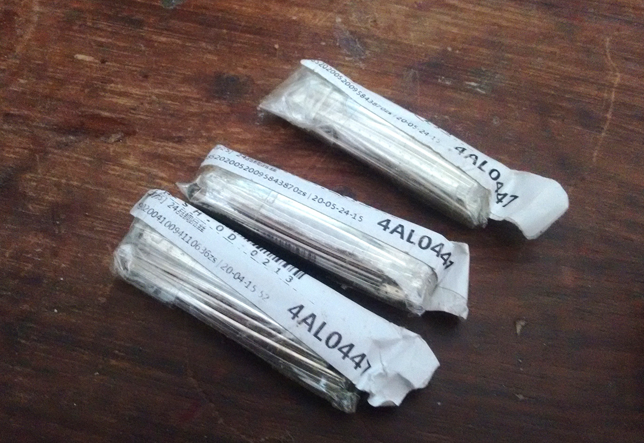

    I got pre-cut frets from Alibaba.
    At approx. $3.00 for a packet of 24 they represent 'value for money'
    Only down-side is how long they took to show up.
    These arrived the other week out of the blue..so long ago that I'd forgotten about them.

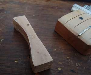

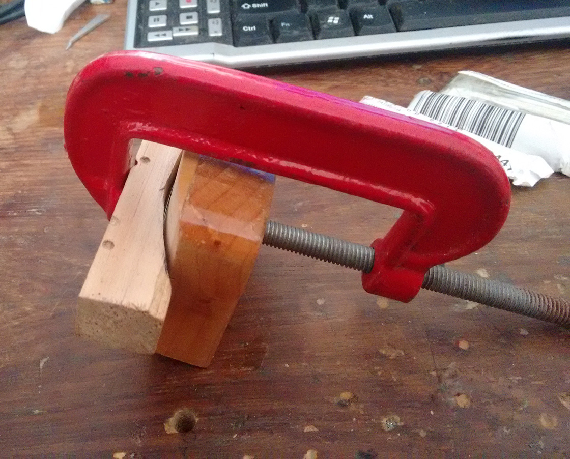

    As per the 'pre-radius' I concocted a KC bodge thus.
    I am installing them into a 7.25" radius neck.
    Used the butt end of a trashed neck and set about increasing it's radius to about 5.

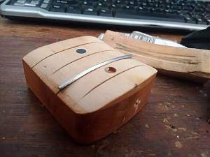

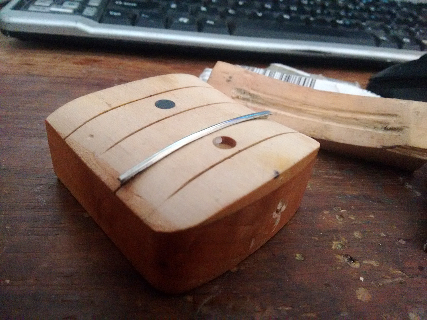

    Another sliver of wood convex.
    Using a G clamp to squeeze them down.
    cheers, Mark.

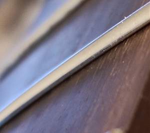

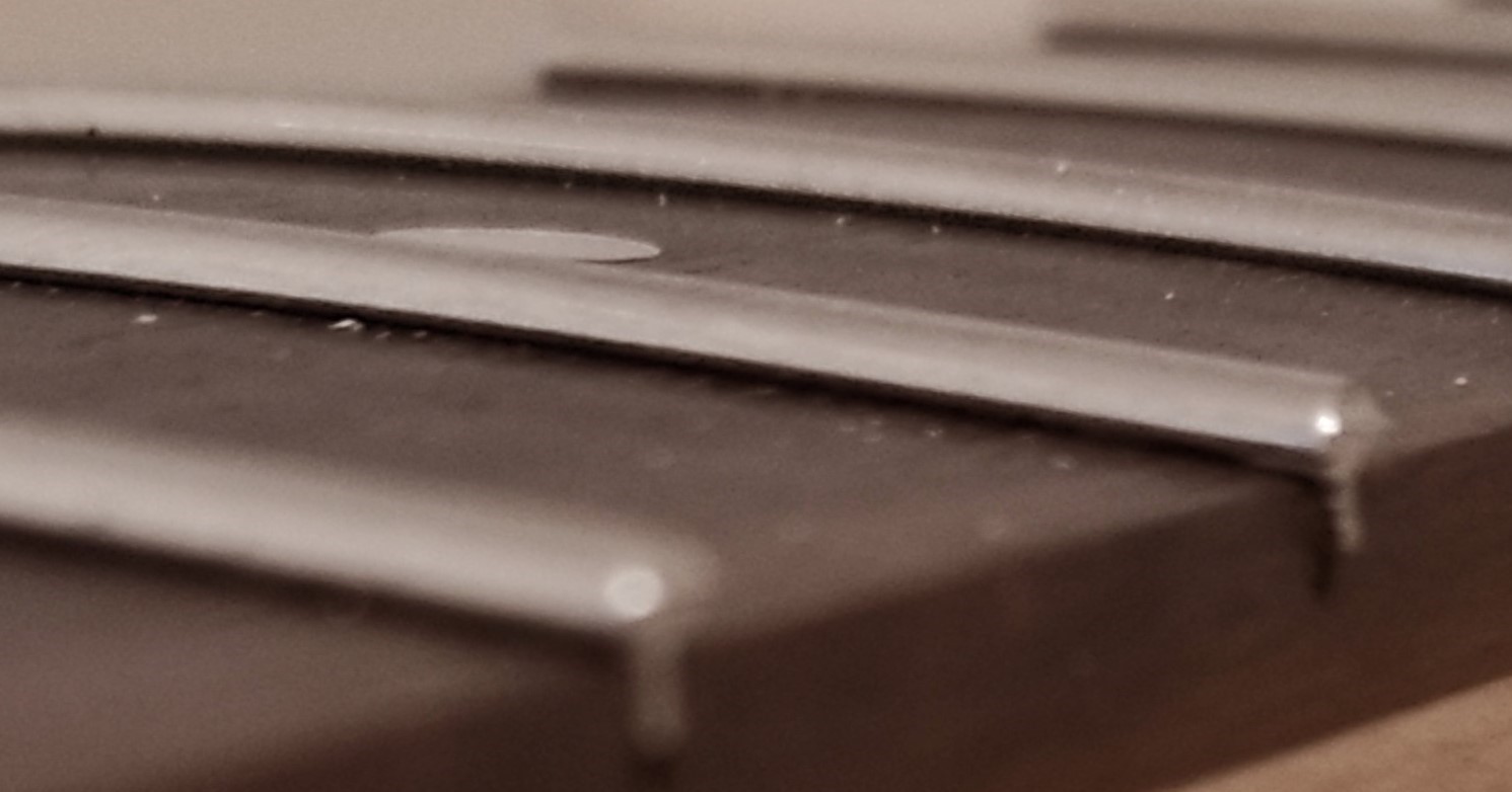

    Progress!! I used King Casey's method of bending the frets. It wasn't exact, but it worked. I've installed all the frets (I had exactly enough wire thankfully) and it went with minimal issues.
    The frets are not sitting completely flush though...
ID:	38166 Click image for larger version.
    Hopefully you can see it, it's hard to photograph.
    They are very close though, I can slide a piece of paper under but not a folded piece. They are also very uniform, all of them at pretty much the same height above the fretboard. Some of them have edges sticking up but I can sort those out easily.
    I am happy with how they are seated but want more opinions. As long as it won't cause issues, I'd be happy to leave them as they are.
