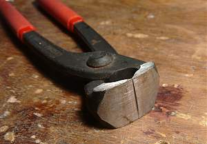

    Hey, for pulling frets I use one of these:
    Deja Vu!!
    That's exactly what I've used on various fret-pulling exploits.
    cheers, Mark.
