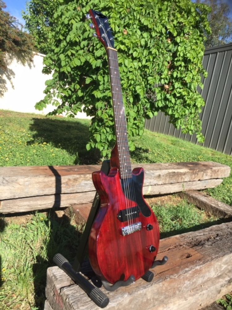

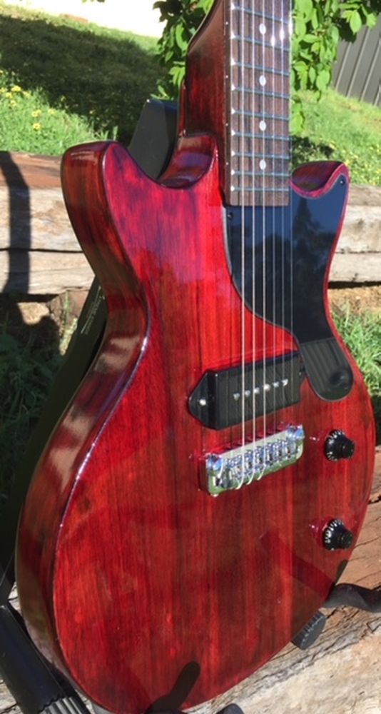

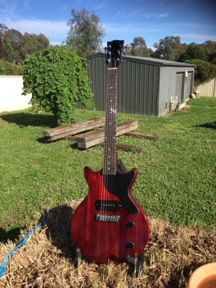

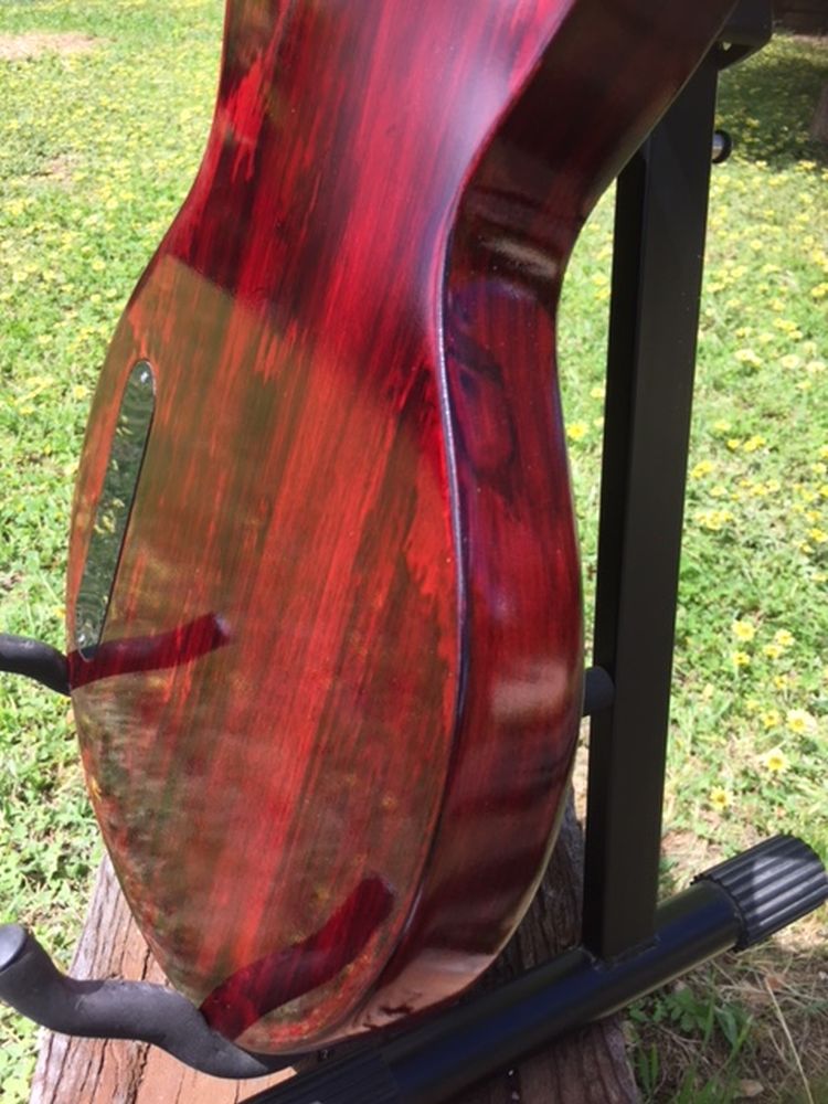

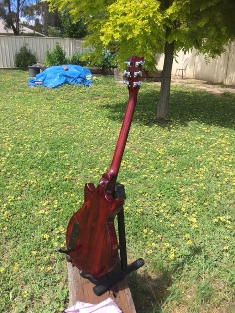

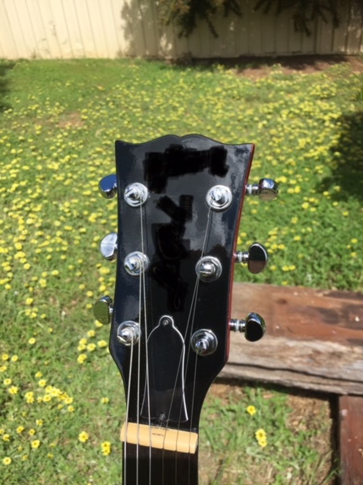

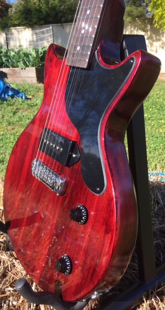

    Last minute entry - from my mailbox - Jon Franklins JRM-1DC.
    "Finished my junior style build. This is my first attempt at a kit. Used mahogany stain, Grover mini locking tuners, Martin A Smith hound wound P90 PU and I made the wiring harness using CTS 500k pots, cloth covered wire and 600v 223j Orange Drop cap.
    Some minor tweaking to do, but sounds and looks pretty good."

    Jon Franklin's JRM-1DC
    Double Cut Jnr on what looks like a Basswood body. Nice & shiny colour and the extra mods should make it sound great. Marks taken off for using someone else’s logos.
    Beautiful deep wine colour that really suits the build. Traditional black headstock face looks great and balances with the black plastics, but a logo would've been a nice addition. Simple, clean and really appealing build. Very nice indeed.
    It’s a shame you didn’t put your own name on the headstock, rather than the one you’ve blacked out in the photos. Own your originality.
    Pretty good effort for a first build, photos make seeing some details difficult. The overall style looks right and the mahogany stain is a good choice. Stain application looks a little uneven and may have been improved, by sanding back and reapplying. Shame about the headstock logos having to be blanked out. Action appears to be quite high, even with the bridge on the deck, so perhaps not quite enough break angle on the neck. Some well considered upgrades. All in all a solid effort and no doubt a lot was learned for the next one.
