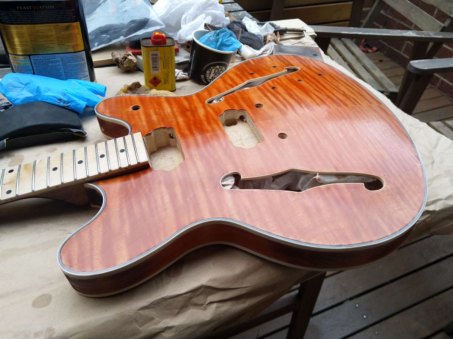

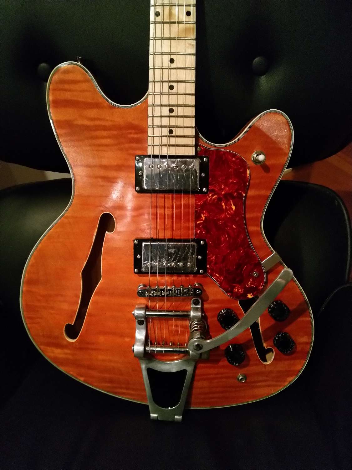

    Fifth coat of FW wipe on. Very happy with this. I had a fourth coat blooper (don't apply in low light after too many wines &#129396 light sand and all good. With a light buff it'll be like a bought one...

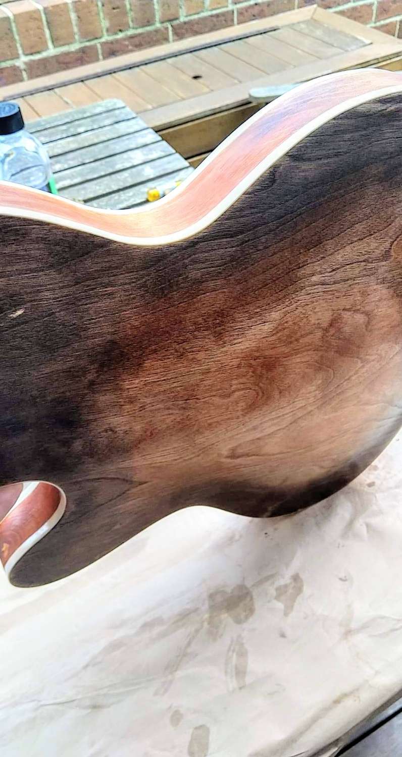

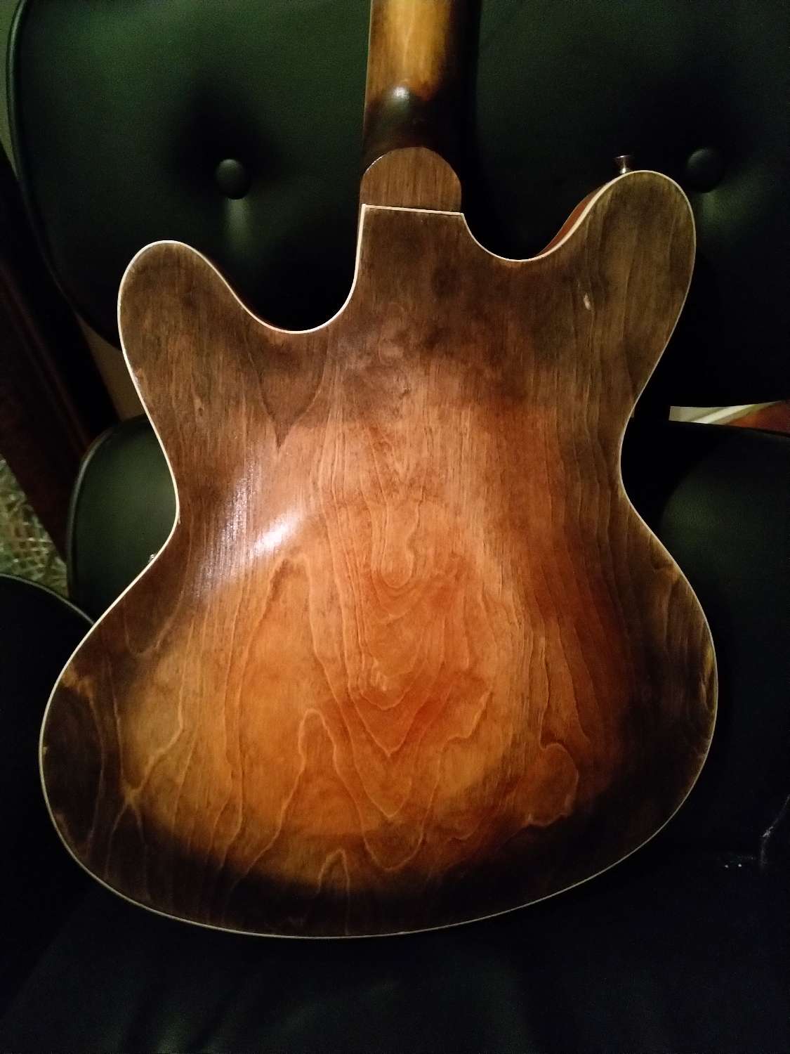

    Going for aged weathered look on back and sides.

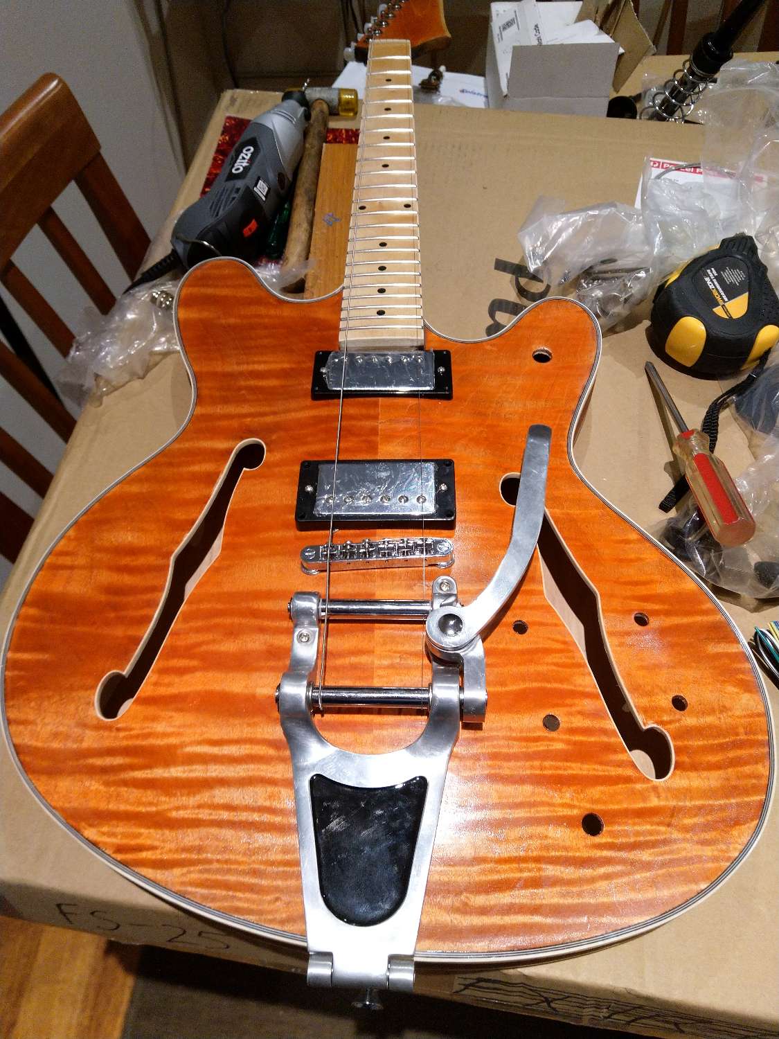

    Lining up the 'Bugsby'. So far relationship vibrato-bridge-neck seems OK...... Gotta make up a little wedge to suit offset body

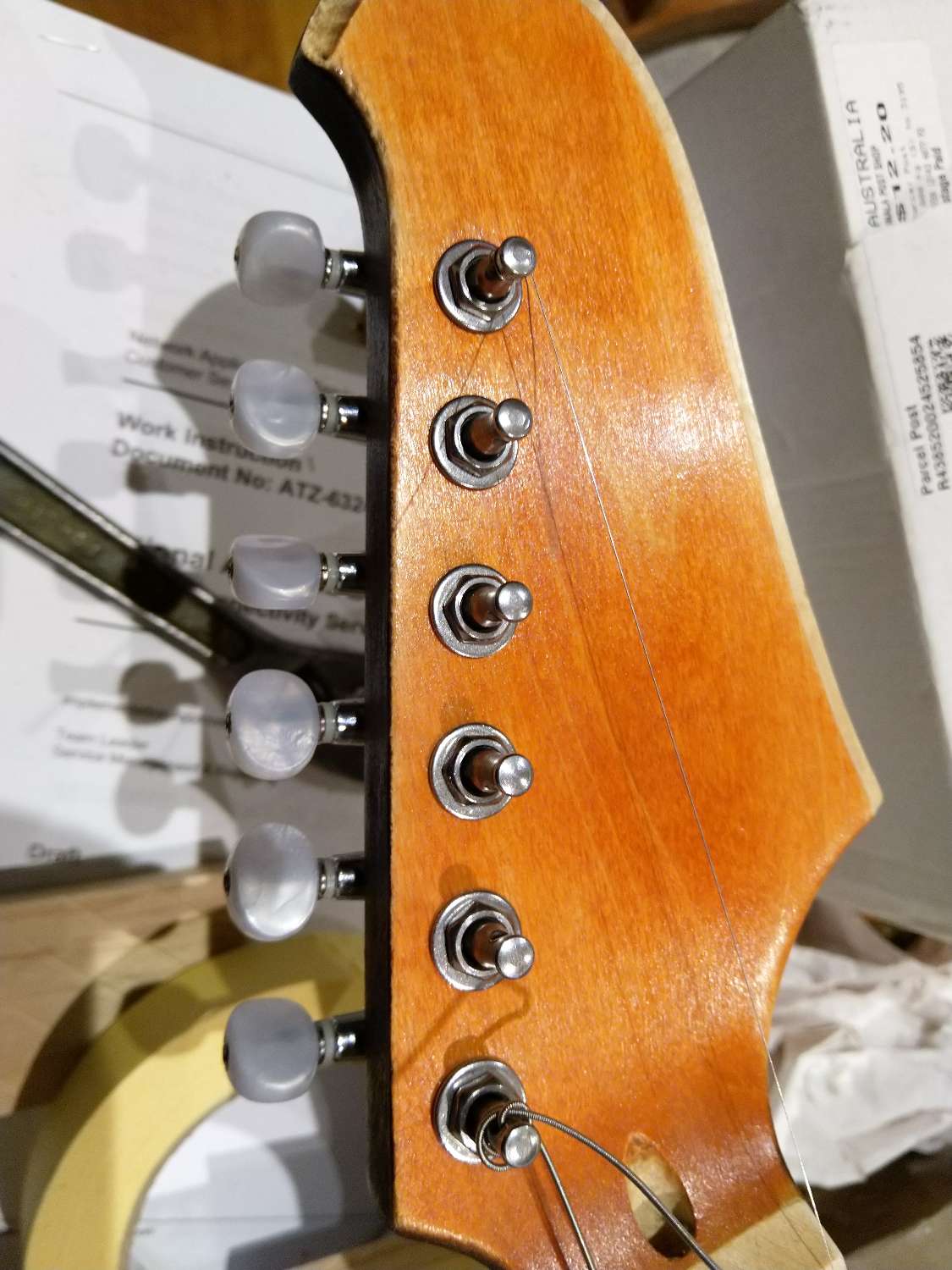

    Had these chintzy pearl buttons a while. This sorts suits the look I'm going for

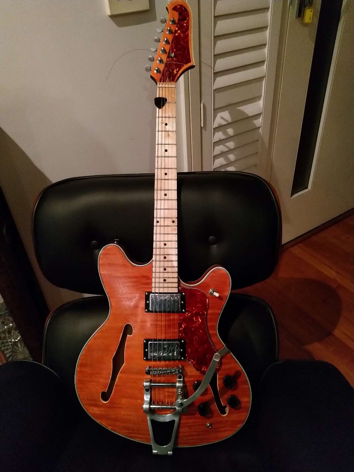

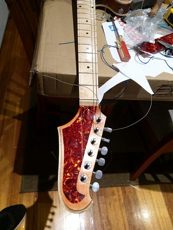

    Still waiting on pickups, and amber knobs and neck markers. Needs some action tweaking. But it's pretty sweet.

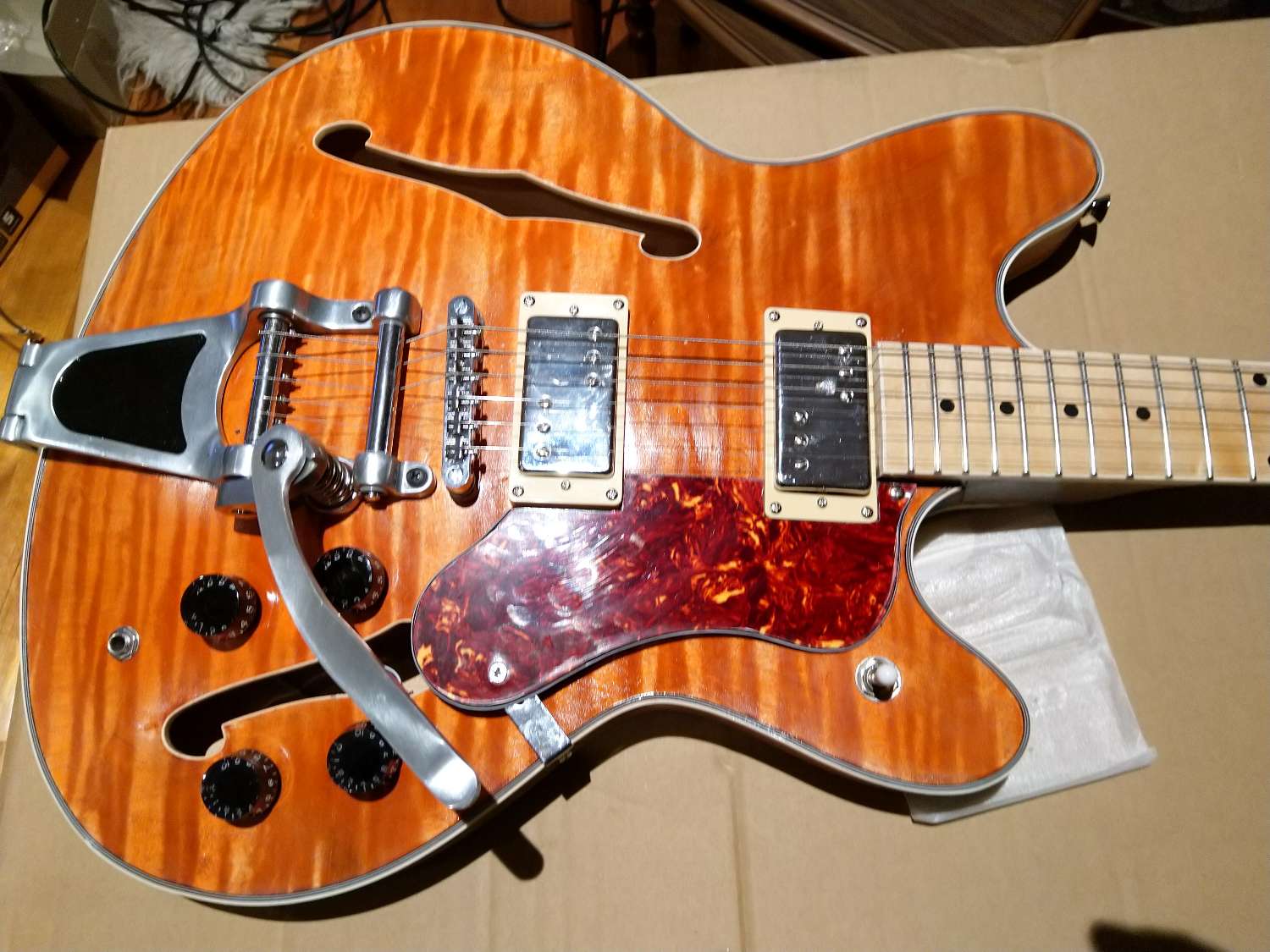

    Here's the WRHB knockoffs fitted. Not bad at all - they're getting FeCrCo magnets. Neck is 7.6 kohm DCr, the bridge 14.6k
    Just waiting on the amber knobs.
    Once I get that plus roller bridge, it'll get body buff, fret dress and polish.
