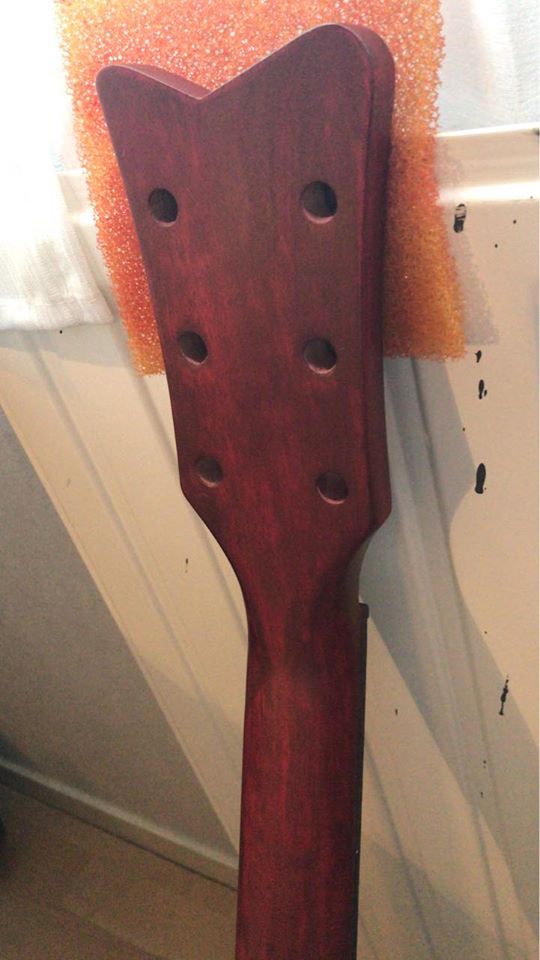

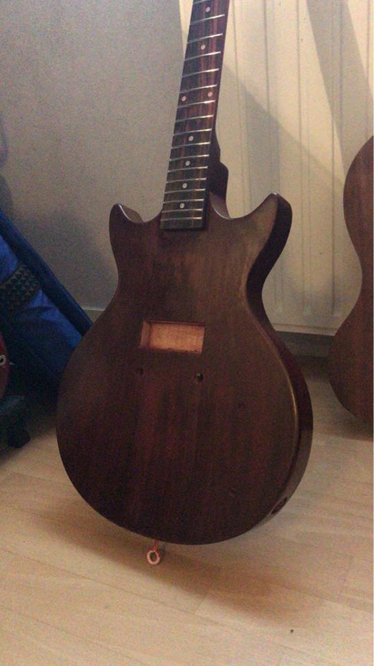

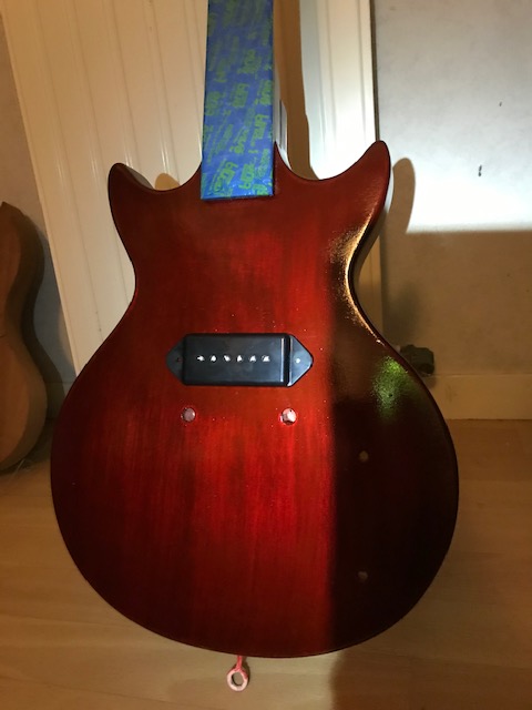

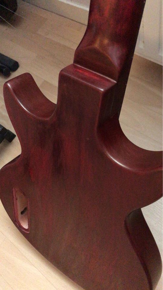

ID:	36393 grain filler red stain , light polish . I don't knom if im painting a "table" in pelham blue or varnishing like this?
    your toughts ?
    This is when you want to get the flat surfaces as flat as possible. If you can stick sandpaper to a long flat piece of wood with double-sided tape, then you'll quickly get an idea where any dips are in the wood as you'll still see them as shiny areas. You really need to sand until they are all gone. You may need to re do the grain filler, as it almost always needs more than one application. And don't use too coarse a grit paper on the grain filler, as that tends to pull out the filler from the pores, so use the finer stuff once you''re getting close to the wood surface, even if it takes a bit longer.
    As to the finish: colour or clear coat. I like the dark mahogany wood finish and have never been a fan of Pelham blue (or any metallic finish for that matter) on a guitar, so my own choice would be to just clear coat it.

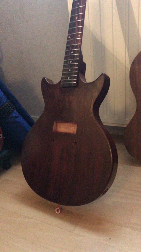

    after two "heavy" coats of nitro ... waiting time before sanding that F.... orange peel ! do you guys know how long should I wait ? witch technique and grit ?
    I'd put on about six coats before thinking about sanding back at all, otherwise you are very likely to sand through to the wood and damage the stain. A lot of those first two coats will have soaked into the wood. And it really is better to apply thinner coats than thicker ones.
    I normally wait at least two days before doing any sanding. Longer if you have any large drips to remove as the centre of those stay wet for quite a while. But after sanding back flat, unless you are going to spray more coats on, then its at least two weeks before you should think about polishing. If you can still smell solvent from the finish, then it's still not ready for polishing.
    I've just been experimenting using 00 wire wool to sand back nitro, and certainly to start things off, its a lot easier than wet sanding. It's a bit gentler and you can see what you are doing better. Works pretty quickly and the wire wool doesn't clog up when used dry like sandpaper does. The downside is that you get a lot of small metal fragments all over the finish that need to be removed before any more finish goes on or you start polishing. I remove them with a magnet and then a good wipe-down. You'd still need to do some wet sanding with finer grades of sandpaper before polishing, but I think you are far less likely to sand through when levelling and removing any orange peel.
